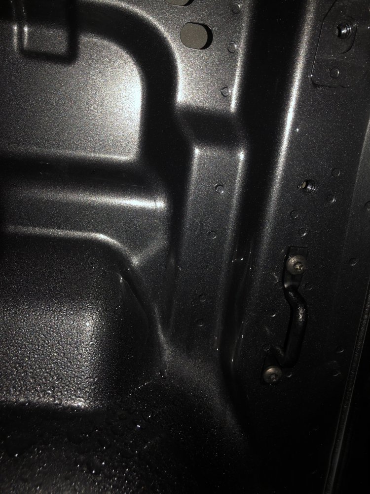

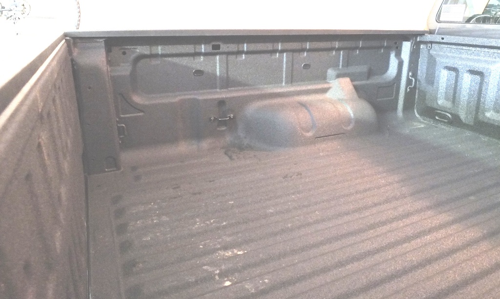

This is what I’m talking about. This is the drivers side by the cab. 9E9856C4-37EE-4F34-977D-3181474E38C7.jpeg
Those holes are pretty far apart for another tie down. Possibly for an accessory? The space between the tie down and the lower hole look like they are spaced close enough to rotate the tie down so it sits a little higher.
I was wondering the same thing.
The top hole, in the pic, was one used in the front hinge brackets, on my new Undercover Tonneau cover--the hinges not only clamp to the underside of the rail, but bolt into this hole, left and right sides, creating on of the best hinge systems I've seen.--

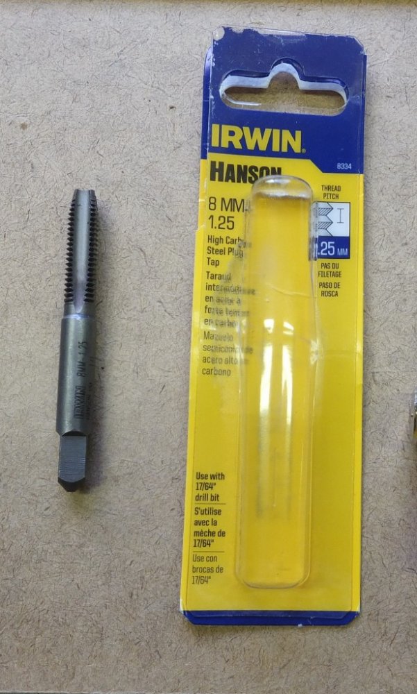

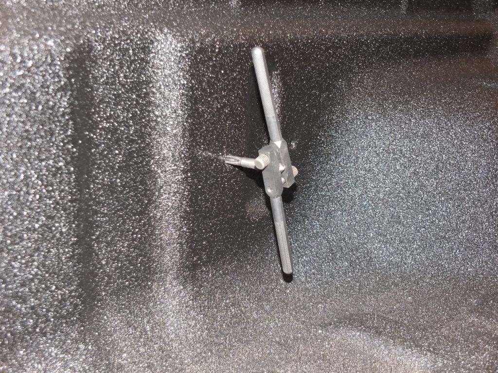

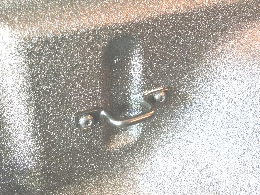

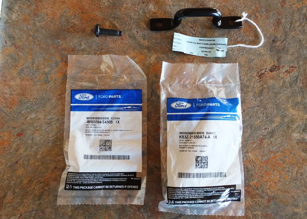

I installed them myself (cause I don't trust the dealer to do anything) and used a 8mm-1.25 tap to chase the tapped holes to remove the factory applied Ford ToughBed spray in liner from the holes. Also added a little never seize to the tapped holes.

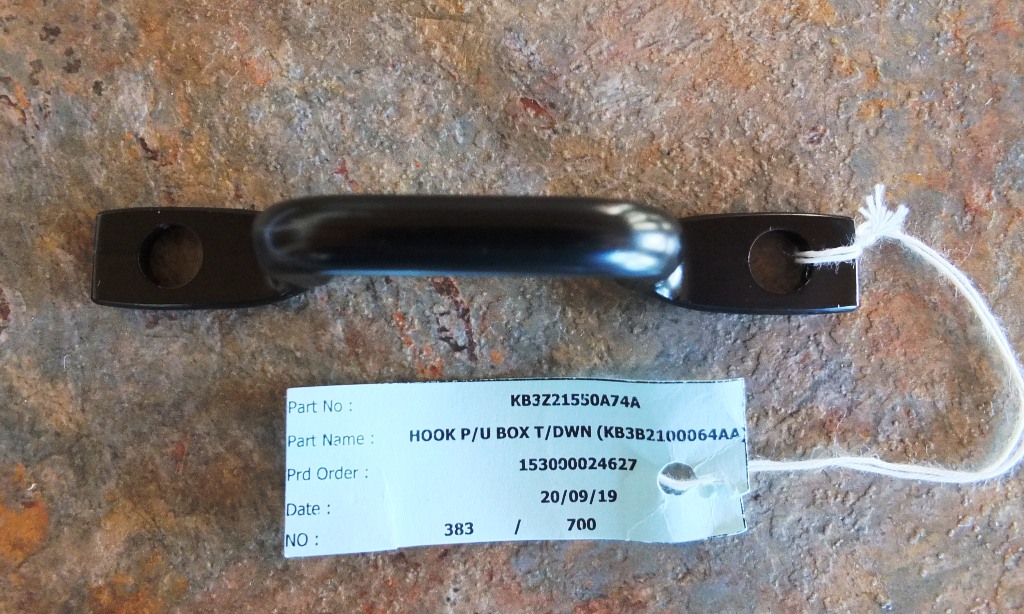

In case you need to do the same.. here's the P/N's of the parts.. and some photo's.
Tie Down Hook - Ford (KB3Z-21550A74-A) $6.49 ea, Quan. (2) = $12.98
Tie Down Hook Bolt - Ford (-W505594-S450B) $3.90 ea, Quan. (4) = $15.60

Over the counter price at the Ford Dealer, August 2019.
So to summarize..
Tie Down Hook - Ford (KB3Z-21550A74-A) $6.49 each Aug 2019, $32.51 Dec. 2020
Tie Down Hook Bolt - Ford (-W505594-S450B) $3.90 ea Aug 2019, $3.99 Dec. 2020
