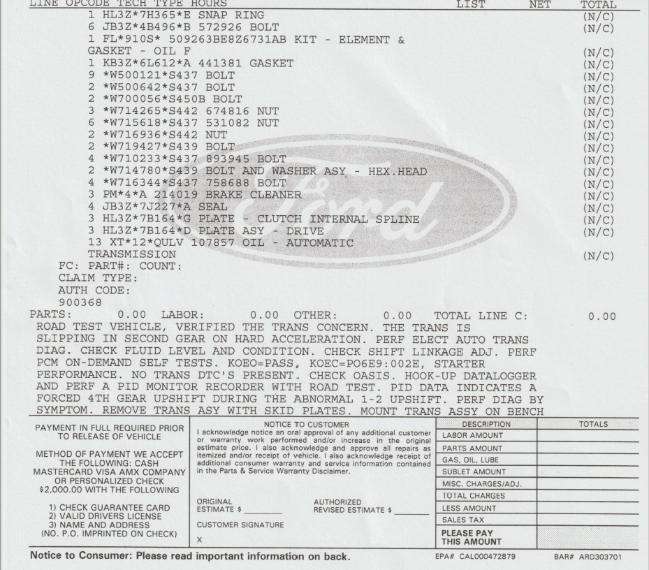

Hello everyone, Happy Friday-
I'll be brief, have a 2019 4x4 XLT SuperCrew w/ ~34K. Regular daily driver, work is about 5 miles a day. No mods really, Ford performance tune and an upgraded Fox suspension.
A few weeks ago started having challenges going from 1st to 2nd, super high whine then "clunk" into 2nd with a jolt. Took it to a local Ford shop, they had it for 2 weeks, said fixed, went down to pick it up, 30 seconds after leaving did same thing, obviously hadnt been road tested and was not fixed. Turned around, said a prayer to the good Lord to help me not lose my sh*t on them, they kept it for another 3 weeks, just got it back (luckily all warranty work).
Apparently new repairs made, I believe all they did last time was take some valves apart and clean them, this time around they actually got new parts and replaced them. Something about a new TSB blah blah blah.

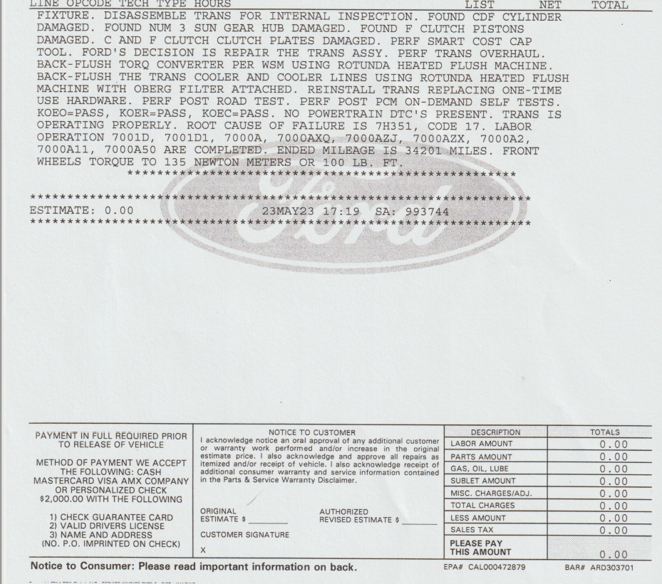

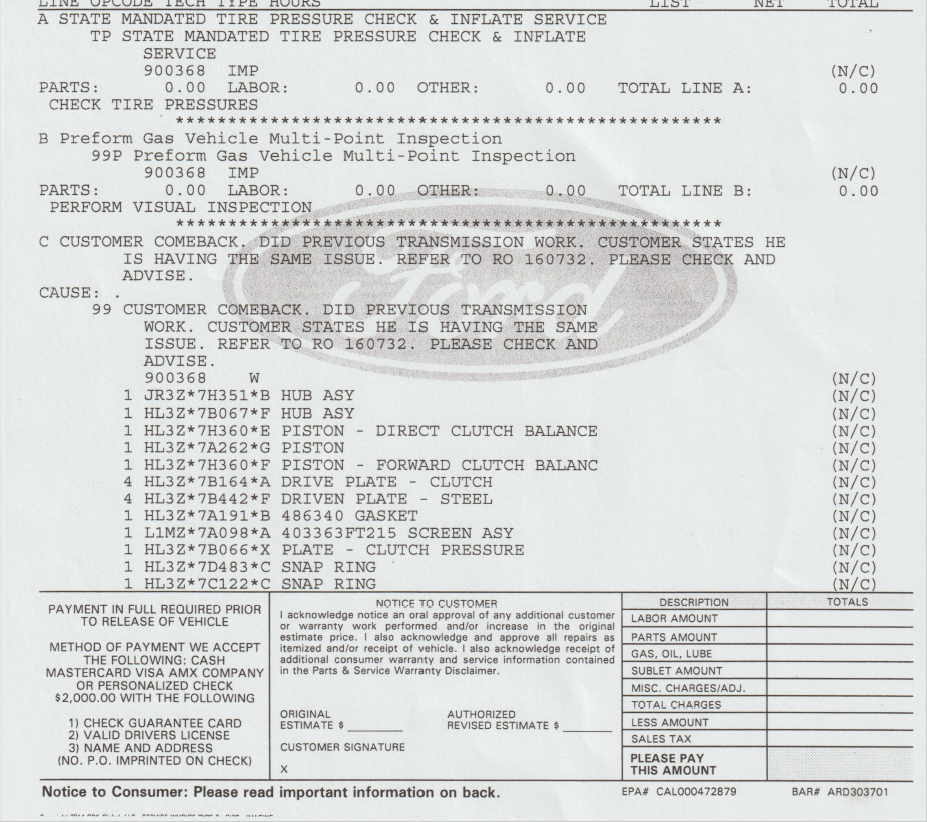

Anyway, I'm attaching the work order if anyone wants to check out what they did (sans my contact and truck info at the top). Key phrase on 3rd page "Root cause of failure is 7H350, Code 17", lots of 'found this damage, found that damage, found this damage' on 2nd page. Don't know if it will help anyone, but here ya' go.
Phoo
