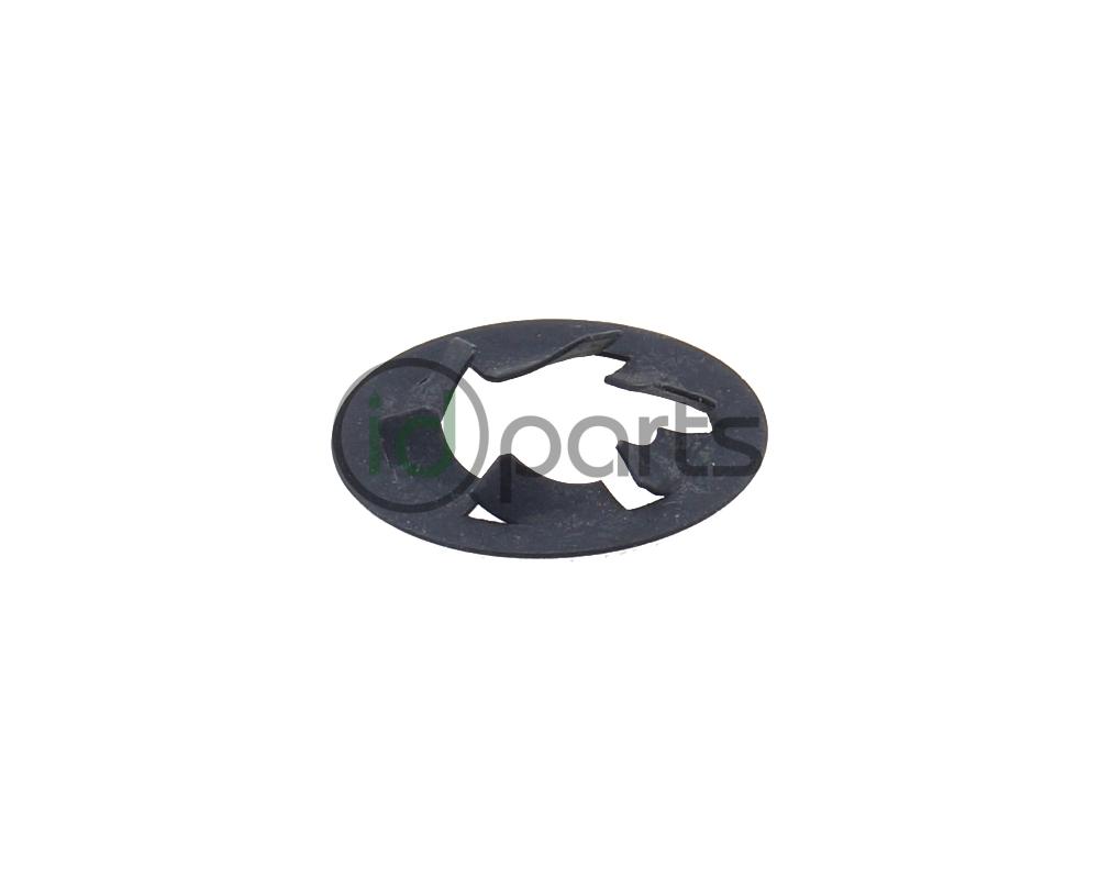

Sometimes they use "pushnuts" on a wheel stud or two to hold the rotor on the axle.
2014 F-150 rear rotor replacment
I just grab them with side cutters and twist them until they break to remove.
Aside from that... if you're replacing the rotors... get the bamiffy and a few solid blows and they surrender.

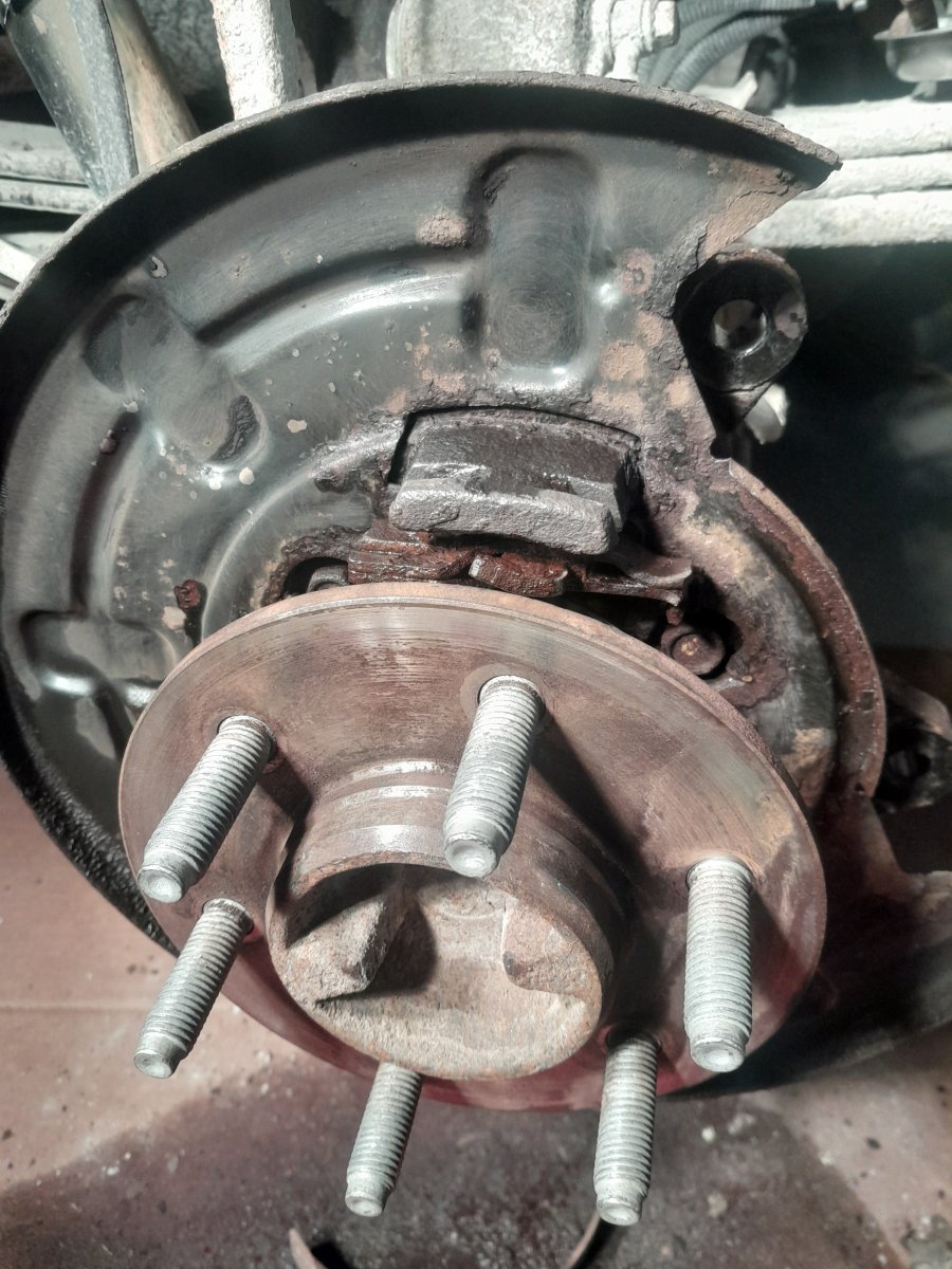

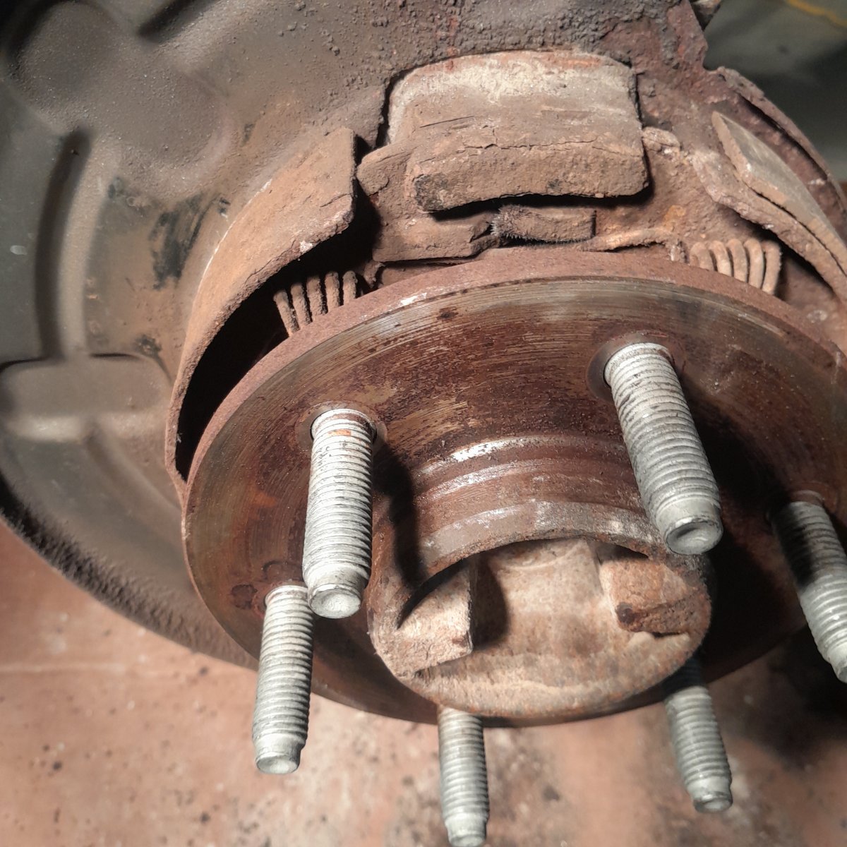

Got 'er done before August...what a job. Would've been easier if I knew what I was doing and if I had fingers the size of forceps. The retaining clips that came with the hardware kit were near impossible to to put on.
The driver side rear parking brake was shot as was the rotor. The right side wasn't nearly as bad.
2014 F-150 rear rotor replacment 2014 F-150 rear rotor replacment
Driver's side
