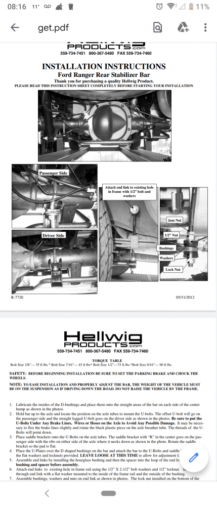

Hit a weird snag when looking for a rear sway bar for the 2011.
Depending on who's catalog/site you look at, there's two different hellwig bars listed for the 2011 model, Hellwig 7511 and 7720.
Anyone know the difference? Concerned that one of them is designed for a lower riding truck vs. the other. Planning on replacing shorty factory lift blocks with pre-2008 ones and lifting with a shackle, so want to pick whichever of the two allows for more lift.

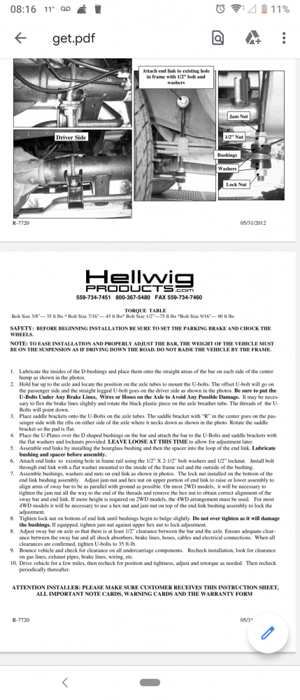

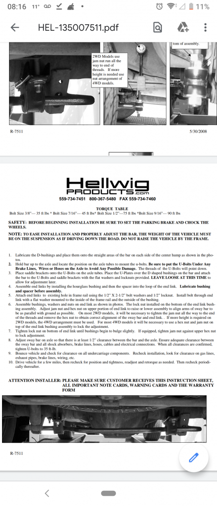

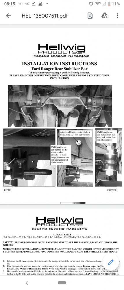

Both are listed as 7/8, but I can't tell which one has longer links ?
7511 manual:
2011 Rear Sway Bar Options
7720 manual:
What's weird to me is the 7720 bar is listed as "2011 Ranger V8" ?
Well... hellwig must know something we dont.
