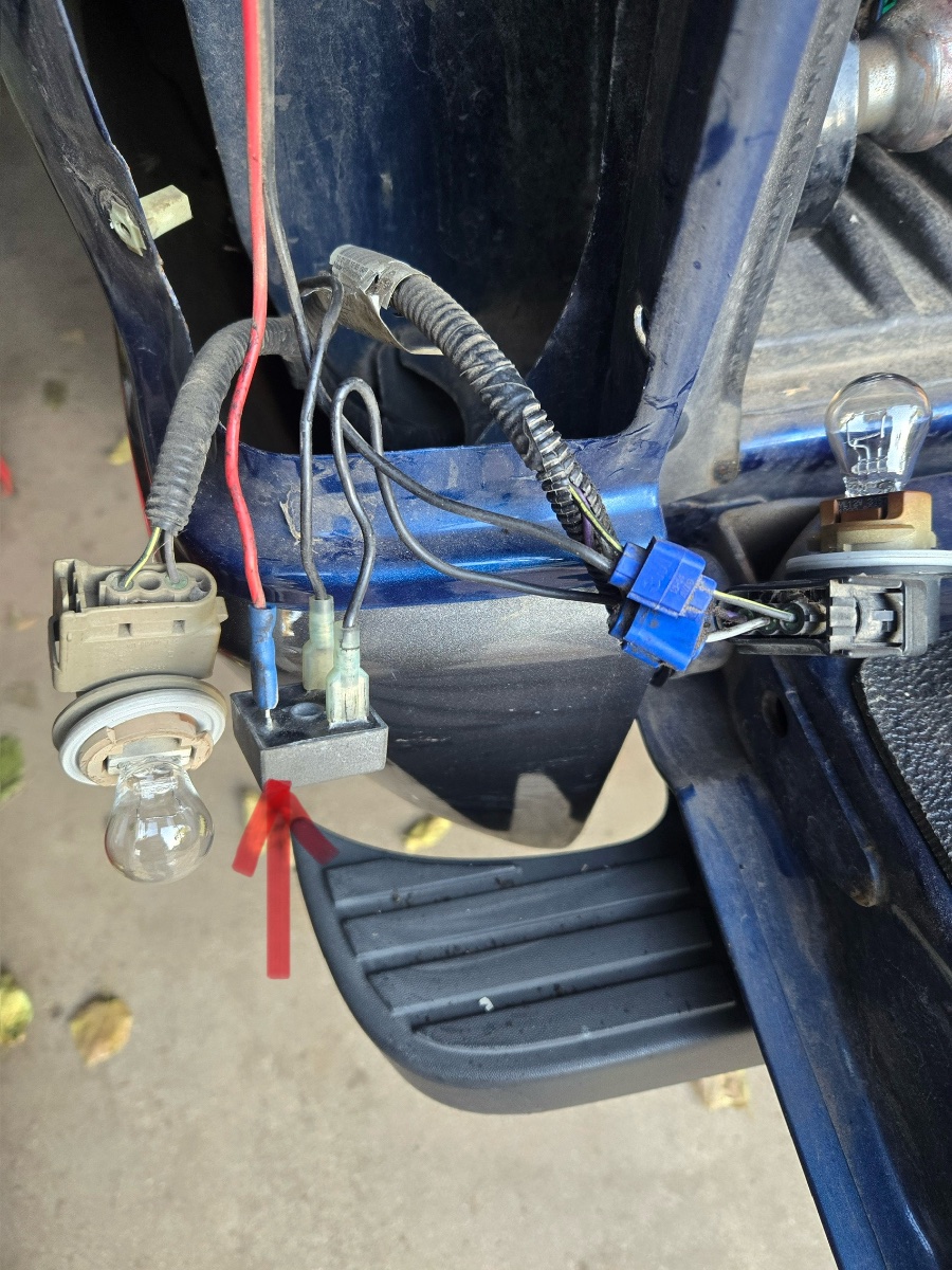

Working through some bugs in my 2008 Fx4. Ranch Echo topper was installed in 2012, and the photo shows how the 3rd brake light was wired into the tail light assembly at the dealer. Trying to figure out why my 3rd brake light quit working. I measured 12 volts to the main brake lamp, but only 3 volts to the 3rd brake light plug. The 3rd light worked with 12 volts on the work bench.
Does anybody know what the module is that the red arrow points to? I only read 3 volts at the lug the red wire connects to. The red/black pair go to the 3rd light.

It a lamp module...
It sorts out the left and right commands and only illuminates the third brake light when brakes a applied. It's necessary because your brake and turn bulbs operate on the same circuits.
It a lamp module...
It sorts out the left and right commands and only illuminates the third brake light when brakes an applied. It's necessary because your brake and turn bulbs operate on the same circuits.
Aaahh. Thanks! Got any idea why I only have 3 volts on the red wire lug?

I would first look at the scotch locks on the wire. Those corrode... and create resistance. If all good... it likely the module.
monitor it while the lights are working.
possible a bad ground creating a voltage divider circuit.
getting power to a device also requires getting that power back to ground.
it looks like a rectifier because that's basically what it is.
keeps one side of the turn signal from back feeding the other side.
edit: there is some circuitry in it to prevent the 3rd light from flashing with the turn signals.
Those diodes used in rectifiers are a pretty hardy breed, so I lean towards a bad ground dropping the volts. Unfortunately, the tech that installed this didn’t leave much wire to work with on the back of the lamp socket. I’ll most likely have to splice some wire in and create solder joints where the suitcase splices are and cover it all up good with heat shrink.
I second that. There is no protection from the elements. I would replace those first. At least with butt connectors and heat shrink around them. Solder and heat shrink is even better.
Once you get everything to where it appears to be working, check the function of the logic box. The only time the third brake light sould come on, other than when applying the brakes, is when the hazard/four way flashers is on. The third brake light will flash with the hazards.

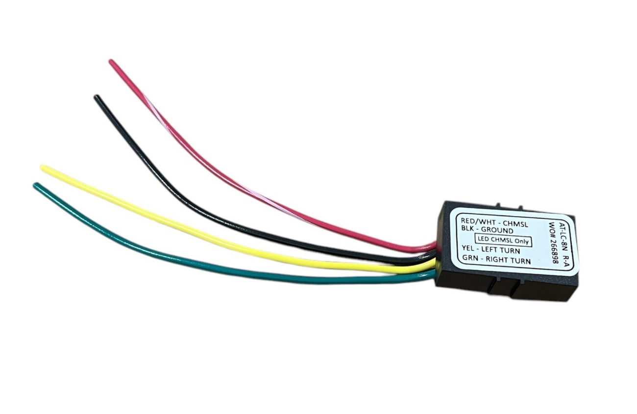

After much research online, I was able to identify the logic module as an American Technology Compnents p/n AT-LC-4. Traced all the problems I was having back to the module. Discovered they have a newer, smaller model p/n AT-LC-8N that does the same thing except with 4 connections rather than 3. Plan to “breadboard” the hookup with test leads tomorrow. Results to follow.
The AT-LC-8N logic module works. All light functions work as they should. Used my trusty Plustool crimper and bullet connectors like those used on motorcycles to connect to the logic module. I hit each crimp with a bit of solder to keep the wires from pulling out, just in case. Also covered all joints and connections with heat shrink.
