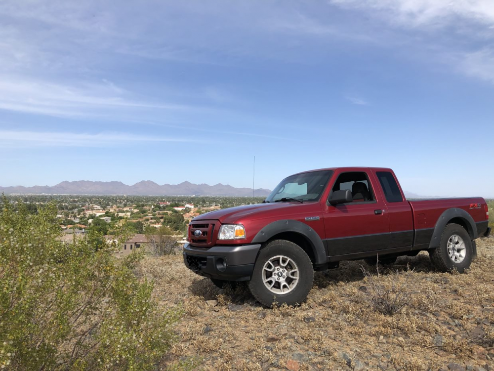

I've been a lurker on here for some time so thanks for all the help in the past. Right now, I've put 265/75r16's on my 2008 FX4, they were a little big in the front so I cranked the stock torsion keys to get 1" in lift?
