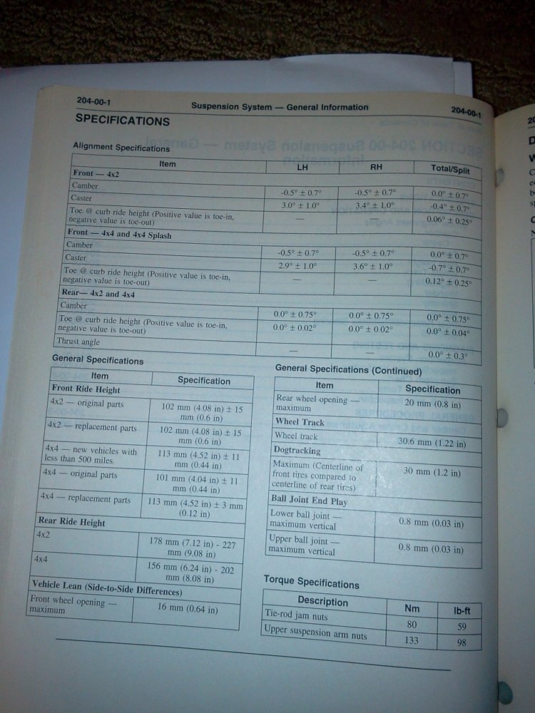

does anyone have the camber and caster factory specs for a 2006 Ford Ranger 2wd with coil suspension

this is why I am looking for the original specs
Can you scan the printout and post it?

still would like to see the ford specs if possible
this is a 2005 book, should be the same for 2006.
52198
