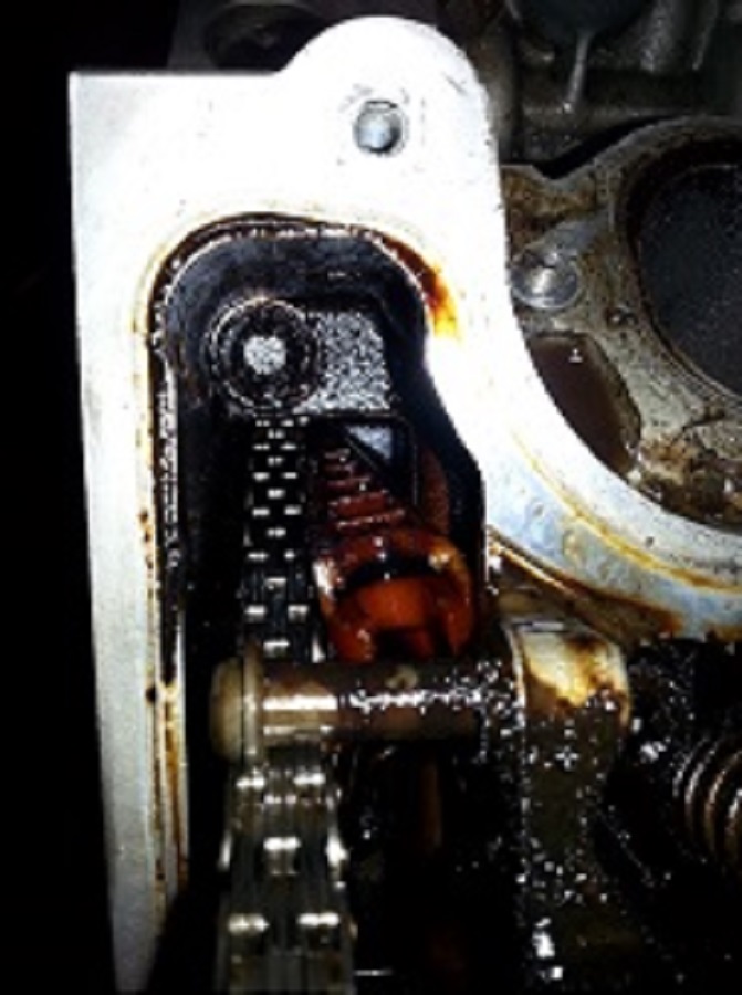

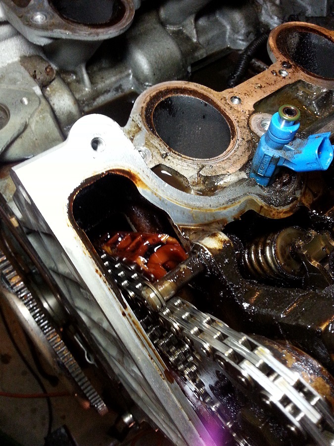

It looks like you had at least both timing chain tensioners fail. No compression both sides means both timing chains have jumped and $$$$. These engines will run fine and just quit like what happened to the OP's engine. At this point, it's probably cheaper to replace the long block than to rebuild. A lot of specialized tools and training is needed to rebuild one of these SOHC motors. You can rebuild, if you have the time and money. Pull the upper section of the front timing cover and look inside and you may find the guides have broken.

eneded up being the timing chain tentioner failed. First couple pics are of my old engine, and the others are the new and what it should look like. I just put the first mile on the new engine, cant believe the difference. Thanks for the help, hopefully someone else can learn from this thread. This was the first engine I have changed, and I was amazed at how simple it was, as long as you have time to do it. I have a motorcycle that allowed me to get to work and stuff without having my truck. Its well worth the savings to do it yourself.
I couldn't get a picture of the plastic that was laying in the bottom of the engine, I never could have got it clean. I feel with the mileage it was the right choice. $2500 sure beats a new truck payment.
