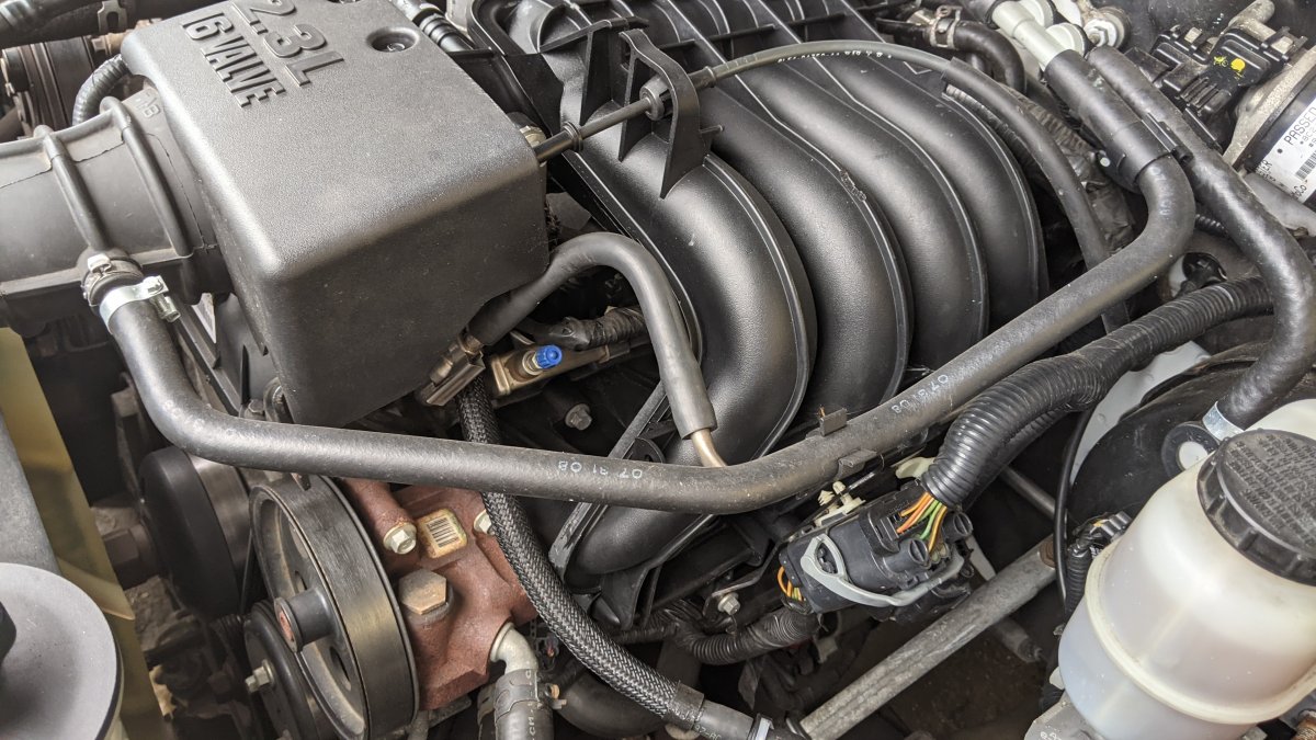

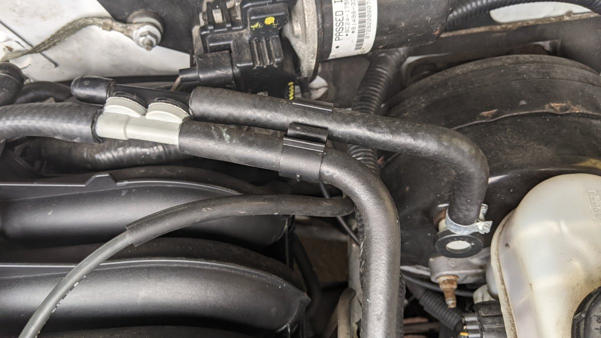

Oh forgot to mention the brake booster is not hooked up right either now. The 2.3 makes almost no vacuum while at highway speeds so there is a valve and port to the intake tube that allows it to switch over from behind the throttle body vacuum at low engine load, to before the throttle body vacuum at high engine load.
With that setup the booster can run out of vacuum if you brake hard on the highway....
This is the secondary pre-throttle plate line.... As you can see it runs up to the valve to the left of the booster that splits the two vacuum sources.

This is required for proper power brake operation on this engine...
