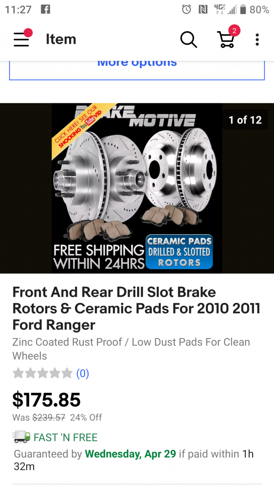

40747
This is what I ended up with. BrakeMotive is the brand. Like I said before, they are easily the most aggressive brakes I've ever driven. First couple days after install I was putting myself into the steering wheel every time I went to slow down. I've since taken a couple trips up through the mountains (2-3000ft elevation) and havnt experienced any fade. Nor have I experienced any noise like roar sgtsandman described.
They are obviously on the "cheap" side of things compared to all the companys with million dollar marketing teams like stoptech and the like..but the parts felt good in hand, and so far perform great.
The question with the off brand stuff is always how long the part will last compared to the name brand aftermarkets or even a Napa replacement.. But I'm sure they'll be fine.
I've put off brand brakes on multiple vehicles over the years and I've never been dissatisfied with service life. I have been dissatisfied with how long the more expensive Napa pads last though..
