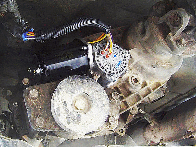

Likely 4x4ShiftMotor is getting weak\failing. These are barely big enough to do job when new.
Need to briefly excercise every month 2WHi~4WHi~4WLo & back, to insure they don't get stoved up & will operate when needed.
Test Procedure:
* Park were you can crawl under DriversDoor
* Set EBrake, Chock Wheels, Raise+JackStand as needed for access & make safe
* Remove 4x4ShiftMotor from TCase, 4 Bolts, Leave WiringHarness connected
* Have a Wife\Friend in DriversSeat, Engine Idling, Foot On Brake, Trans in Neutral, Switch Dash Control slowly thru 2WHi~4WHi~4WLo & back.
* Watch ShiftMotor drive stem
If ShiftMotor rotates proper, likely have a weak\failing ShiftMotor.
If ShiftMotor does NOT rotate proper, likely have a failed 4x4ConMod, behind right passenger KickPanel.

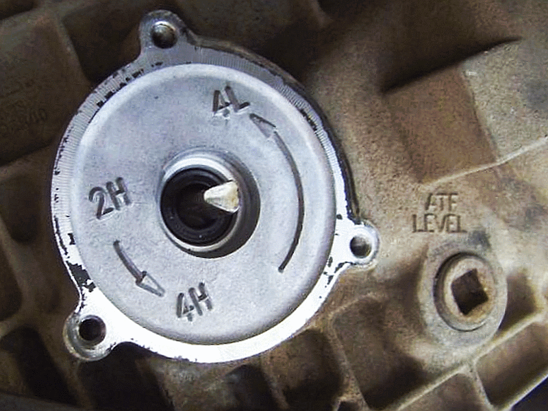

Motor stop positions can be adjusted slightly; note 3 slotted screws on backside of ShiftMotor RotaryLimitSwitch.
Click here for more info & part numbers for this 4x4ShiftMotor+ConMod.
