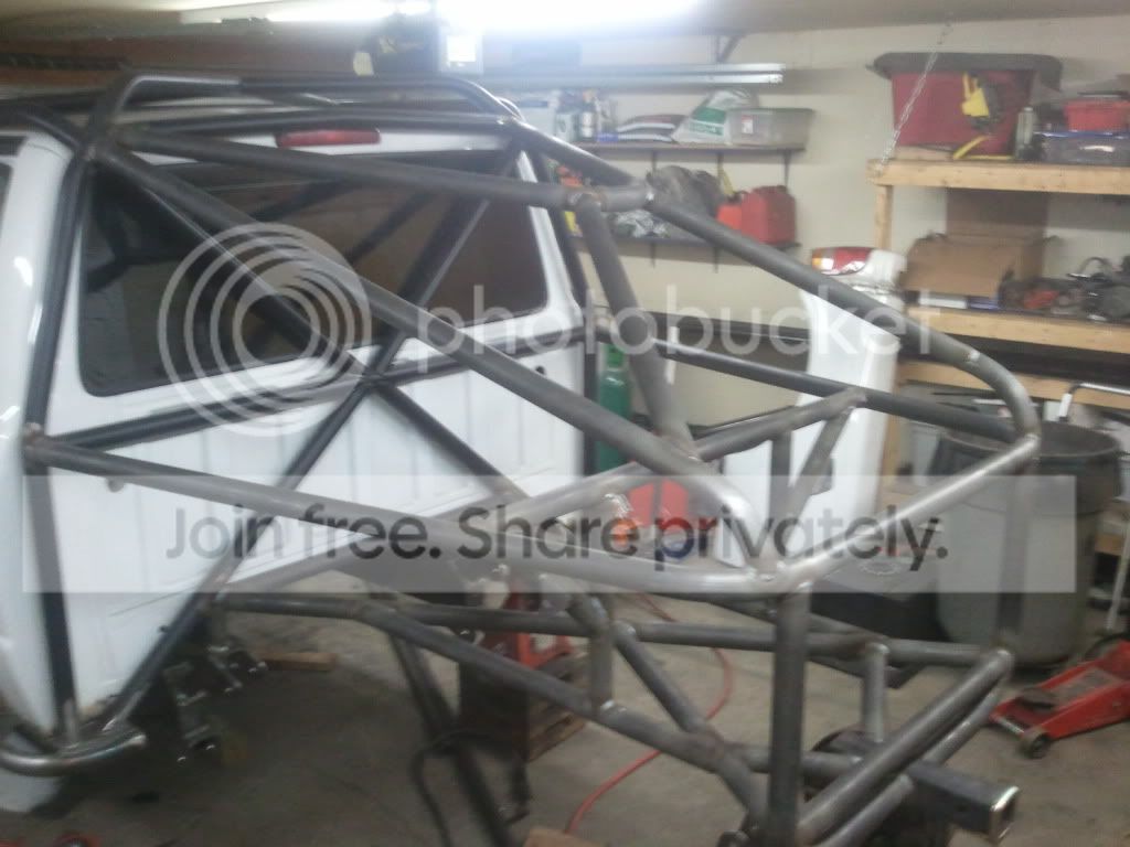

I think the wheelbase is going to be around 110 or so. I guess we will see where the rear boxsides want the rear wheels to be.
Its getting their.... We took some time to do some other things around the shop. Stupid jeeps!!!!:icon_cheers:
2001 Fullsize Ranger
We moved the front axle foward 10 inches.
More pics to come SOON!!! Stay tuned.

After moving the front axle foward 10 inches the wheelbase is set at 120 or so. It will be a climing mofo... More pics to come soon.

OK so maybe I should put up some of the specs. It started out life as a 78 fullsize bronco. Endend up cutting the frame in half. Put a 01 ranger body on.
-The wheelbase is around "120"
-78 kingpin dana 60 up front.
-78 chevy 14 bolt rear
-Ford 400m motor (still working on efi for it)
-c6 auto tranny into a twin sticked 205
-4 link rear with "16" travel fox coilovers
-James duff arms up front with deaver coils
and so on.........
