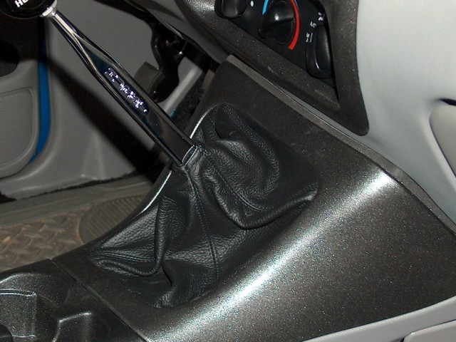

Here's a decent idea of what they are like with a stick:
