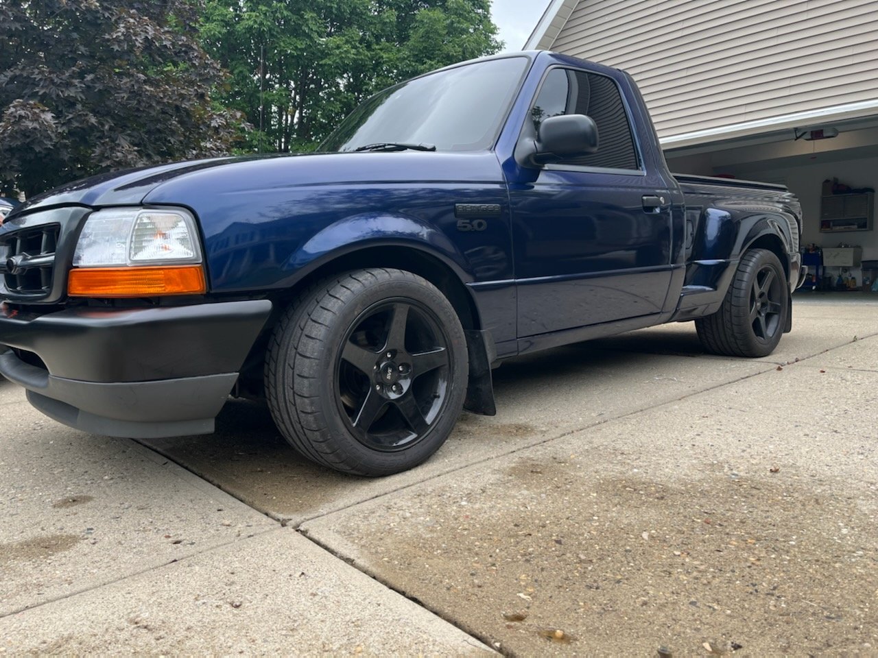

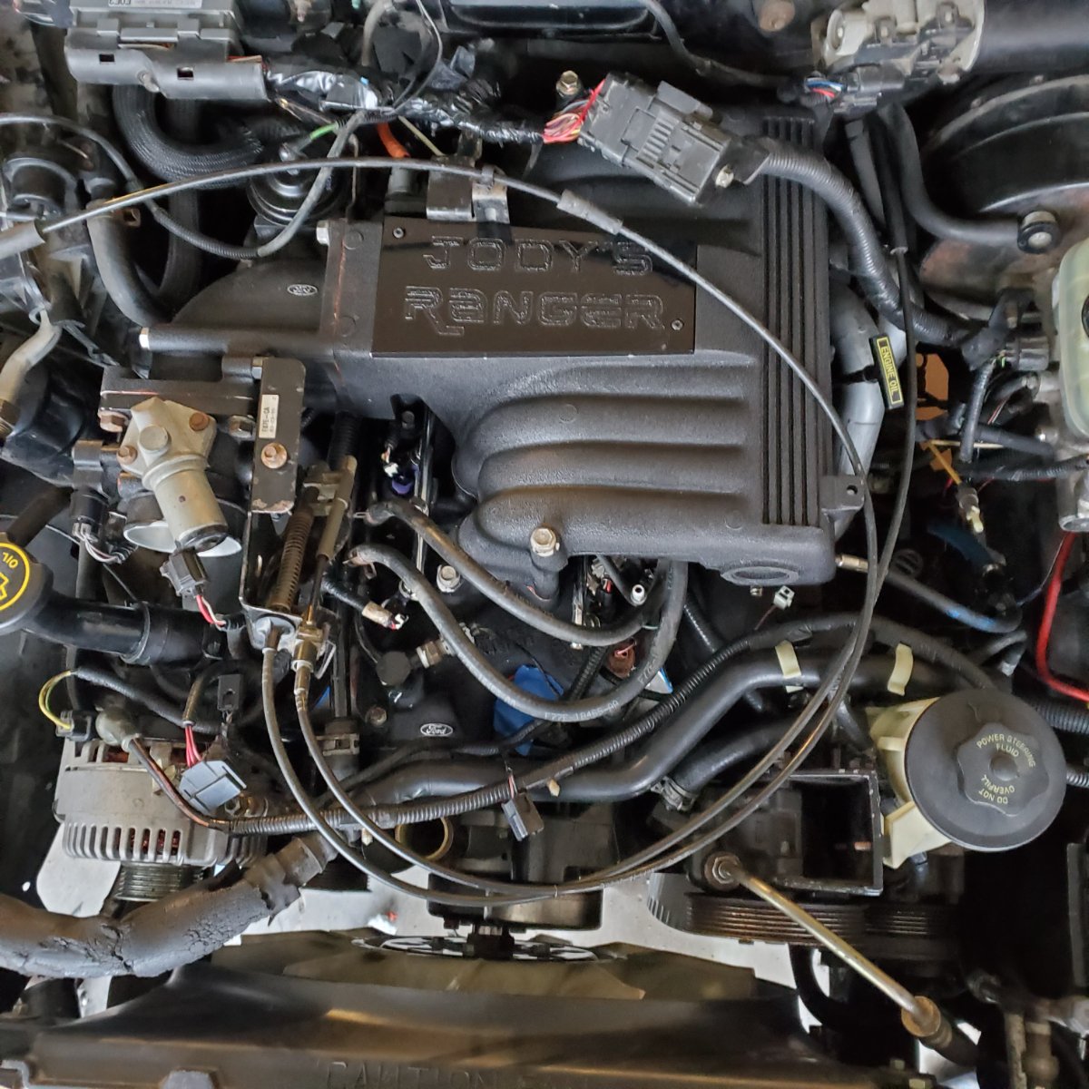

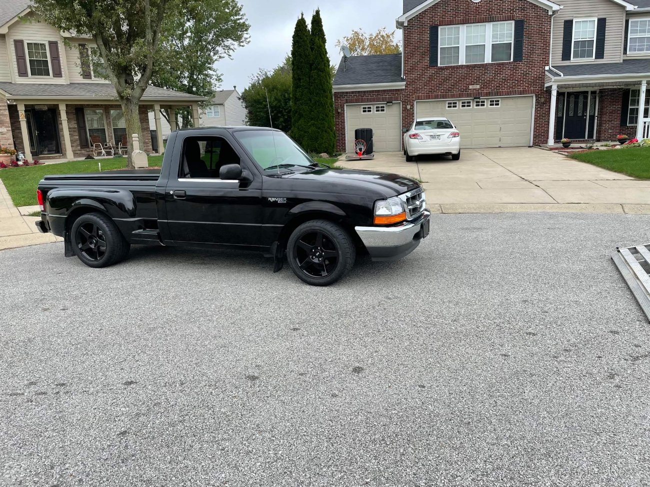

I see a lot of new people here since I completed this swap.. it turned out perfect so.Im building another one . Built to be a daily driver. All.power options and ice cold ac! It was dyno tuned 325/335 to the tire.

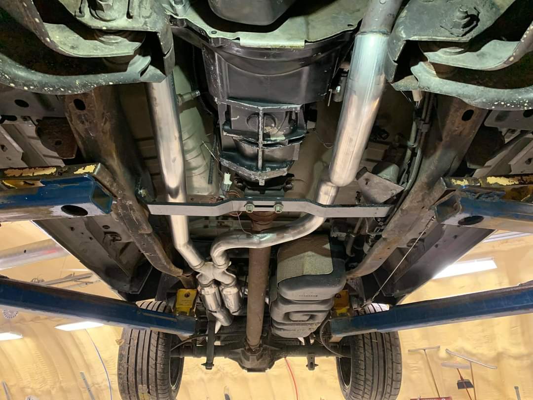

Ported and milled twisted wedge heads, ported upper and lower explorer intake, ported throttle body, 30 lb injectors, lighting mass air meter, Anderson Ford cam, 1.6 roller rockers, Torque monster headers that were worked over to improve cfm(they flowed more cfm than 1 5/8 shorty foxbody headers!) Zspec t5 transmision mounted using Rick's Rangers crossmember
2/4 drop, cobra reps 17x10.5 and 17x9 wheels

Nice build.
What ^ said...

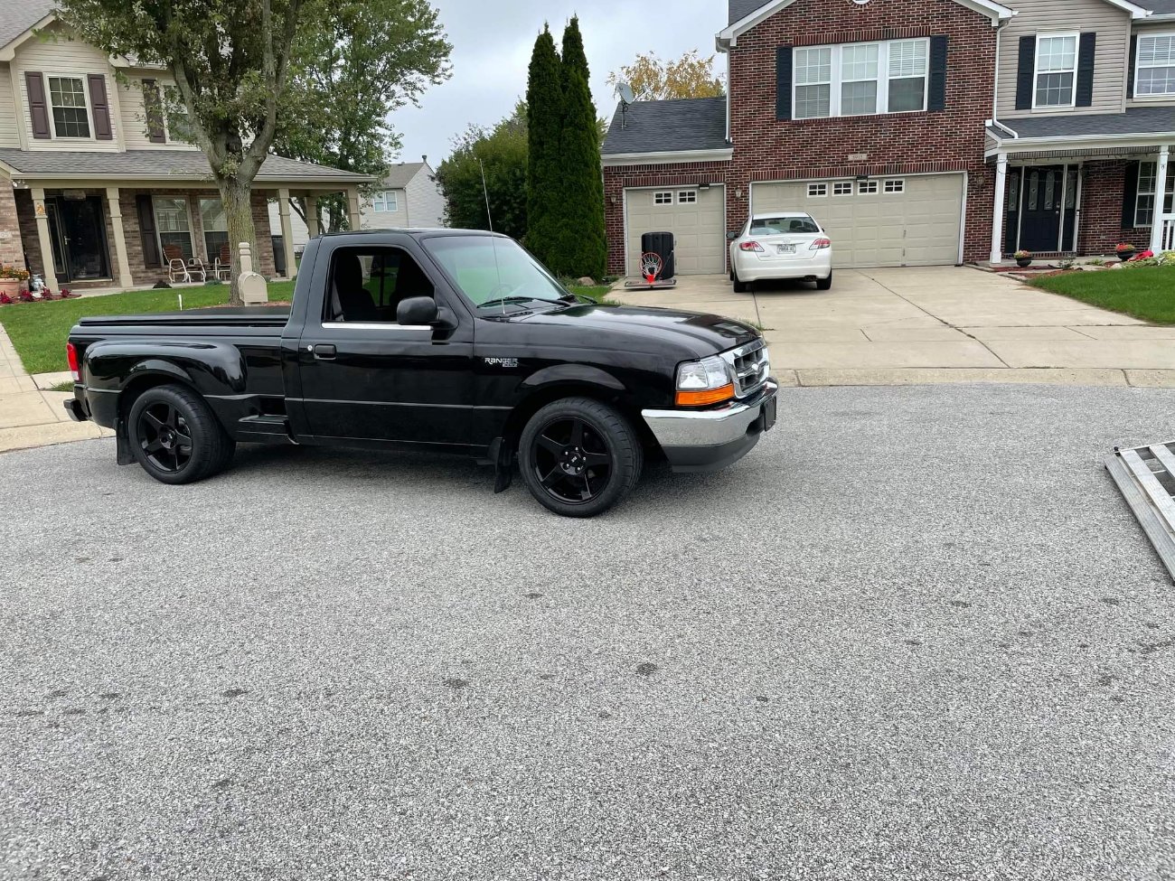

But I am confused: Blue or Black. Or is the Black one the next in line?
What ^ said...
It was black.. then got wrapped in blue
What ^ said...
It was the factory black paint.. then got "wrapped" in blue
