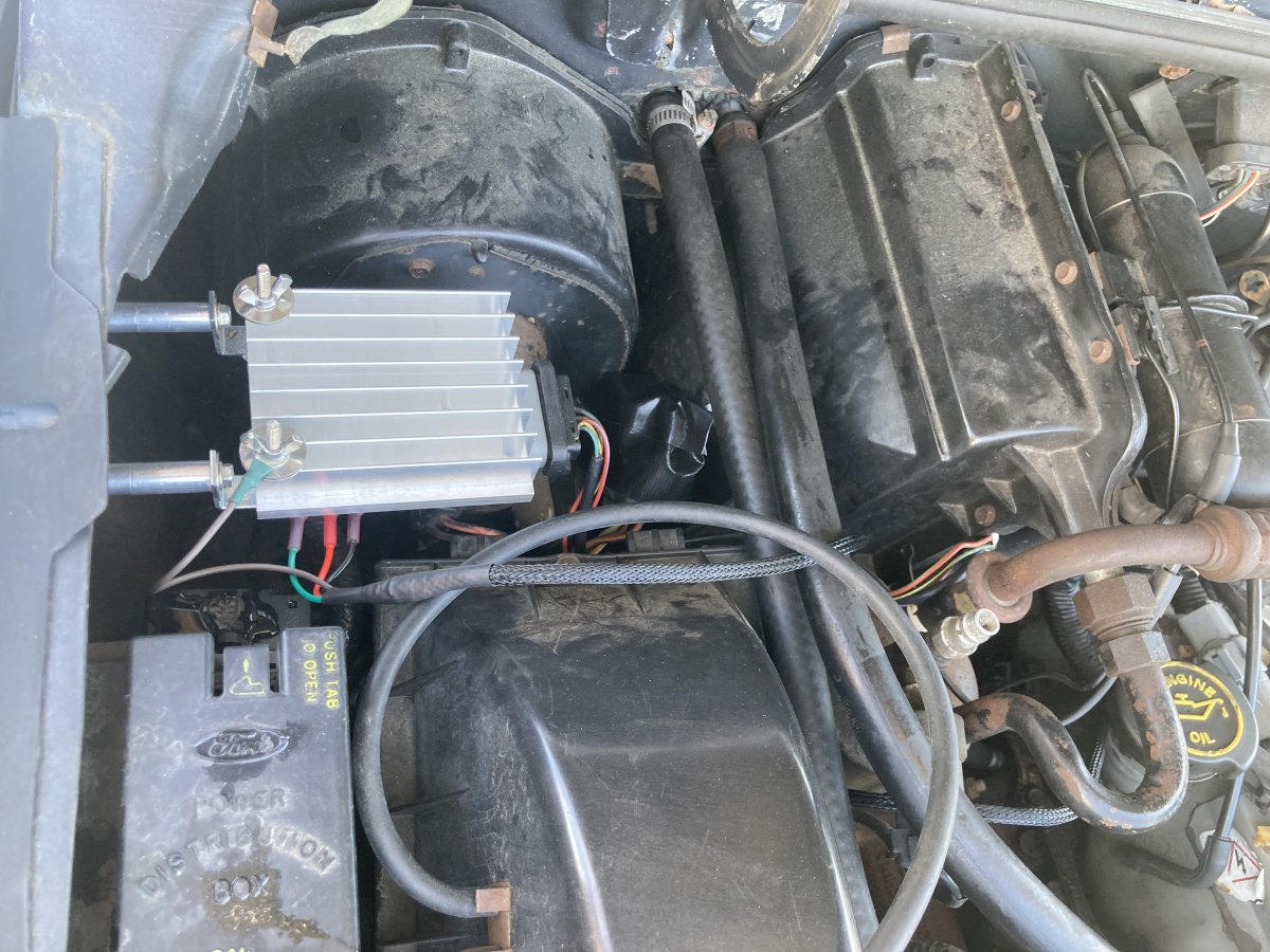

Posting an update here since i finally took the final step of relocating the TFI. Was a bit elaborate to plan it out, but I’m posting the results here just in case it helps someone else out.
It’s the McCully Racing Motors MK2 kit, not the MK3. Didn’t want to pay 200 ish, just 90. I took my old (actually only six months old at this point) TFI and gutted it to use as a dummy TFI as a proper connection. This is as opposed to using three exposed prongs loosely attached to back of distributor. The Mk3 kit includes this dummy TFI. But making your own just involves drilling a large enough hole in plastic of old one to fit the 3 wires of new harness, and destroying the 3 PCB leads and taking over those main connections to distributor.
The real fun was figuring out a way to get the original harness to extend somewhere far enough. I figured out that if you (non destructively) snip some of the bulk straps that hold other groups of wiring harnesses, you can dig out the multi pin hardness and wrap it over towards the passenger sidewall. It gets you close enough that you can then mount the TFI sink in the way as pictured below, and have enough slack to comfortably connect it. Important note: this does NOT involve destroying any of the shielded grouped wires. It’s just a matter of freeing up all necessary groups to be brought further away.
I’ve driven a few hundred miles like this and it has made a great improvement. Previously, once I put in a new TFI it would be excellent, then after a solid long drive jt would cook and upon startup after that the truck never felt fresh/smart again. So the TFI was always half broken. That has gone away and the truck timing feels good every time. I feel comfortable hopping on the highway, as opposed to before where I’d bog down to 35mph if the engine was “too warmed up.” I still have some uphill power issues on long steep hills, but I think this relates to more than just TFI.
The mounting looks a little sketchy but it’s pretty solid. Hasn’t budged. The sink is lightweight and so is the TFI under it.
Another point is to make sure your grounding choice is actually measuring out to like zero ohms to the rest of ground. With a rusty painted truck, it’s easy to not end up actually grounding things.
