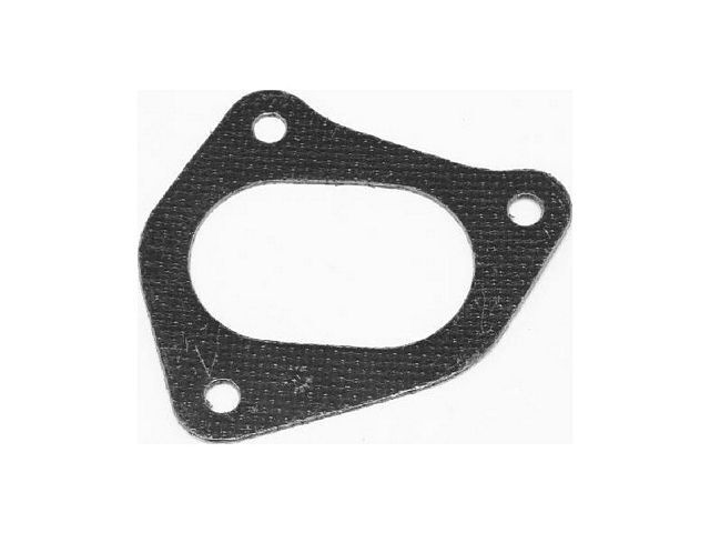

Do 4.0 and 2.9 have same flange on their y pipe? I'm trying to figure out the exhaust on my 4.0 Bronco II. Will bronco ii exhaust bolt up to a 4.0 y pipe?
If your Y pipes both use this style of gasket, then yes, it should.

In 1988 Ford changed the 2.9l collector pipe from a dual circular outlet "H", to a 2-1 oval outlet "Y". You can use the 2.9l "H" with your 4.0l, this permits using the stock exhaust.
If you are trying to use the 4.0l's 2-1 oval outlet, it will not bolt onto the BII's stock exhaust without some modification.

The exhaust from a 88+ 2.9l (Y style), will bolt right onto an OHV 4.0l Y-pipe.
