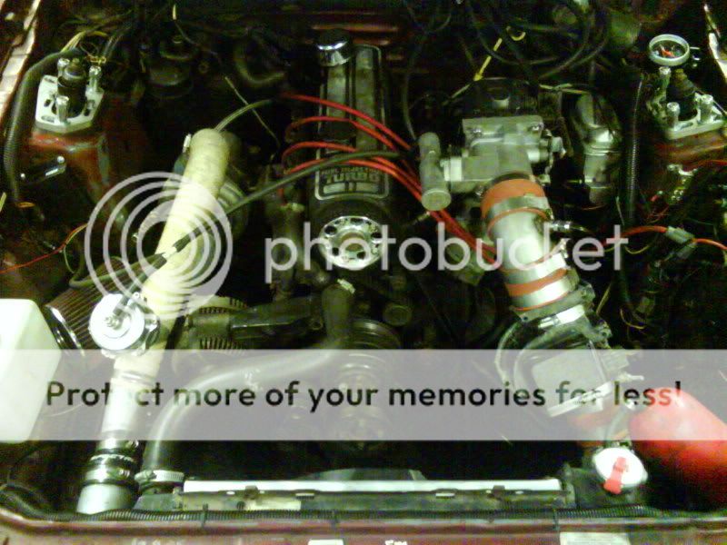

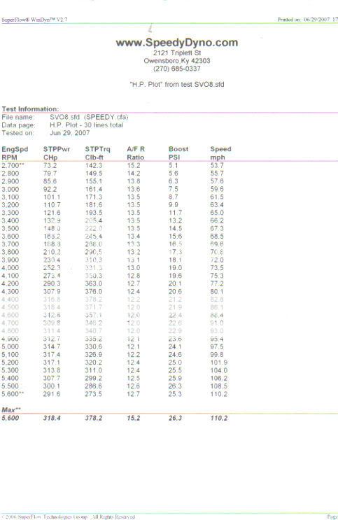

please do. my 85% stock 2.3T laid down 320hp and 380 TRQ...all for around $4-500.

have you got a dyno sheet and a list of mods? because frankly, that's incredible and i'd love to see it.

no graph but i have a sheet.
there are several hundred 2.3T's running around the states with over 5-600 HP, and i dont believe ive ever heard of a 2.9 making over 250. there just isnt the aftermarket support for parts unless you drop $10K into a longblock and then you still have no idea how tough the block is.

and slo vo, i have a graph very similar to that one, just has a bit more on the bottom end, in a 86 lebaron convertible at 20 pnds
