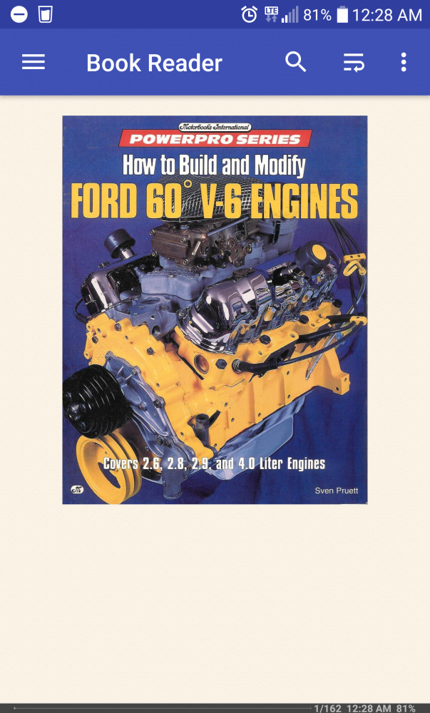

I know this is OLDER post/thread but Im planning on doing a rebuild on my 2.8 soon. Could you PM me on a guide or book I should get/follow on the process? Ive never rebuild a engine but I have on small engines. Any help would be appreciated!
I have that already, The only thing that made me ask the question was because I heard on other forums that it wasnt as much of a guide on how to rebuild the engine....Im only going off of what others have said. Trying to do the most research and get the most amount of INFO I can before undertaking this project.

For anyone that doesn't know, we have the .pdf version of 'How To Build And Modify Ford V6 Engines' here:

I do have the PDF, Im confident that I can do it. Hopefully I can save up enough money for everything!
