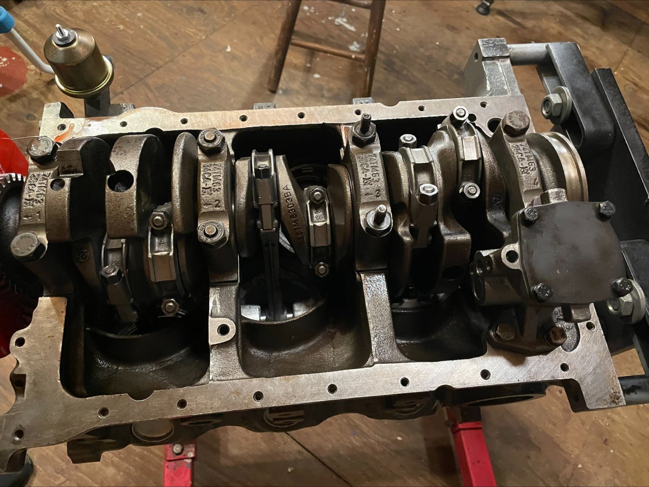

If you want more power out of the 2.8 you could put a 2.9 crank in it to give it more stroke. I'm in the middle of an engine rebuild and that's what I'm doing. I had a 2.9 crank sent to a machinist to have the front turned down to fit the timing gear of the 2.8 and I have it installed in the block. I've bored the cylinders over 0.040" and with the added stroke it will be right at 3.0l.
The 2.8 pistons on the 2.9 crank took a bit of work. When I spun the crank around by hand, the pistons hit the crank counterweight. I had to machine the wrist pin area of the 2.8 piston to give enough clearance for the crank to rotate. It needs 1mm or 0.040" clearance between the crank counterweight and the wrist pin to give good clearance. I did not have to modify the piston skirts as they were the same as the 2.9 skirts.
Add 2.9 intake and exhaust valves, a Comp Cams stage 2 camshaft and an Offenhauser 4bbl intake manifold with some 1986 Ford Aerostar factory exhaust headers and you should be good to go. Duraspark ignition and a single advance 1974 Mustang II 2.8 distributor. Still in the middle of the rebuild so I can't say for sure how this will work out but that's my list. Compression will be higher but hopefully I can get by with midgrade gas.

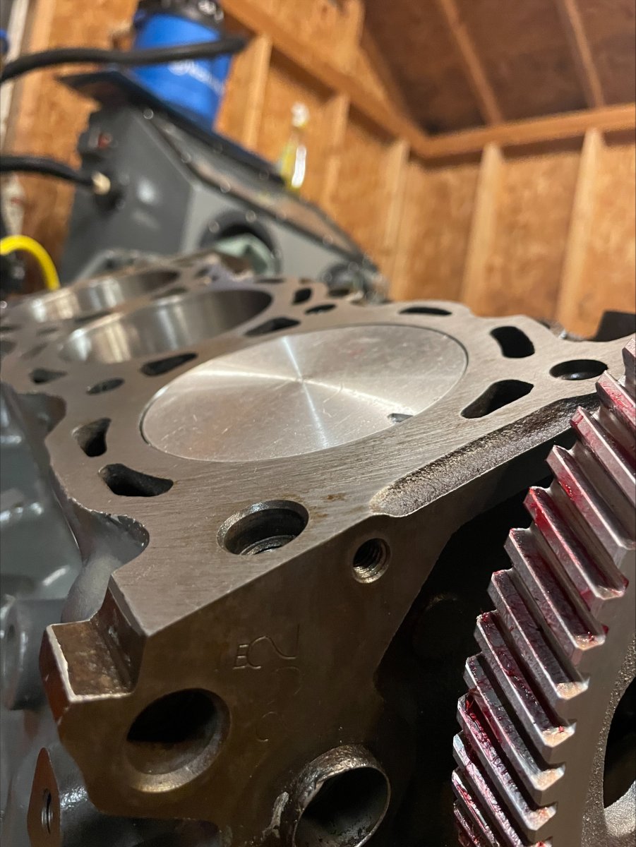

If anyone wants to install a 2.9 crank in a 2.8 engine, here is the deck clearance you get. Measured it to be 0.336mm below 0 deck. This places the pistons 0.04mm higher than the 2.9 piston crown which should get somewhere around 10:1 compression since the 2.8 pistons don't have the dish that the 2.9 pistons have. Crankshaft casting number 86tm6303ba which came out of a 1986 2.9 Ranger.
