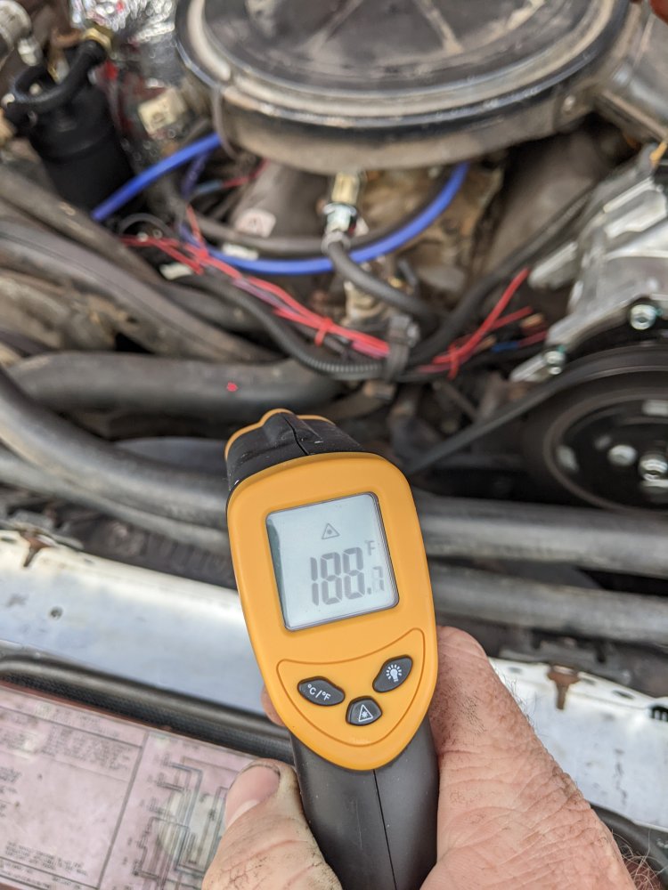

Decided to check the upper radiator hose today after driving home with the AC on and letting the bronco idle for a minute in the driveway for a bit. 76 degrees outside.
I'm pretty happy with around 190 degrees and can only imagine it will be slightly warmer when the temps are up in the summer.
It did tend to run warm when I would be in a Drive thrus and all before, so maybe this will help with that too.
Anyhow just thought I would provide data for anyone with lower thermostat still (all 3 of us lol)

If it runs warmer at idle and then temp drops down when driving above 25mph the radiator is OK but the fan is not, or water pump impeller blades are very worn
Fan's sole and only purpose is to pull air thru radiator when under 30mph
And the shroud, shroud prevents fan from pulling air in from the sides, so all air comes thru radiator, cooling it
Ford's temp gauges are set for approx. 205deg at 1/2 way
Just below 1./2 is where it should be after warm up, and then just above 1/2 pulling a load or going up along grade
1/4-1/3 is too cold, you are wasting money on fuel, same as running with the Choke on
185-195degF is a good coolant temp, it means engine metal is getting hot enough to clean the oil as it passes thru the system, burns off "fuel", condensation and other contaminants
SAE(society of automotive engineers) did a study in the late 1960's, 1970's, they found that, yes, 185-195degF was best temp for engine efficiency and oil cleaning
That was when car makers switched to 190-195deg T-stats from the "standard" 180deg, that were used for so long
Nothing wrong with 160deg or 180deg t-stats, just costs you more money in fuel and shortens the life of the engine :)
