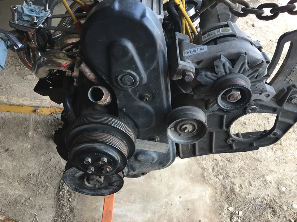

Not sure what I ended up getting. It might be a merkur engine turbo is missing. Can anyone help id this engine?
Some reason I can't add pictures with my phone.

Let try this again
