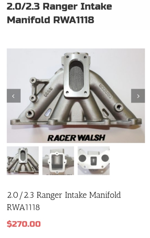

Going from 3.73 to 4.10 is a 9% difference and would definitely be noticeable. When discussing rear end gears: a higher ratio is a lower number and a lower ratio is a higher number. I think that came from the distant past because a lower numerical gear would make the top speed higher.If you know how to check piston to valve clearance, are willing to tear into the engine, and can stand having to run higher octane fuel, 2.3's can stand- if I remember right- shaving .030" off the head and it will boost the compression significantly. The intake manifold pictured would help high rpms at the expense of low rpm power. If you want to run a staged two barrel like the 5200 Pinto's and Mustang II's used, I'd find an adapter to bolt it onto your existing manifold.

That can lead to a whole lot more problems. If you still have the stock carbureted Ranger cylinder head it has round intake ports. Pintos will have oval ports and early '80s cars and 4-plug efi Rangers have D shaped ports. Cannon makes an intake for round port Rangers but it isn't cheap.View attachment 38271
I bought this one for my ranger build. Please inform me what the heck the extra back opening is???
