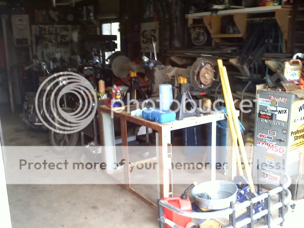

well i did alot of youtube searching and watching so yesterday i finally started the tear down. i had a large table like frame/ structure that i brought home for scrap a few years ago and realized it would make a great table for this project so i wrestled the thing into the garge and set up my works space.

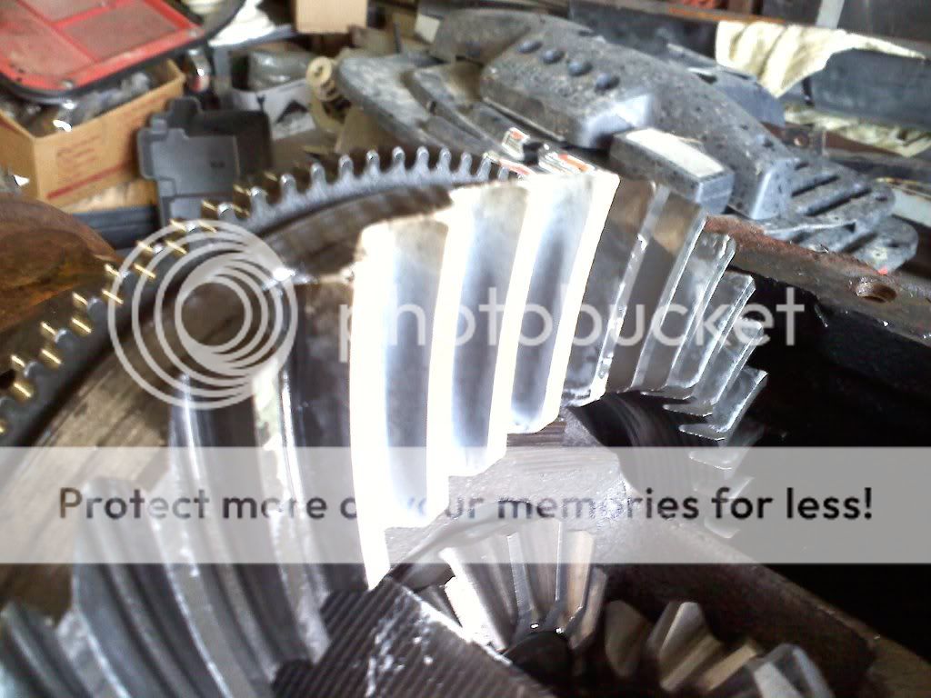

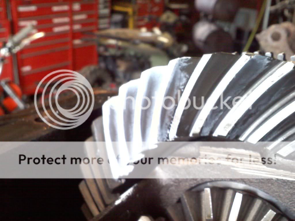

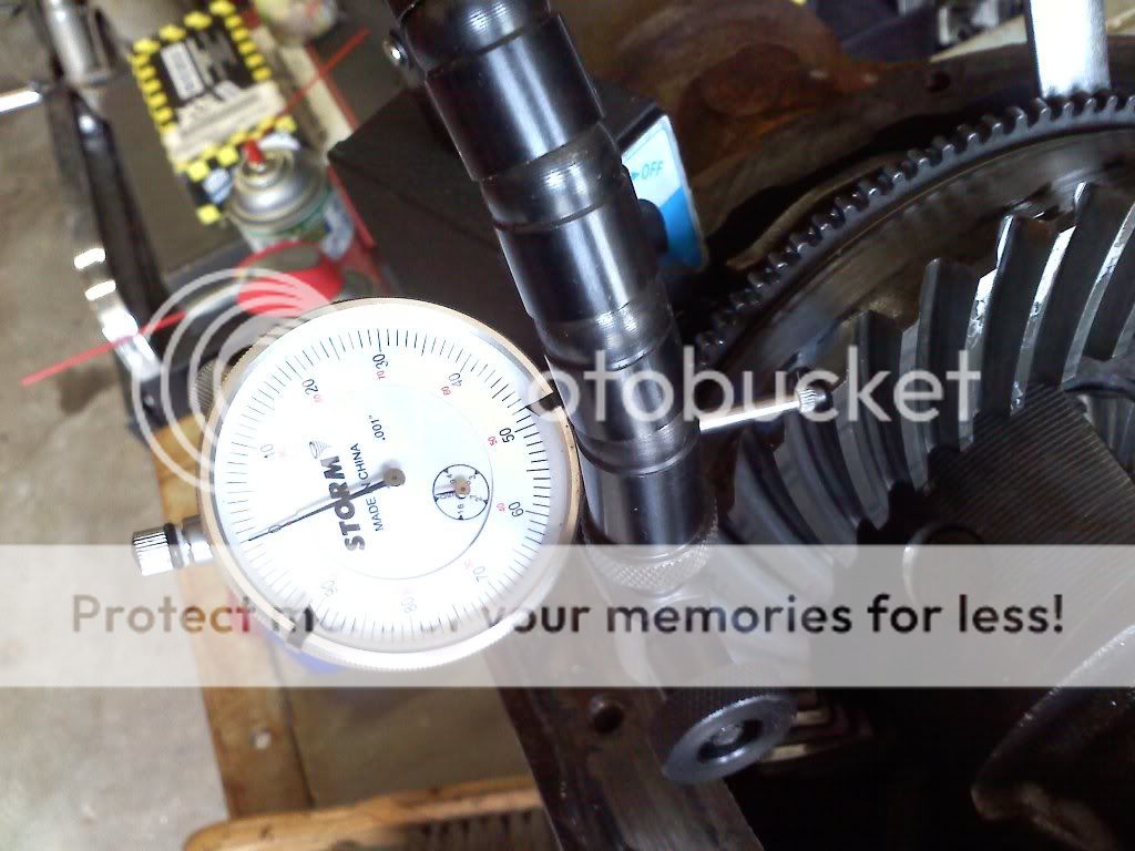

i got out my dial indicator and measured the back lash on the ring gear, i came up with .0135 after checking with the magnetic base on both sides of the carrier. then i marked the gears and checked the pattern. this axle appears to be newer because it had all the original Ford brake components on it, but the outer pinion bearing and race were Timkens and the rest were Koyo. also it looks like it was run low on fluid once or twice as most of the bearings were blued.

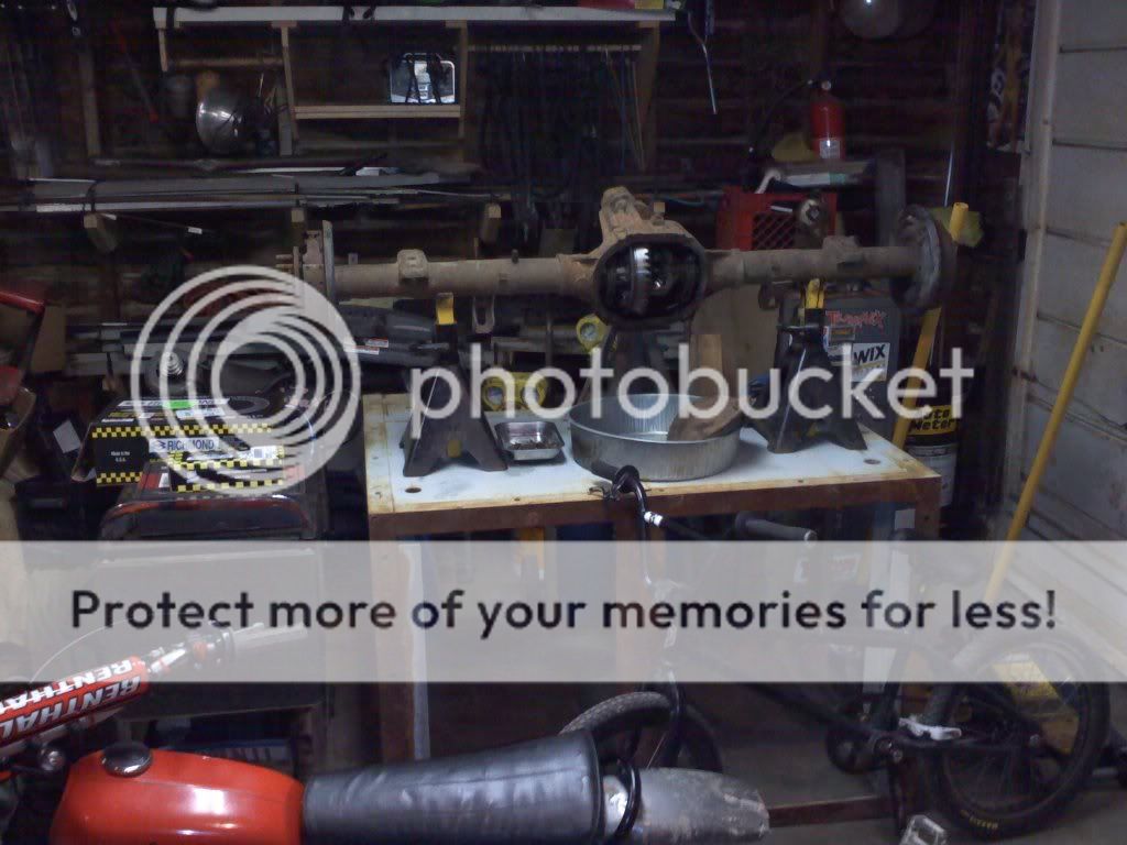

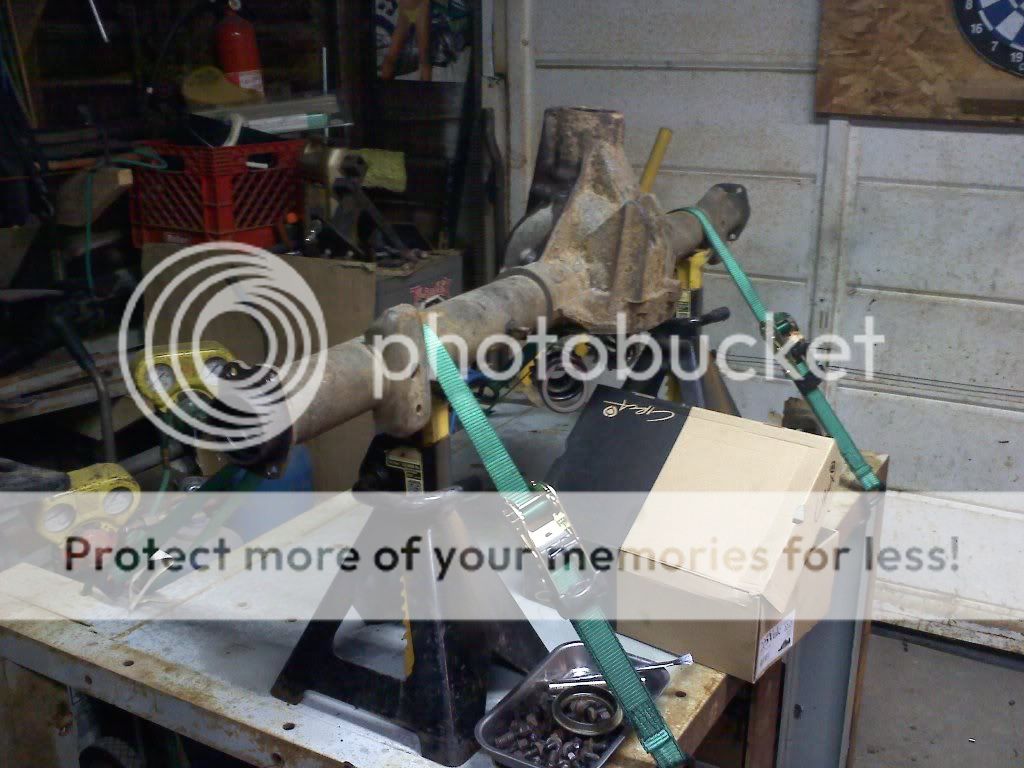

after strapping the axle to the table i got all the bearings and races out, just in time for dinner!

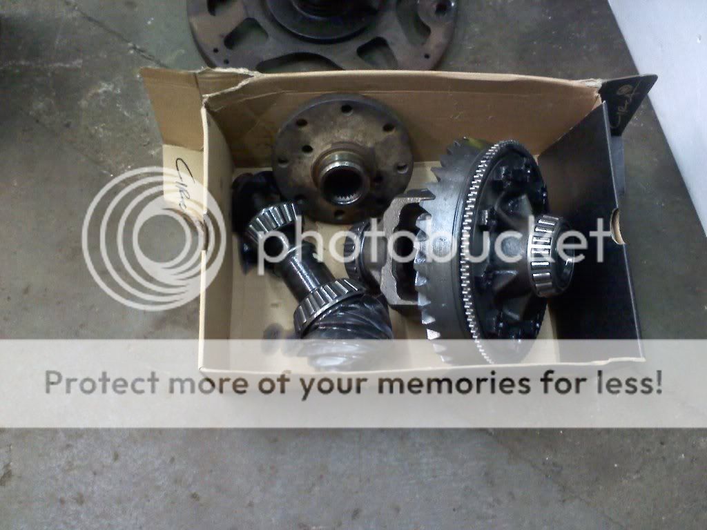

i brought the pinion and carrier to work to press the bearings off and on, but we were so busy today that i didnt get to them.
