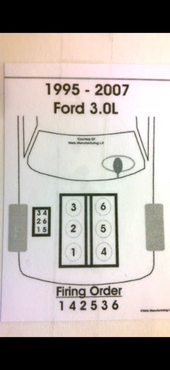

Truck ran fine last Wednesday, I parked it and didn't use it for 24 hours. Drove it the day after and it was misfiring, I took it to O'Reilly's and got new sparkplug wires and sparkplugs. That improved it but it didn't fix it, so I got it home and then took it back the next day to replace the ignition coils. I unplugged the battery while doing that for peace of mind and to clear the codes. After I replaced it and plugged all the spark plug leads back into the correct spots, I tried to start it and it wouldn't start. The battery was dead so I got a replacement, but that didn't fix it. I have replaced the crankshaft sensor and I have good fuel pressure. Sparkplugs spark when tested on the frame. I have also tested the injector pulse and it is good. I do have an aftermarket auto start, and security system installed but I have unplugged them both. The pats system does not appear to be engaged. Any help would be appreciated

Also make very sure that your wires on in the correct order odds are it would misfire at best and do nothing at worst if you put them in the wrong order.

Are you absolutely certain without a doubt that those spark plug wires are back in the correct order?
If it’s got spark, it’s got air, I assume it has compression, and you’re spraying ether, and all it does is sputter, that tells me your spark has got to be out of order. It’s also possible the engine is out of timing, but that would involve some kind of catastrophic failure, and you hadn’t mentioned anything like that.
