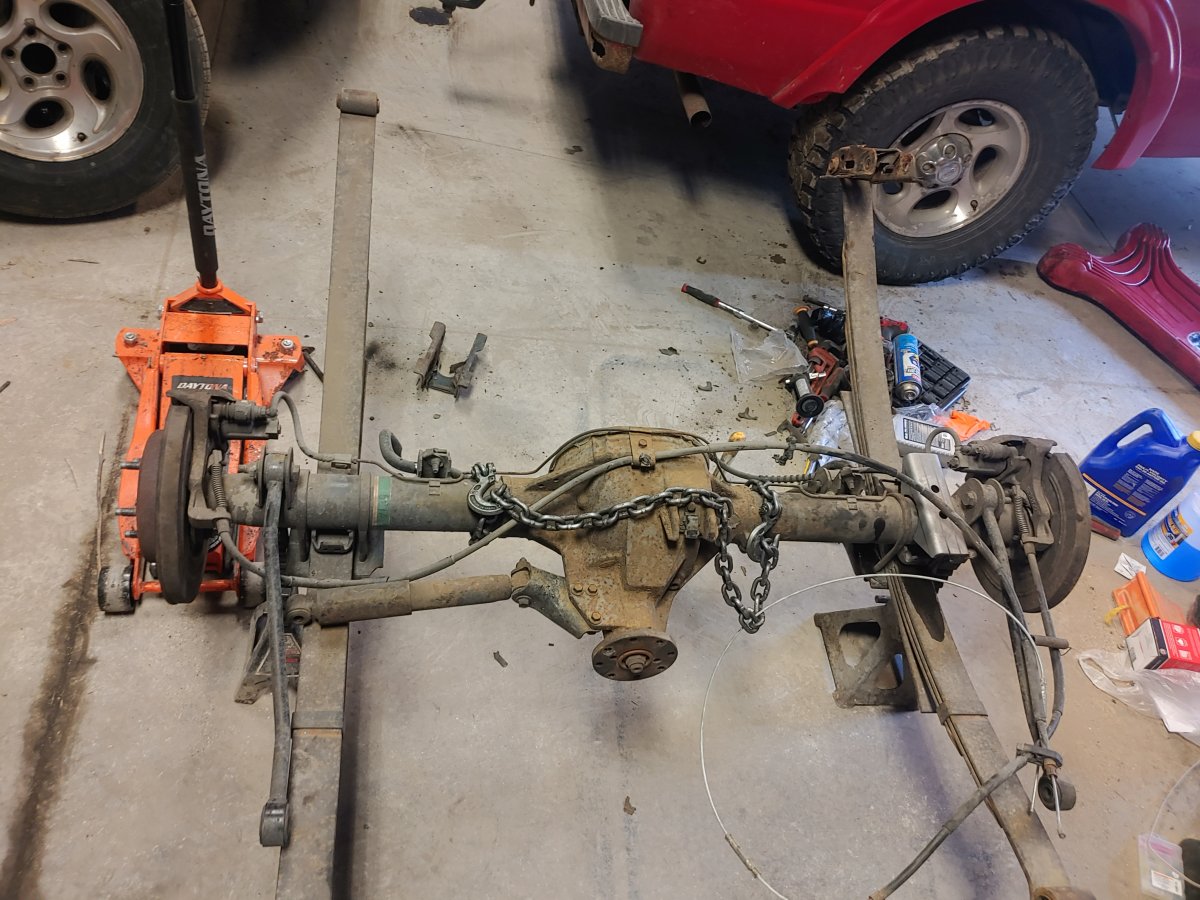

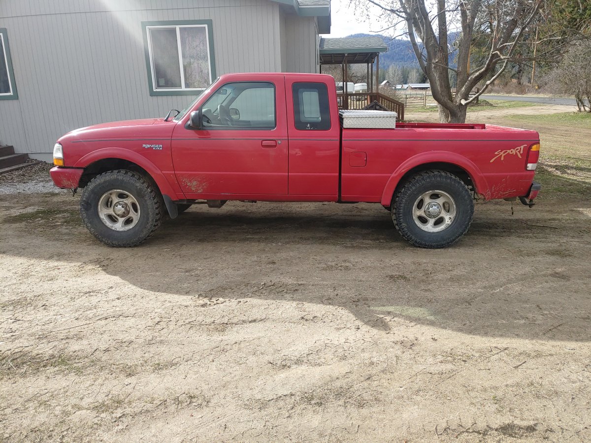

So before picture of the truck. And a picture of the disc brake rear axle ready to start swapping spring perch and such around.
  • 1999 Ford Ranger V8 swap

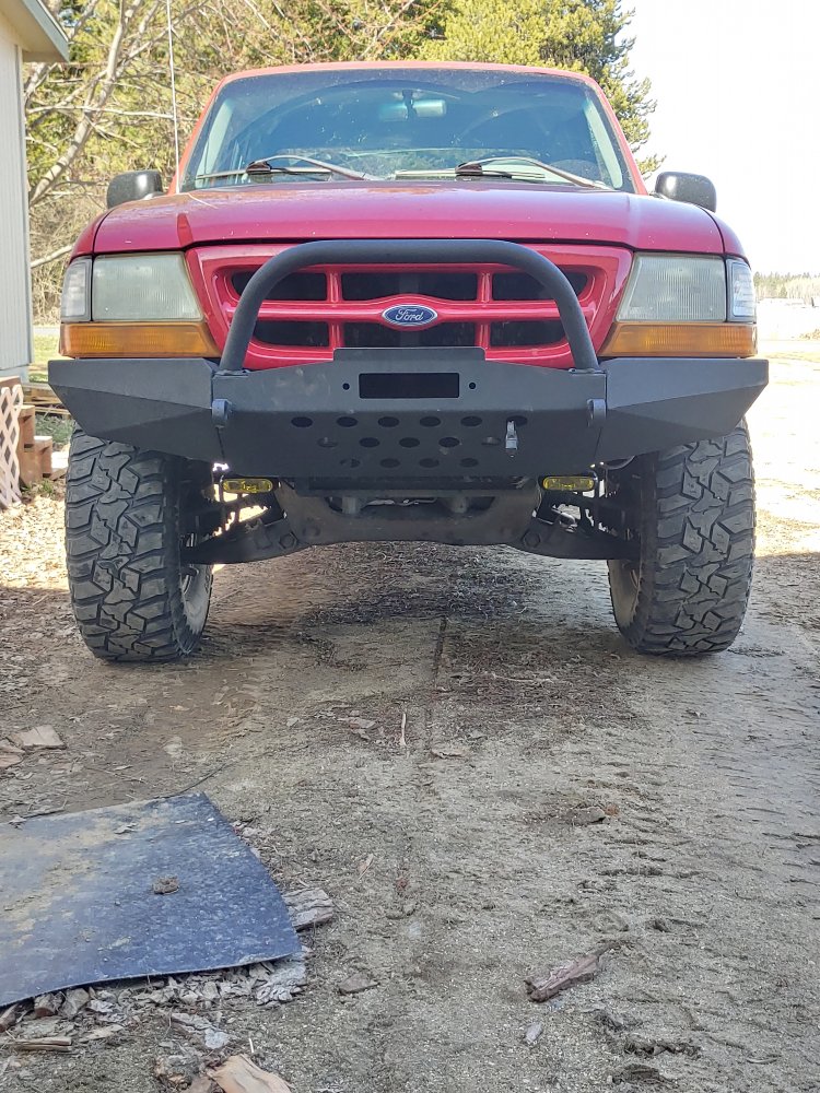

So found a bumper and ordered it. Ordered Monday. Showed up today and got it installed. Was planned down the road but just happened to find it at a decent price.
