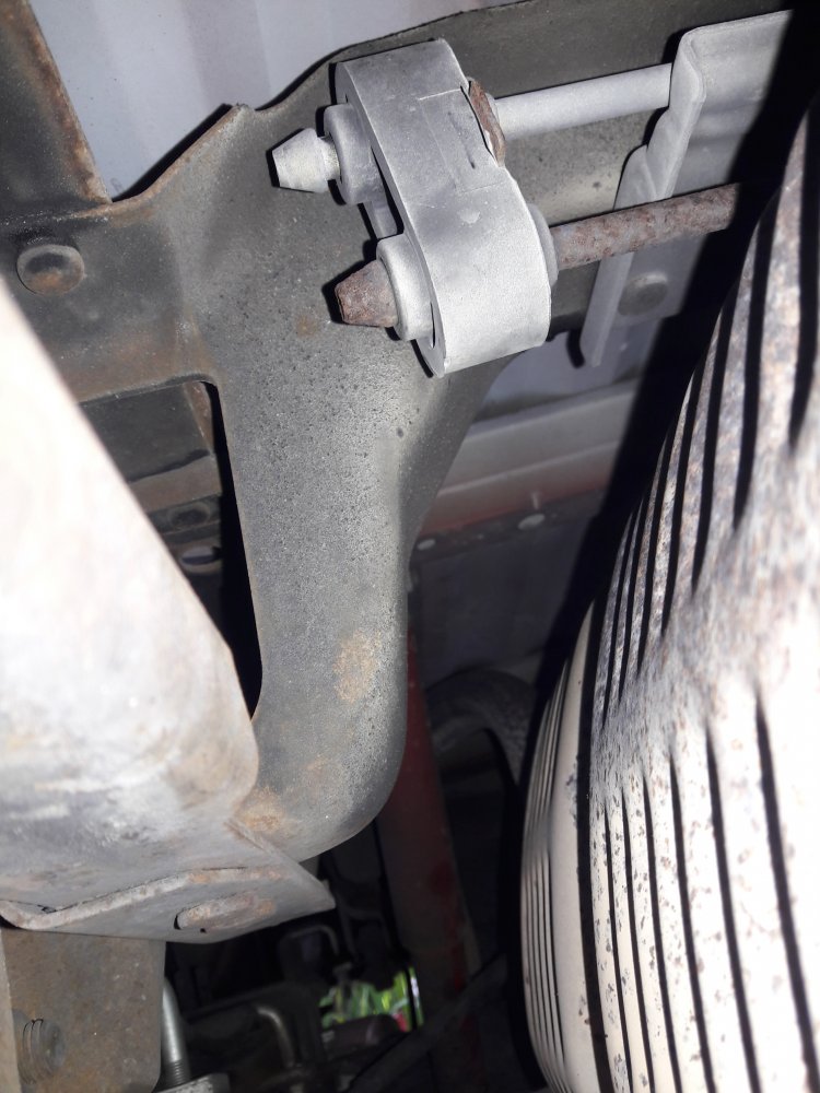

I'm getting set to replace my catalytic converter on the '99 2.5L. It sounds like it either has a hole or it's cracked, and I have slight loss of power, but no check engine light. Looks straight-forward (2 bolts at the exhaust manifold) and a clamp with springs on other end. That whole section can be replaced with a new Rock Auto direct replacement cat. converter for about $250.
The question is: would it be a good idea to just replace the O2 sensor (since I don't think it has ever been replaced.) Are o2 sensors from Rock Auto direct replacements?
Also, would messing with O2 sensor effect the computer? I'll probably just disconnect the battery before doing anything (like all manuals say to do.)
Also, these hangers look hard to get off...just cut them and replace them with new ones?

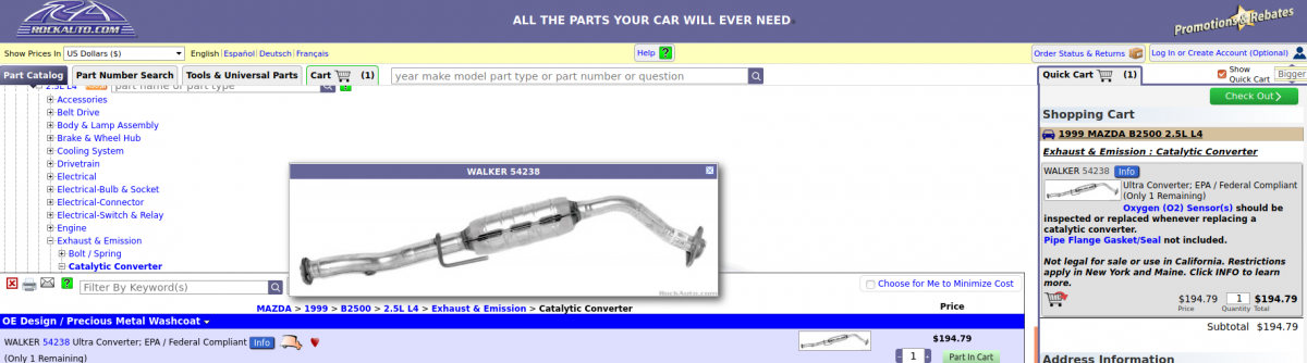

UPDATE: Oct. 17, 2020 This is what I'm looking at getting, have to go by visual comparison...no way to tell if it's exact fit.
UPDATE: Jan. 2021 The Rock-auto IS a direct replacement and I did get 2 new exhaust manifold to flange studs. I also got new oxygen sensors and decided at the last minute to have the job done by a mechanic
