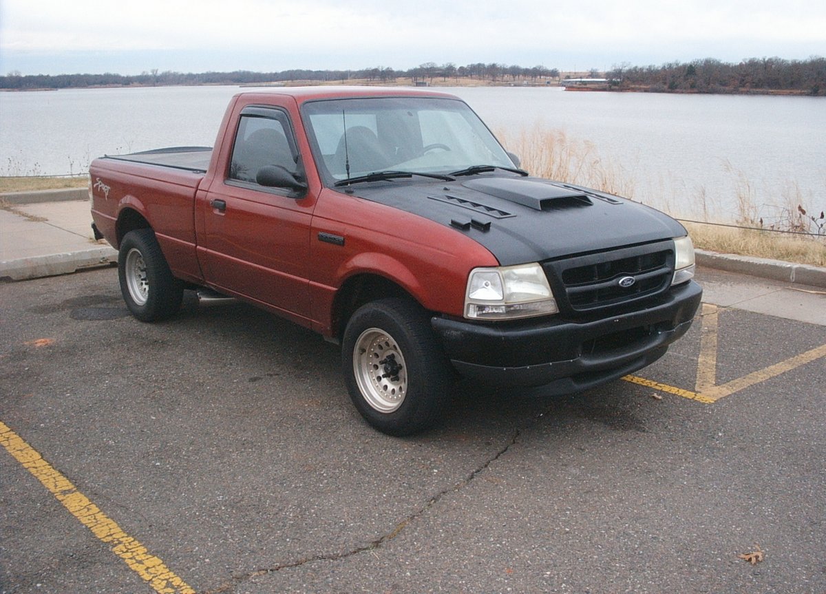

I thought about doing that exact thing, but going one step further. Mounting a transmission cooler or motorcycle oil cooler, such as Derail, up front. It would be very similar to the intercooler routing on my Lightning. Fluid from tank is pulled out via pump, goes through the cooler mounted up front, then into the manifold, then back to the tank. I don't know how large the fluid reservoir is in the manifold, how far it spreads out from the two hose fittings. Knowing that would determine how effective it would be at cooling the manifold. Even with a hood scoop sitting overtop the manifold, and a bunch of 1.5 holes under it, the manifold still gets pretty hot. Maybe not as hot as it used to, especially in the winter, but it still gets warm.

There is probably a better difference if you replace the metal intake on the 98 - 00 with a plastic ones off the trucks after 2000. The metal intake on my 3.0 Ranger gets hot, even with a scoop over it. The plastic intake on my 07 Mustang doesn't get hot enough you can feel it. I just don't know if the plastic upper intakes on the 2001 and later models will fit on the 98 - 00. If they do, I may just go that route.

They will fit. But the throttle cable & other things may take some finessing to work.
