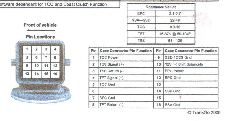

On the drivers side of transmission, in front of shifter, is the 16 pin connector for all the solenoids and sensors in the transmission
(same connector and wiring was used in Rangers 1995 thru 2011, 4R and 5R)
Seen here:

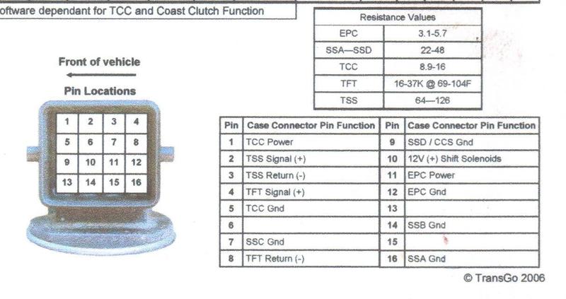

TSS + and - are pins 2 and 3
Use an OHM meter and see if it shows 64-126 ohms

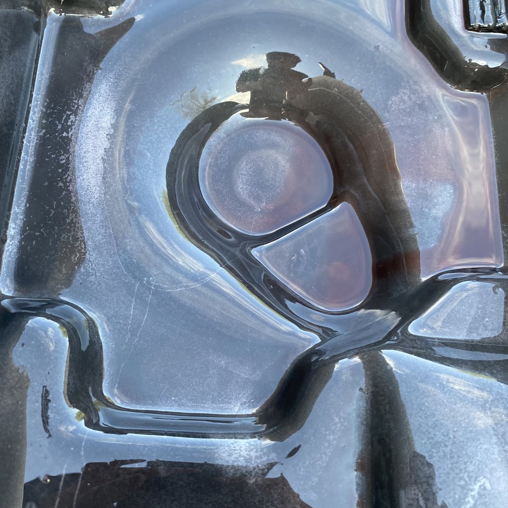

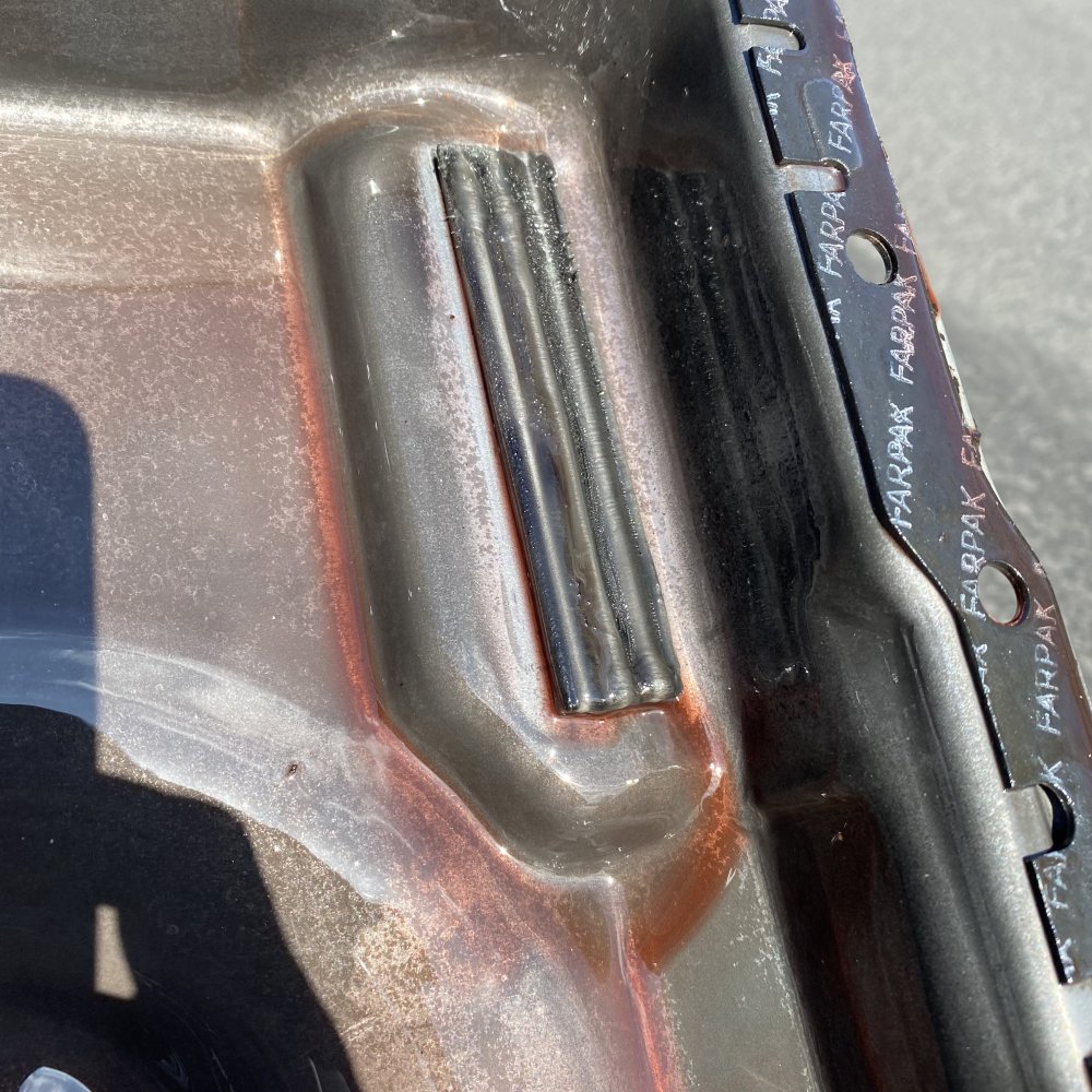

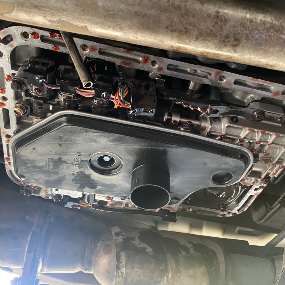

I removed the oem transmission pan , drained the ruby red atf ( it was clean and transluscent no burnt oil) .The magnet had no shards, it was normal. I cleaned it up and put it in the new pan. I replaced the oem pan with a 60 dollar pan that has a drain bolt . I replaced the filter which did look filthy , I put a premium wix filter in with lubed orings on the in and outlet , I bolted it all up corner to corner star pattern and sealed it up.6 Quarts is exactly what came out when I emptied my oil pans into a home depot hdx painters 10 qt bucket. I uses 1 gallon and 2 quarts of Valvoline Maxlife atf to fill her up, I put the key in, shifted to neutral, then into 1st and 2nd then neutral then reverse . Allowed it to move ... checked the dipstick and its exactly at the checkered marker running hot . I ran it down the road and it drove like new, all shifting had power and smooth. the speed sensor circuit OD light came back intermittently but goes away and at this point its not effecting the smooth like new shifting. Back to square one ... it has to be a wire??? But like I said I dont recall a sensor in the bellhousing. Ford is stupid for having too many versions of these transmissions ... I need to know where that sensor is . Maybe im not seeing it or feeling it on top of the transmission housing . I also checked the wiring in the valve body it looks new and nothing is loose or frayed . Nothing looked dirty or burnt. this can be a gem module/ wire outside or the harness plug voltage itself. Any more input? Who should I have analyze it ? I dont want an average dumb mechanic

The TSS sensor should read 64-124 ohm
Set OHM Meter to lowest setting, usually 200 ohms
OHM Meter(16 pin connector)======//========TSS sensor
The // is the connector inside the pan
Remember the exact OHMs, if it tests "in range"
Then you can unplug the PCM connector and test its 2 wires to the TSS sensor, should be the same OHMs
Pin 94 and pin 91, on PCM connector

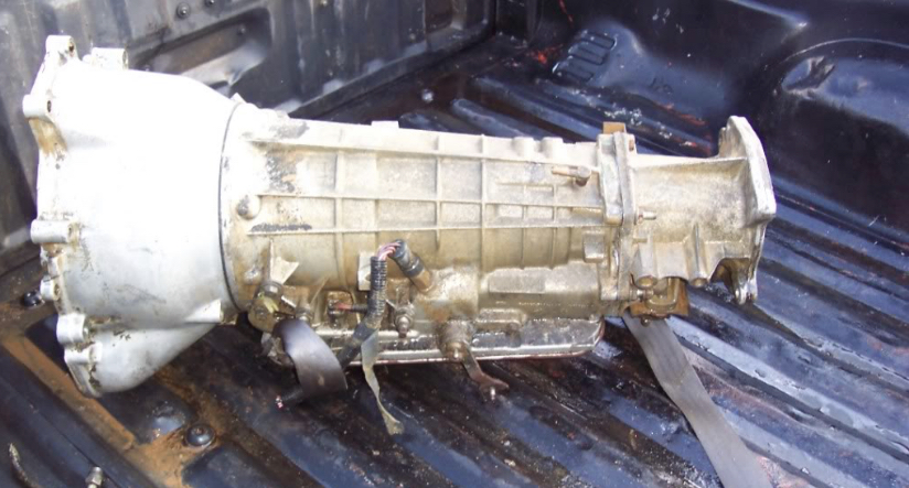

Im trying to identify the black plug on the top dead center near the rear of the transmission housing , thats what seems to connect to my speedometer
Wrong picture, thats an A4LD 1985-1994 Rangers
1998 4R44E may have an OSS(output shaft speed) sensor at top rear, but its not used for speedo in 1998 just output shaft RPMs for PCM, to make sure correct "gear" ratios are being selected
