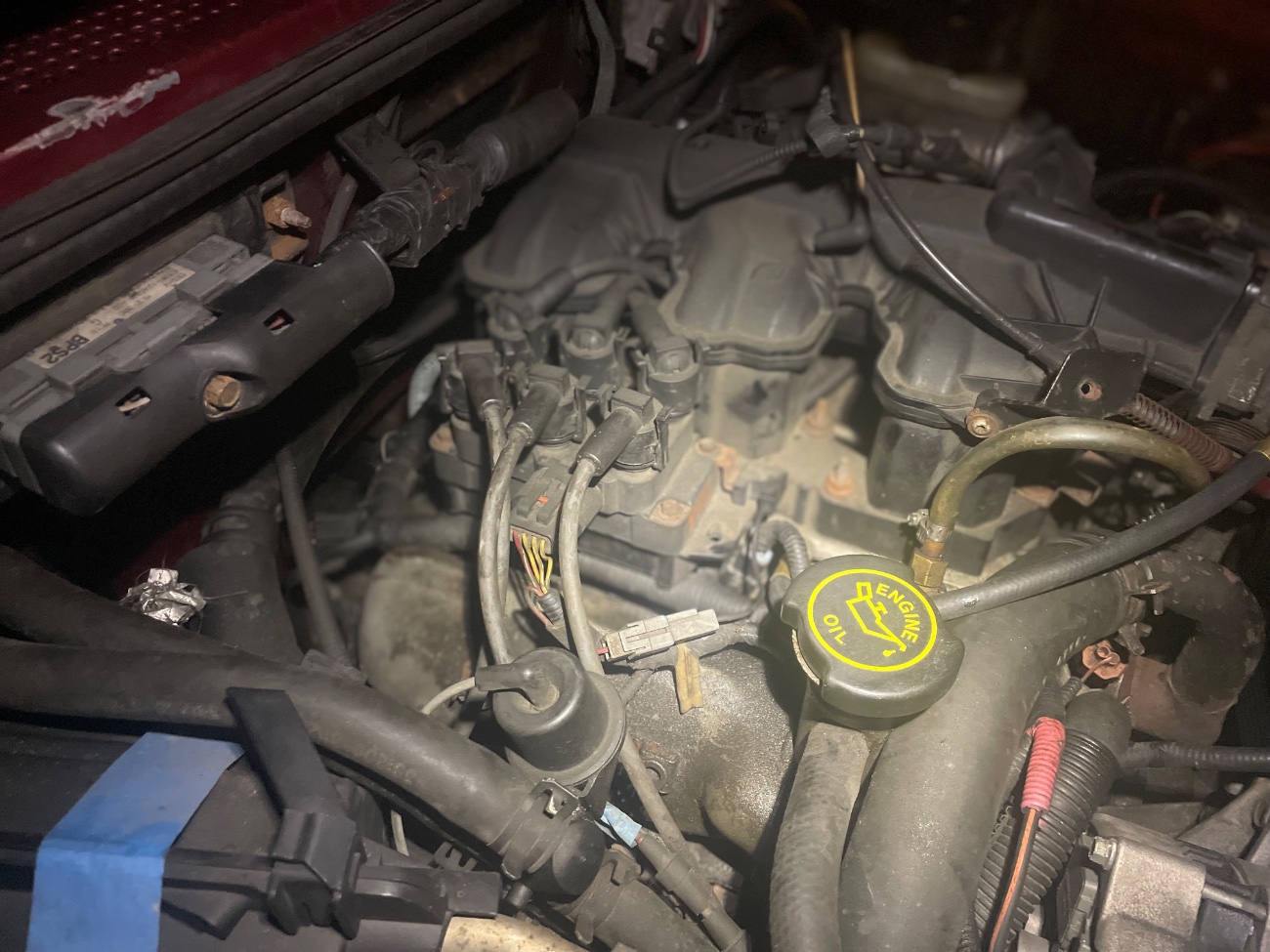

Is it any where in this picture?
1997 ranger 4.0 where does the power for PCM relay in power distribution box come from?
the single wire grey critter.....red green stripe should be the harness side.
unplug this connector and check for power with key on? I can also add power to this to power the circuit to see if it puts power to the relays and starts?

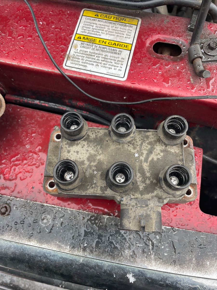

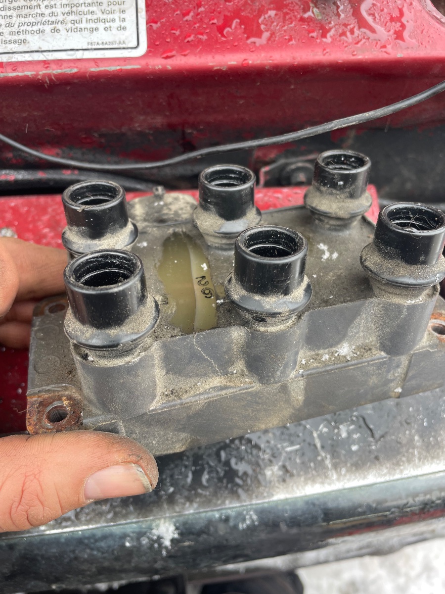

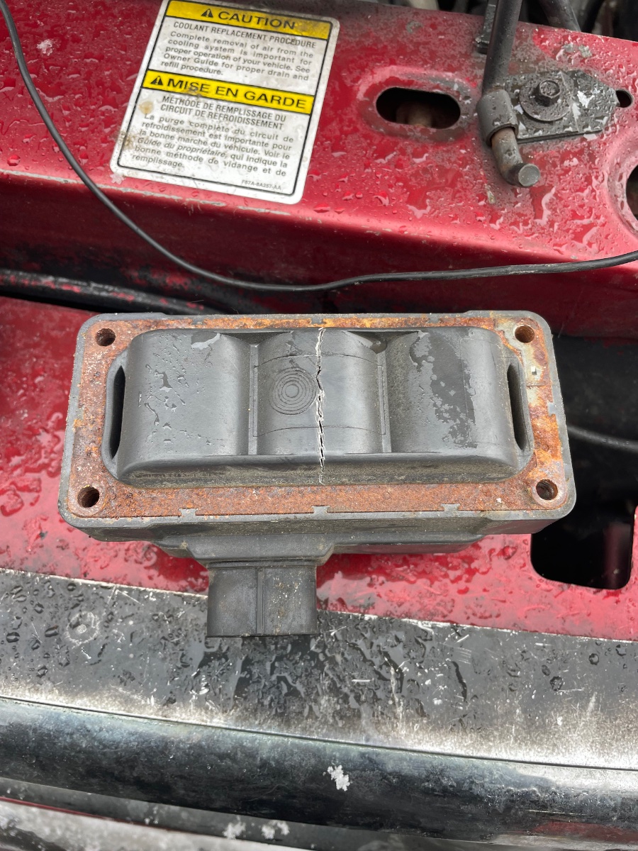

Problems solved. It was the 25amp fuse in the side dash fuse box. And the reason for the low power before the no start was the middle coil on the ignition coil split on the bottom. Once I got it to start, it wa running rough. I was then able To connect the reader to it and had a P0353 primary ignition coil C. But als a pending for a P0351. I checked the ohms and 3/6 had open readings. I had a spare coil I put on and running smoothly again.

  • 1997 ranger 4.0 where does the power for PCM relay in power distribution box come from?
Just noticed the crack in the top also
Congratulations. I'd bet the bad coil is what caused the fuse to blow then.
The new coil I put on, I tested the ohms and was only getting in the 10k range where spec is 12-14k. It ran good on my 10 mile test run but when we left with it, it started running rough and threw a CEL. Same code P0353. I have a parts 4L so I pulled that coil off and truck is running good on the 13 mile test drive. That one tested good, the end coils were in the 12k range, the middle was high 11k. The new one I checked had all 3 still in the 10k range and didn’t see any physical damage on it. Hopefully good enough. I’ll get a new one to have as a spare since I have 2 other 4L ohv rigs
