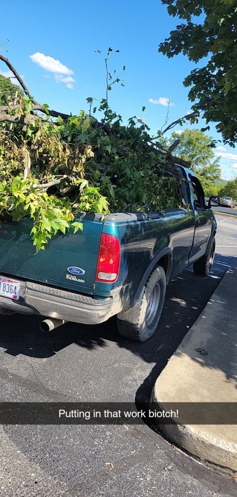

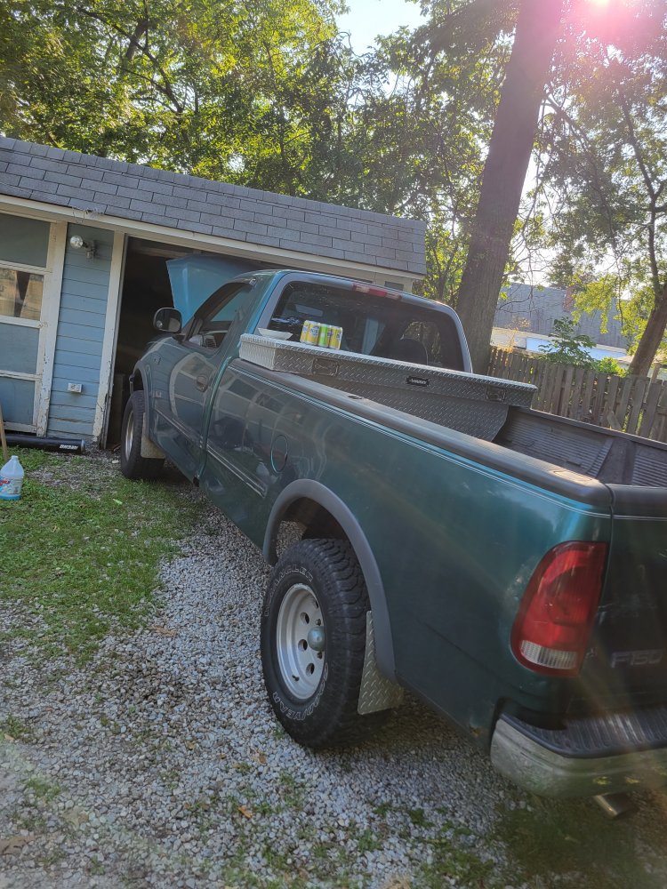

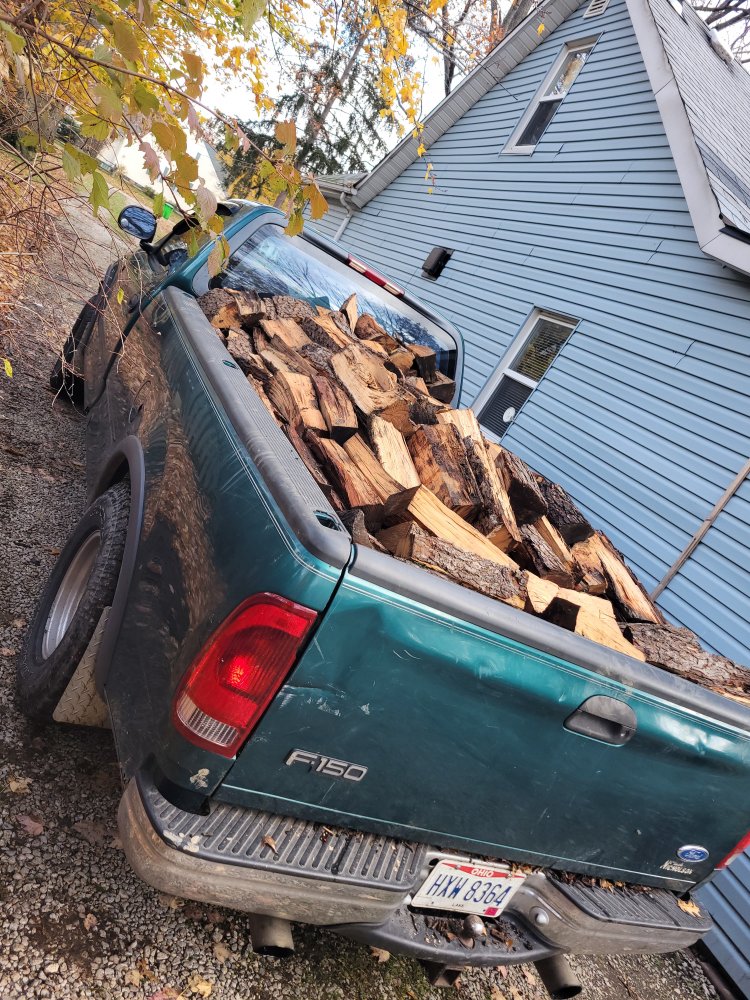

I am going to be changing the fluid here soon, I would love to keep this truck going frame is solid body is ok good enough for me typical cab corner and rocker panel rust, truck is a dog!
The 4.2 wasnt exactly a power option lol,
People hate being stuck behind me especially getting on the freeway lol
