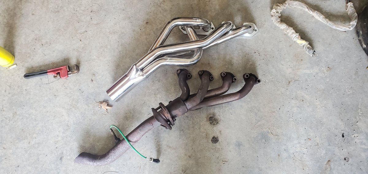

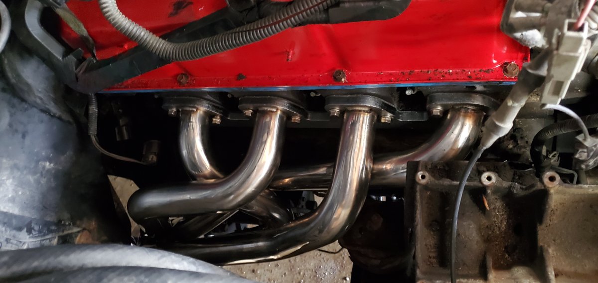

Got the mid length header (mostly) installed, not the easiest job but not terrible. Plenty of clearance all around 👍the job requires removal of the alternator bracket and a bunch of other nonsense to wiggle it in there.. really wish ford would of separated the ignition coil bracket from the alt bracket as where the coils mount was the only bit actually in the way... but it is what it is.
Wiggling the alternator bracket around to fit the header caused some sort of coolant fitting to lose its fitment and dump a bunch of rusty crap coolant everywhere..
Well figure that out next weekend. For now.. I'm happy.
Oh yeah... how do you like the look of these coils? The metal bits on bottom that make contact the alternator bracket have definitely seen better days... they seem to be turning into biscuits...
Might explain the slight miss? I've never seen a set so terrible looking lol.
Cool looking header
Cool looking header
I really would of preferred some longtubes.. but everywhere I checked said they didn't expect to have any stock of them until september.. and I'm impatient lol.
Either way... im happy with what I got. Nice thick flange, equal length primaries, hardware seems decent.. and the price was right. Excited to hear it sing the song of its people once I'm done!

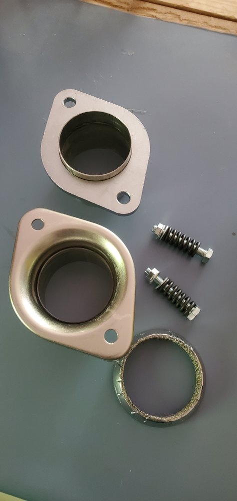

Got lucky and found a donut flange kit on ebay for 60$ IIRC.. I would of liked to go with the fancier ball&socket setup but every one I found available was above 150$ 😑 no thanks.

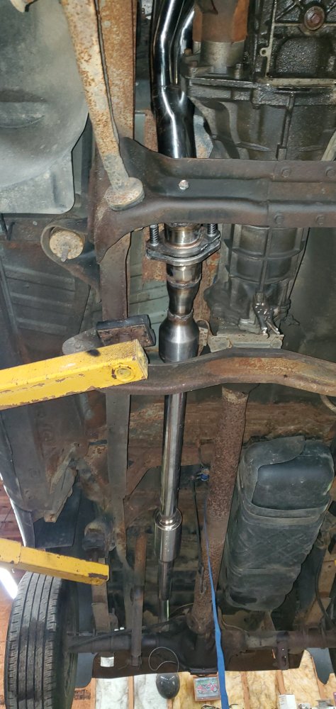

Got my FART CAN placed & welded into the exhaust today.. and got the everything hanging at the height it needs to be 👍

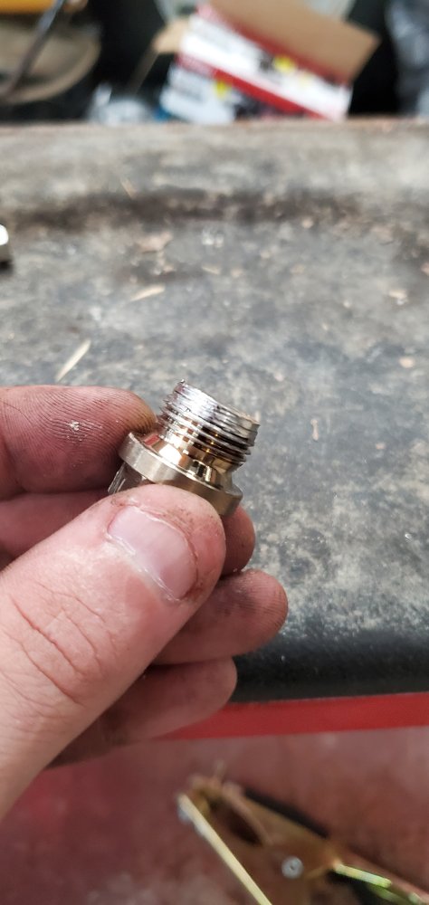

Got a hole drilled in the collector and a bung welded in for my pre-cat o2 sensor.. went a little wild with the welder though 😣. I welded the bung to the header with the plug in it.. once it was cooled the plug wouldn't come out without an impact 🙄
I'm hoping that simply running a tap down my bunghole will work well enough... got no choice now but to find out lol. I'll lighten up on my trigger finger for the one I gotta burn in post-cat.

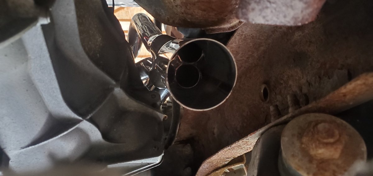

One more 45° elbow to kick it out the side behind the tire, putting the last bung in, a couple rubber hangers and the exhaust is DONE! Well... done until it doesn't leak oil everywhere.. once the mighty 2.3 keeps its oil to itself I'll wrap the header 👍

Yeah, your problem is that plug looks stainless, they gall when you look at them wrong... if MIG welding those bungs for the most part just leave them empty from my experience
