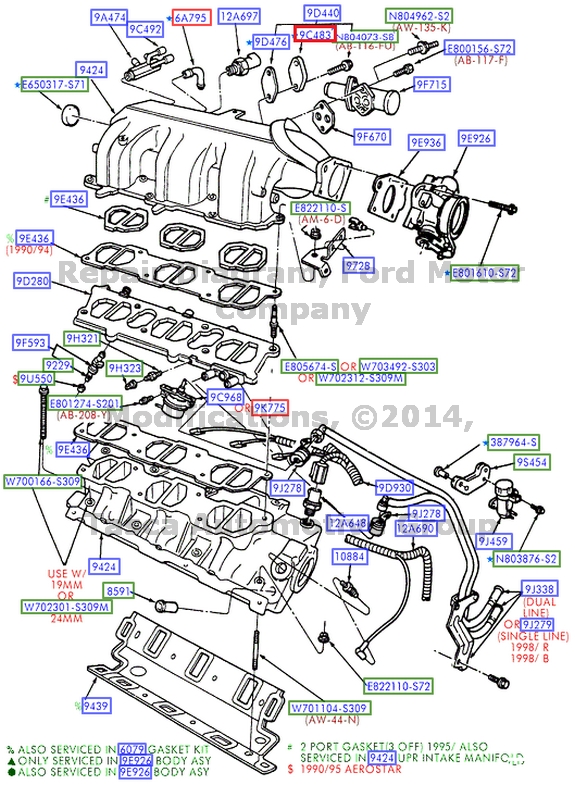

Thanks for the links, they will help but I was looking for a parts diagram / parts explosion and/or illustrated engine diagram like this:

That link was the original post I found doing searches and how I found this site. I did this post because I have milky oil and the other post was white smoke and not milky oil. The engine diagrams I posted are a help but i can't find any step-by-step directions or video on how to take the engine apart and put it back together but I guess it's about the same as any other engine and you did give a link to the torque specs. I plan to check the compression shortly.
Its been a long time since I've rebuilt an engine. What I've noticed that has changed is torque to yield head bolts. I think but don't know for sure that is the main difference. I'd purchase a manual for peace of mind.

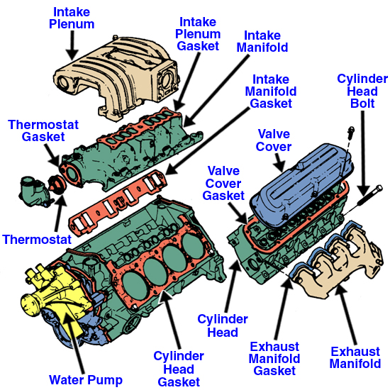

More parts diagram / parts explosion and/or illustrated engine diagrams

A really good color parts diagram / parts explosion and/or illustrated engine diagram.

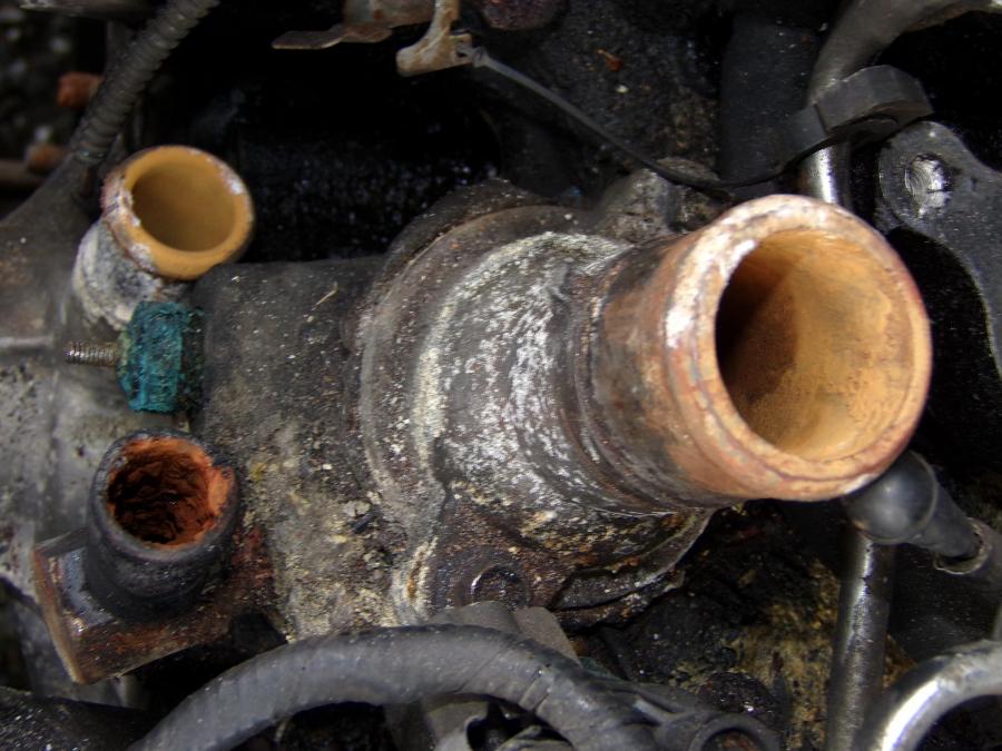

Looks like the was as much oil/water mix in the oil pan as there was in the water pump. I included a picture that shows the radiator hose inlet to the water pump and the 2 heater core inlets. One heater inlet doesn't look like the other inlet and radiator inlet.

I have the intake off and looks like the gasket bad in one place but not sure. Call the local machine shop and as I thought they suggested since the engine is as far apart as I have it I should take the heads off and have them rebuilt. I didn't want that expense on a truck with almost 200,000 miles. See photo where I think the intake gasket when bad and the clogged coolant port on the driver side cylinder head.
