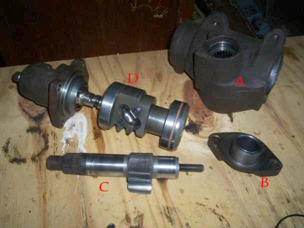

Is your drilled and tapped steering gear a reman. you bought, or did you have one off a rig and rebuild it? I was looking on rock auto and they are $100 reman.
This is the OE gear box off of my '93. I don't know if you've looked at the writeup here on TRS of the steering box rebuild, but the piston is MUCH smaller in some of the boxes than what I have. I don't know if that makes a difference, but it's something lol. Another thing I noticed is the "rebuild" writeup is incomplete. They don't replace the bearings and they don't take apart the worm gear to replace the tephlon bushings.
And yea, a remanned is only $100. It would be a good idea to grab one and just unbolt everything (keeping the preload on the adj. screw of course) and just drill/tap that one.
The one in the writeup:
Mine:
Something to think about. Brad, how much are the rebuild kits? Do you know or have you priced the rebuild kit for the 79 box or know what the remans cost for those? I haven't even thought of looking at the prices yet...
SVT
Rebuild kit cost is $40 shipped WITH new bearings and APARENTLY RockAuto has the same rebuild kit part # listed for a 78 steering gear rebuild kit AND a 92 steering gear rebuild kit BUT broncograveyard.com lists two DIFFERENT rebuild kits for 78-79 steering boxes...
