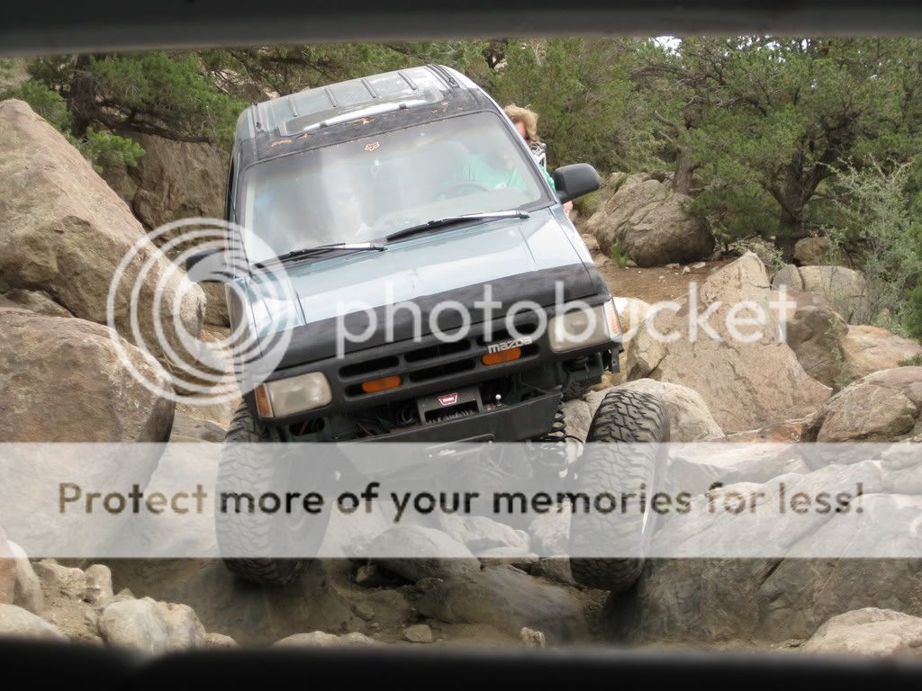

I haven't been to this forum in sometime, but lately I have found it helpful and entertaining once again, so I thought I would post up some build up pocs of my junk.

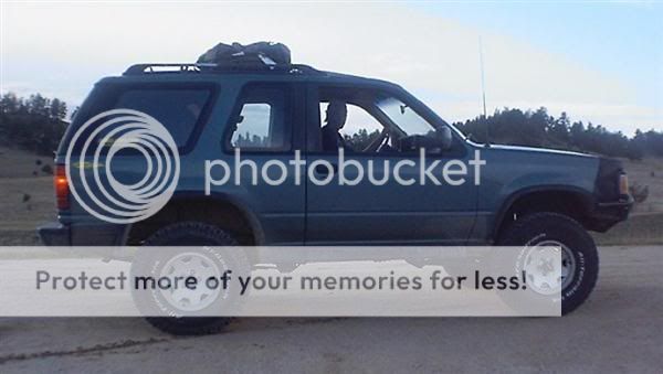

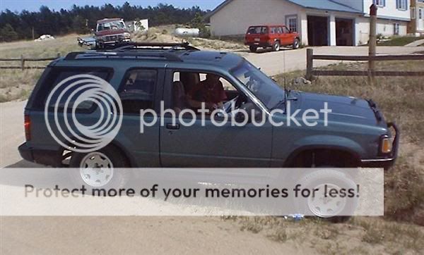

Here is the earliest pic I have (yes it was a navajo). It had cheap 235s, and auto tranny and Tcase and a 2.4" VR James duff suspension Lift. Worked Pretty Good!
Next Here it is with 4.5" of suspension (JD coils + spacers), SOA rear, Duff extended Radius Arms and 33x10.50 BFG A/Ts:

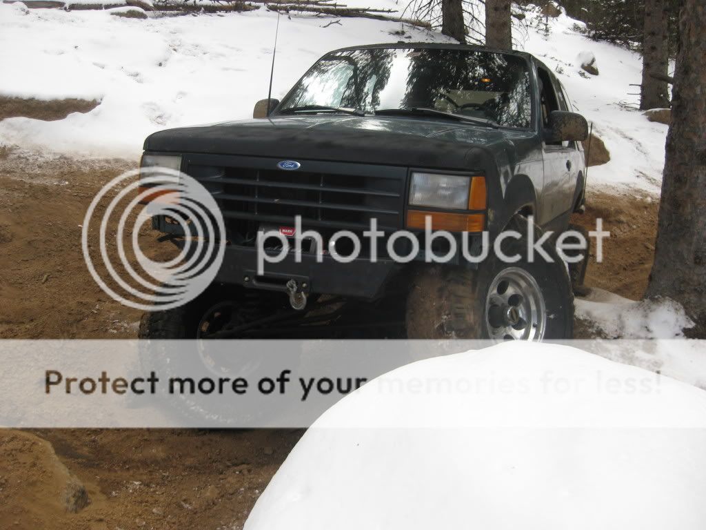

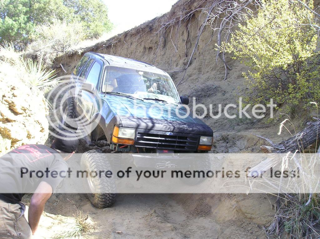

Here it is in current Form:

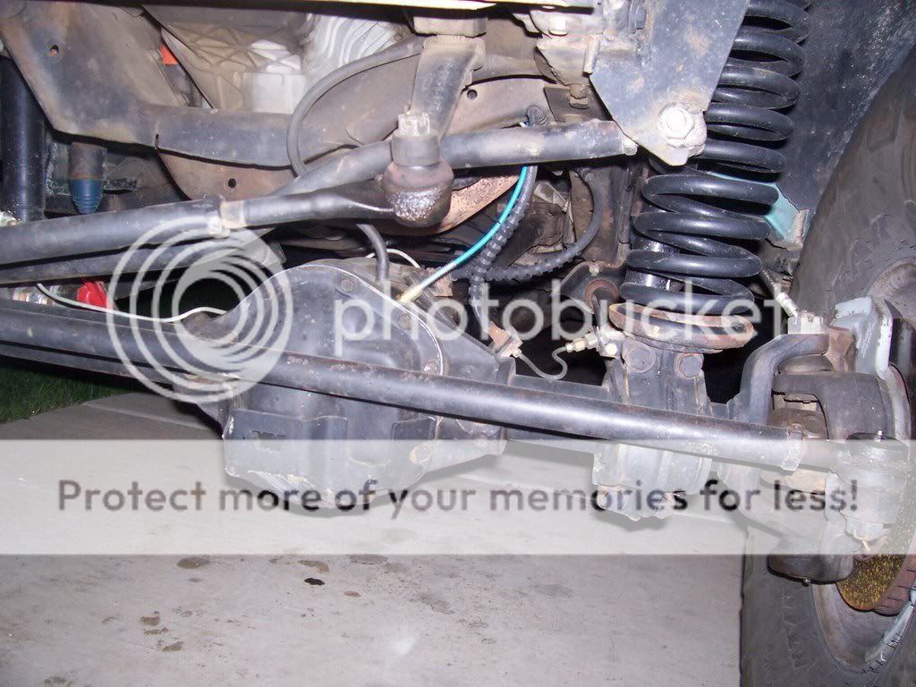

Explorer now, Manual Tranny and Tcase, XD8000 Warn Winch, Sliders, Rear Bumper, 37x12.50 MTRs
1976 Dana 44 Narrowed 6", ARB, 4.56 Yukons, Yukon Superjoints, Yukon 4340 Shafts, Stock length Radius Arms Passenger Wristed, Chevy TRE conversion (over knuckels), Warn Premiums, Axle Pushed forward 3.5"
Rear is a different 8.8 (I exploderd the first), Yukon 4.56s, Detroit EZ Locker, Myers Wheel Spacers, BTF DIY cover, Ruff Stuff Brackets, Axle Moved back 1"

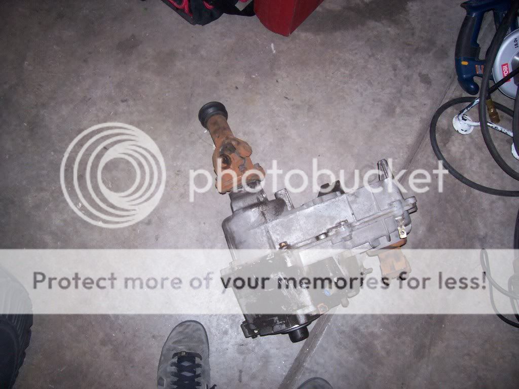

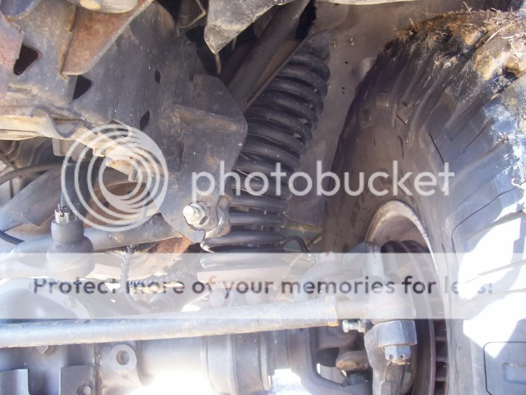

Here is all I have left:
DandD doubler and another 1354 to go in:
Its Winter and now I need to get that doubler in! No excuses!

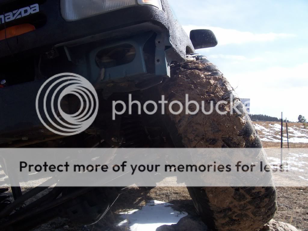

Here is the 8.8
Rear Bumper Shots
Oh, also I need to do a swingout spare carrier. I am thinking of using a Dana 44 hub and spindle for the hinge.

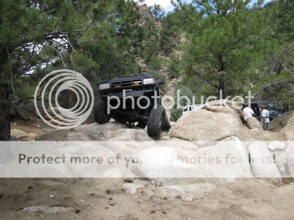

how does it drive with the 4.56 gears and the 37's?
Gets 17 MPG and runs down the highway at 90 plus...
Perfect for driving, wish it was lower for wheeling... That is where the doubler comes in!
how much lift you think you have total?
Enough to fit 37s with some trimming and wheel base stretching :icon_confused:
I don't know I would say 6.5" to 8". I am pretty sure it is as much lift as I ever want on it. It is pretty stable with the offset wheels and the suspension travel, but I ran it with stock fullsize bronco wheels, 34s, and no wristed arm and it was pretty tipsy.
