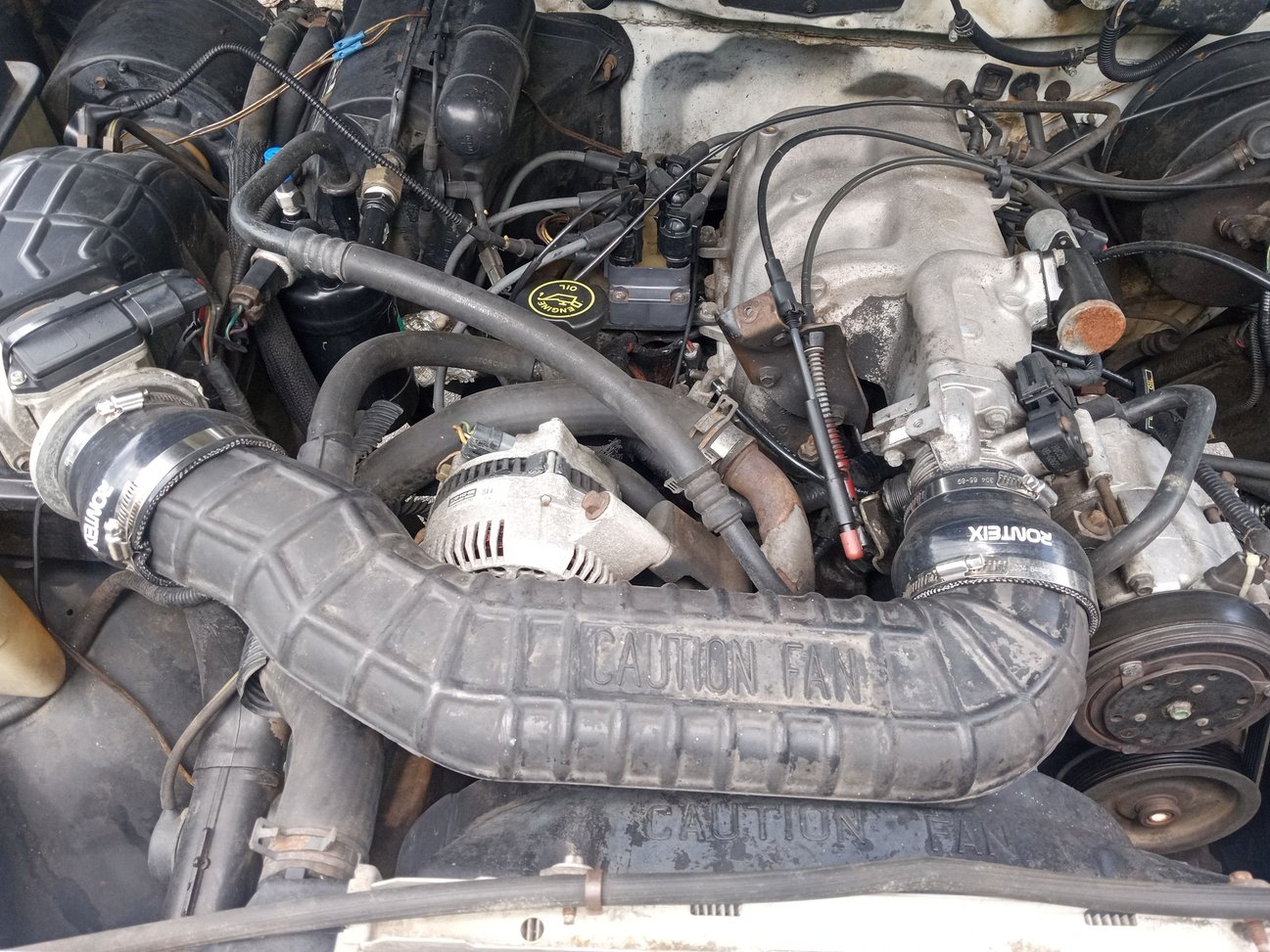

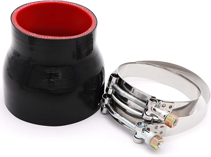

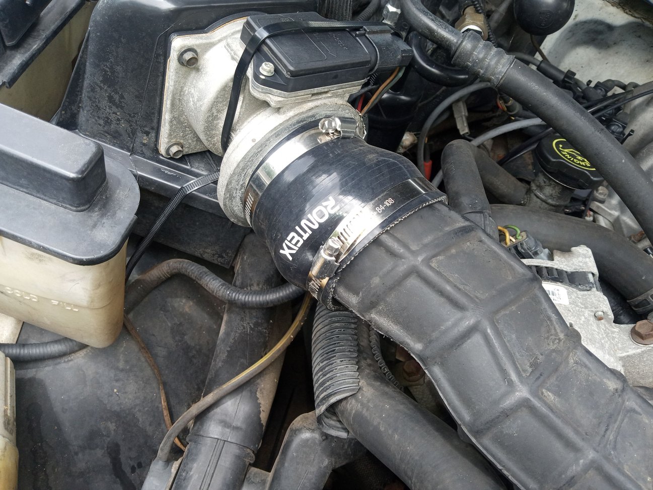

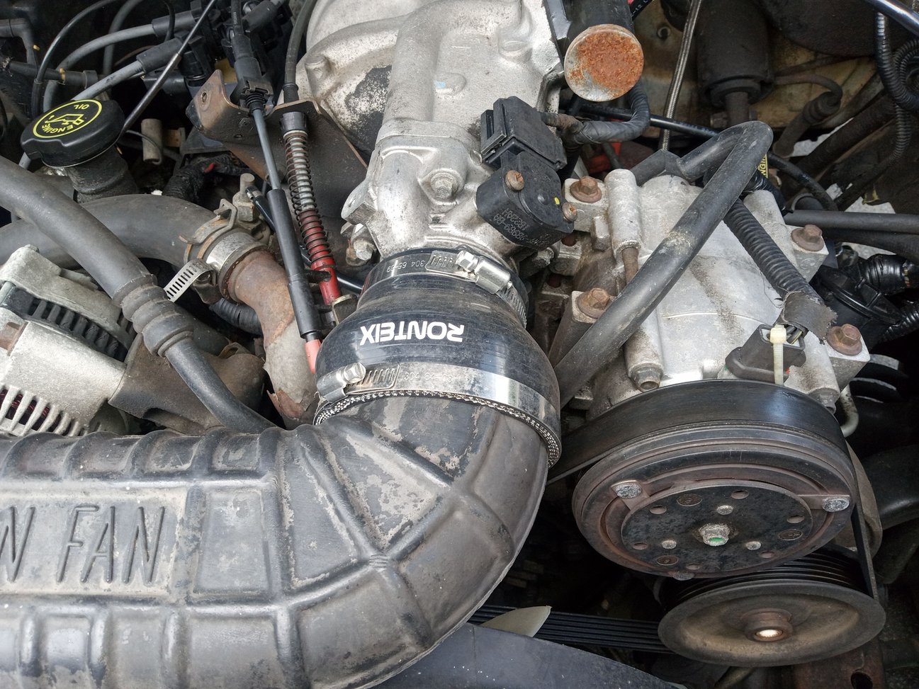

I hope this helps someone in my shoes. My air intake on the accordian parts was cracked and broken in places so i repaired mine like this after not finding any in junkyars or online. I used a little black silicone glue to seal it up internaly. Fits better on the intake side. The inter cooler tubes and be found on Amazon. "3" to "4" opening.
