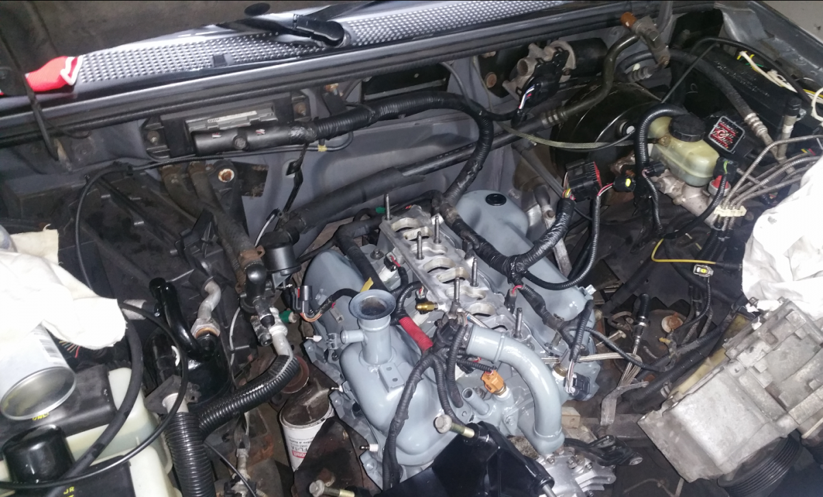

Hey Gaz I will probably build a new shortblock for my 2000 Ranger within the next few years to replace the tired stock 23k miler..I just replaced the heads on the old motor with 98TM style heads I ported and polished and am putting it all back together now..Also ported and polished the Lower intake which I was Amazed at how much I opened up the ports on it..Also bought a pair of SS JBA headers for it that I'm having ceramic coated right now.
What would the Compression ratio be if I went with a set of flat top SOHC 4.0 pistons in a new shortblock with these 98TM heads I ported? I already know I would go with a Comp 422 cam in the new shortblock.Looking toward the future because this stock motor has 235k miles on it so not sure how many more miles I will be able to get out of it.
