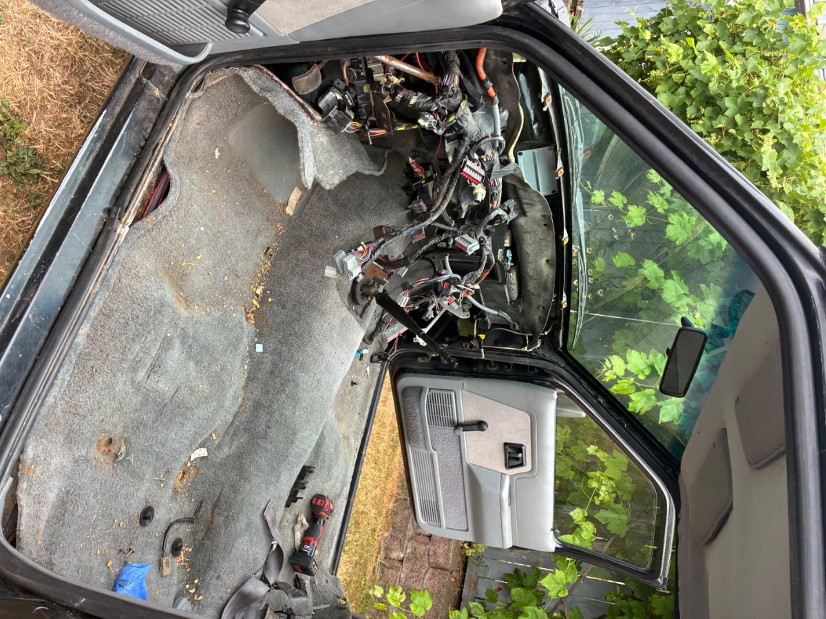

Starting on my 1991 ranger tdi build want to keep track of it and progress. I have 91 ranger 4x4 extended cab that I want to tdi swap and also do a full Jetta 2006 interior from the donor car which would include seats center console and Sasha s wheel as steering column
Pictures haha. Looking forward to seeing your build take place.
Currently have the hood off and stripped the interior waiting to get my buddy’s cherry picker to pull the old 4.0 other then that goal is to try and start getting the Jetta interior mocked up
