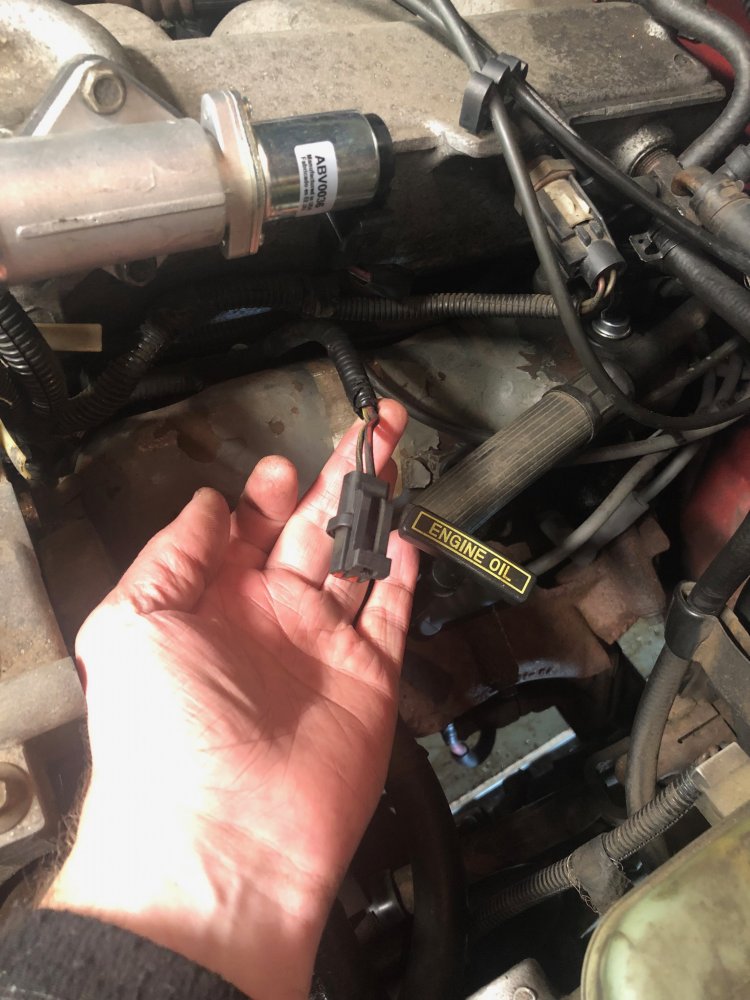

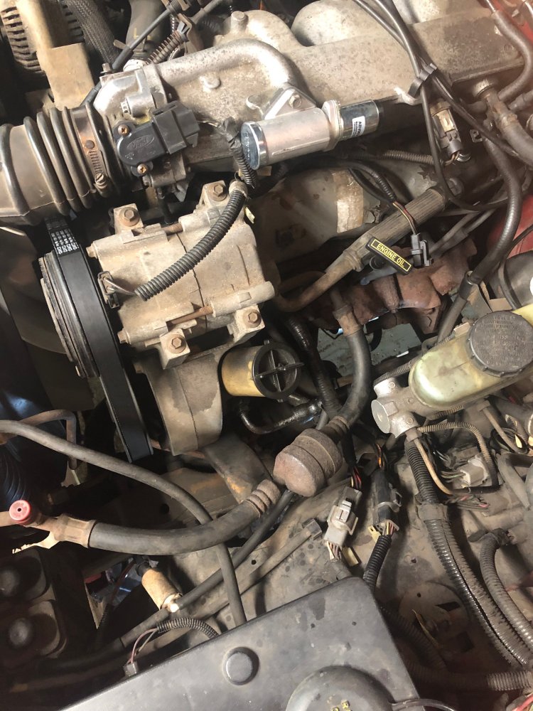

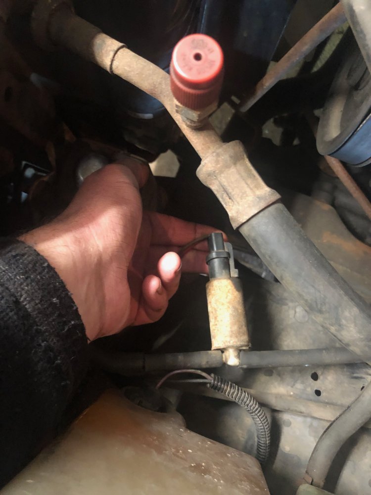

Any idea what this plug plugs into? One of the wires has continuity with the evap canister solenoid but neither has voltage while engine is running.
Thanks again!

Sorry don't know what it is. I never saw that wire on my truck. Could it be for an EGR valve of something.
