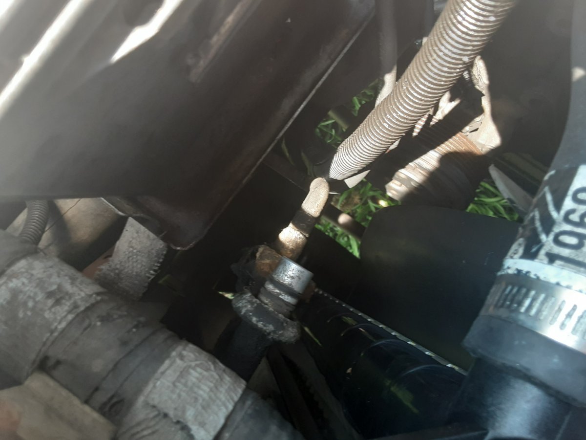

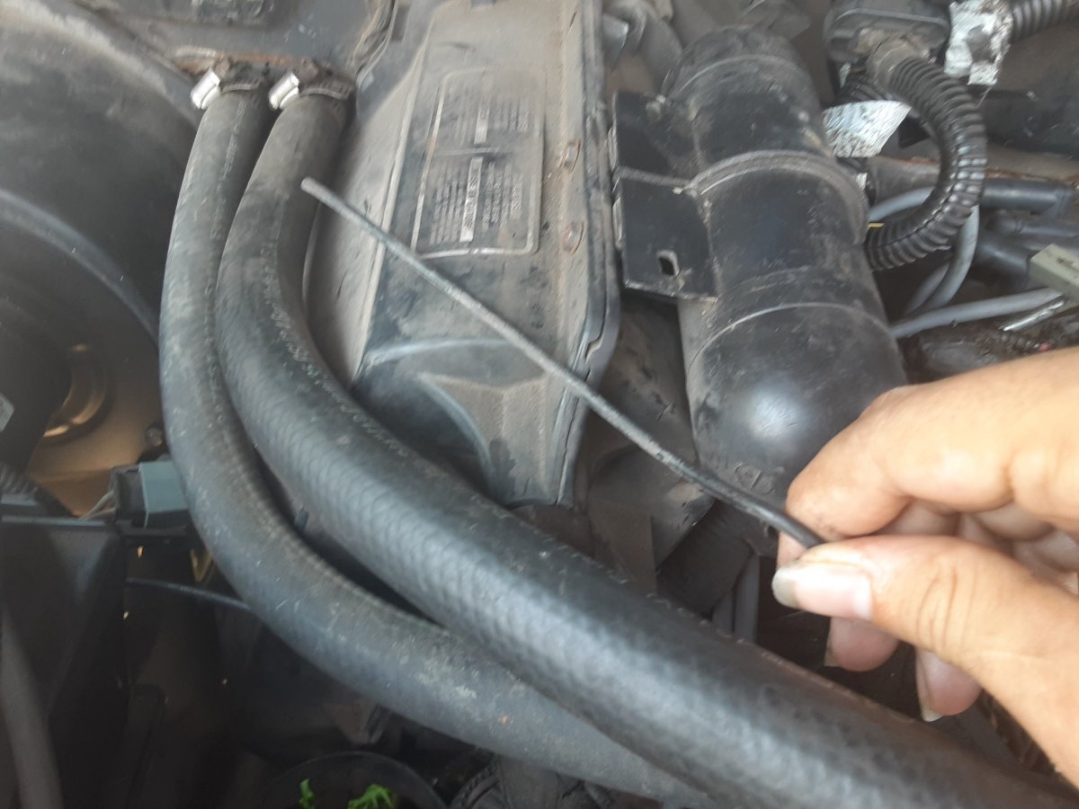

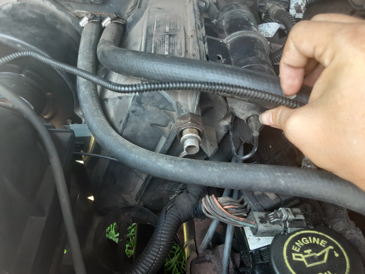

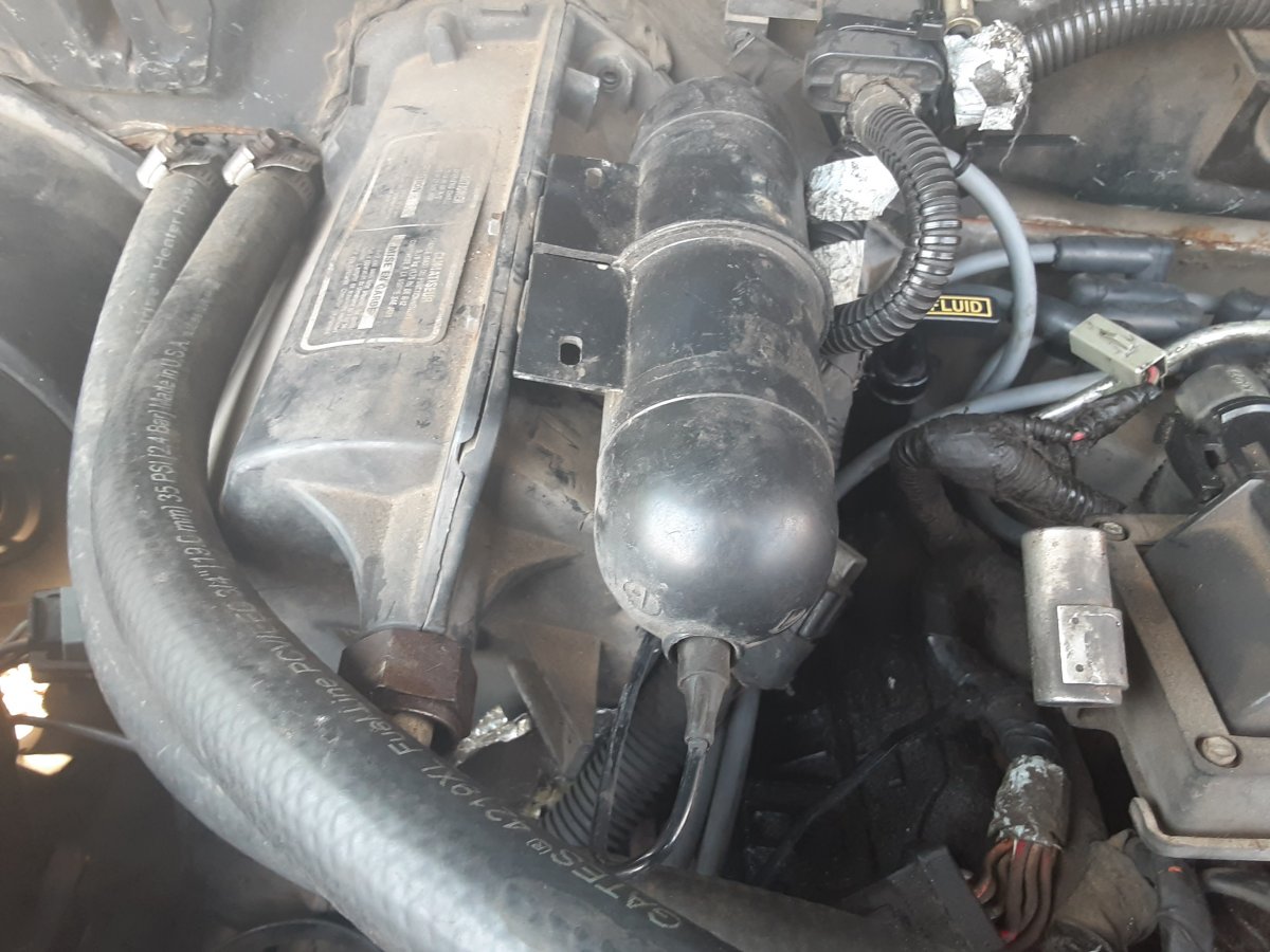

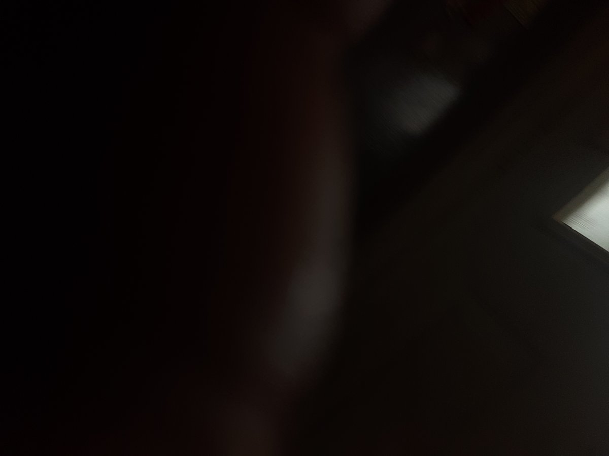

I took pictures of what is in my truck (at the firewall).
There's a black thing that sits on top of the evapator (I think it's called), that circular tube thing but no clue what it goes to.
1991 Ford Ranger AC Missing1991 Ford Ranger AC Missing1991 Ford Ranger AC Missing1991 Ford Ranger AC Missing1991 Ford Ranger AC Missing1991 Ford Ranger AC Missing
1st pic is the Vacuum reservoir, not used in 1991 by AC
2nd pic ?????
3rd pic top tube of Evaporator, should be one just under it at lower end of heater box, Orifice tube should be in lower one, I think
4th pic ?????
5th pic, broken vacuum line, nothing to do with AC
6th pic ?????

The 4th pic was suppose to be the housing (I think is the term) that the accumulator sits in (if the accumulator is a circular tube device that sits straight up).
I do not know what the 2nd pic is myself I think I uploaded the wrong picture.. same with the 6th pic.
So I shouldn't worry about the vacuum reservoir unit and cabling? Here I've been scrambling my head trying to figure out how it plays into the AC lol
No, no vacuum is used for AC in 1991, 1995 and up vacuum is used to operate Cab Vents, i.e. defrost, panel, floor, pre-1995 they are cable operated, sliders on dash

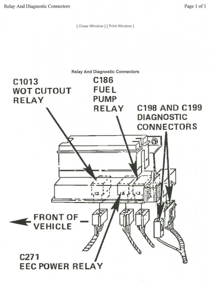

@RonD If I can ask, do you happen to know where the WOT for the AC Compressor is located?
I know that the knob that the AC Control Knob connects to has a purple wire and I've tracked said wire to under the main fuse panel with the 60 Amp Ignition, etc.
I honestly have no idea what this device looks like, but I want to confirm this is where the purple wire goes to.
I am having a hard time finding a replacement knob, so I was thinking of getting away with a simple On/Off switch to trigger the AC to kick on when I get the Accumalator and AC Line re-installed and get the main belt running over the AC Compressor again.
Previous owner ripped the AC Line, Accumalator out, and ran 2 belts to bypass the AC Compressor.
This is the only documentation I could find on the WOT.. I even search the Tech Library here but it seems there is no records of the WOT or I didn't look under the right category (I looked at Heating & Cooling, and Engine). The Wiring Diagrams has the WOT, but obviously it doesn't tell me where it's physically at under the hood.
Yes, should be with the Fuel Pump relay and EEC relay under the engine fuse box
Looks like this: https://www.explorerforum.com/forums/attachments/relay-jpg.35945/
Green is FP relay, Brown is EEC relay, Black is WOT relay
Don't see a purple wire in a 1991 on WOT relay
And dash AC on/off doesn't connect to WOT relay in any case, Computer controls WOT relay, and it only turns AC off, not ON
