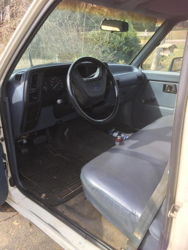

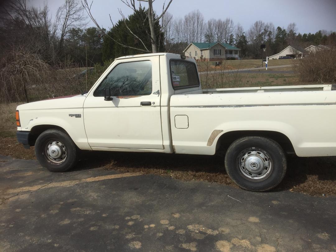

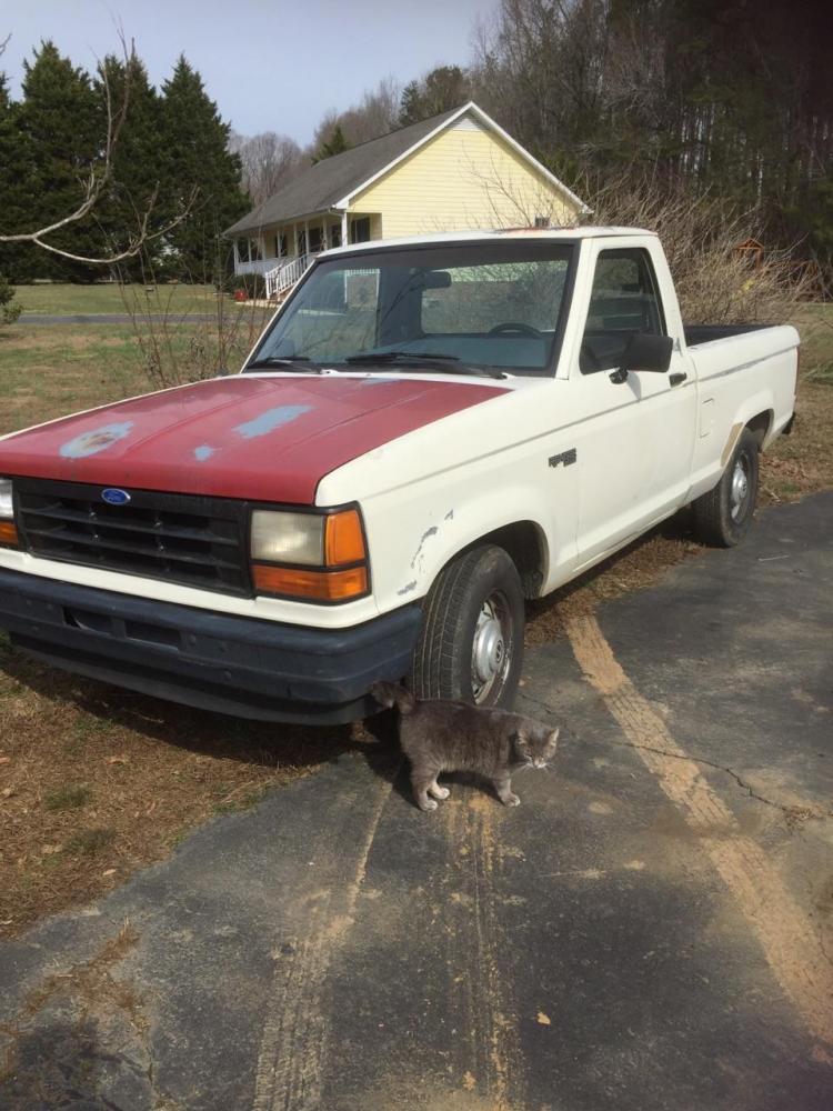

Thanks Andyb ... There was a pin but not as easy to find as the one shown in your pic.
I will post for all the other 1990 S reg cab folks. HOWEVER ...
Any of the replacements need to be modified. The electrical connected is about 3 or 4 inches too short. Ill take a pic of that too. This includes the Motorcraft replacement. I initially figured I could steal a little from the harness. But its is a 1" bundle of wires and I dont want to risk cutting something.
I scored NIB replacement side view mirrors. Paid $30 bucks for those. Exact fit. Did plugs cap and wires and tranny fluid yesterday.
Got brake parts on the way .. Ill do that total rebuild .. then this puff is road worthy.
Runs good for a $600 vehicle
