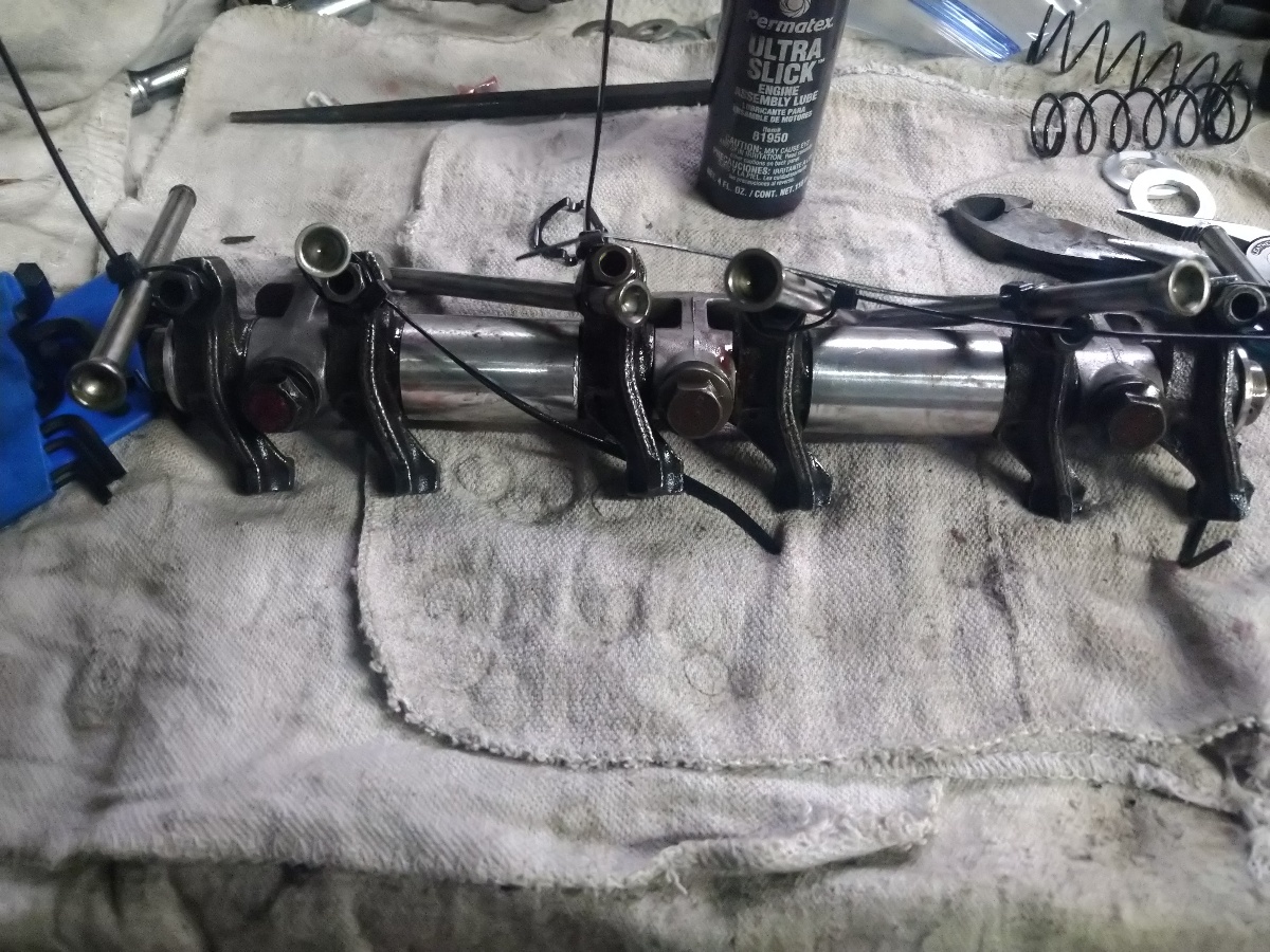

Free floating rockers and improved cam bearings both fix and prevent future problems.
Also, the oiling thing isn't as severe as people think.
In my experience, the lifter tick originates from soft cams. Theres some photos in my build thread that show how soft they really are.
Also, to fix oiling issues, check and clean out your rocker shafts. Valvetrain oiling relies on shaft bores being clean. They usually are not.

Oh yes, this seems to be the best route for my needs. Thanks again for all the info and insights. Now I wonder though, if I should replace my rockers and arms in the process, in case they did wear such as described in the write up you linked.
That looks easy enough. Just some tubing plus lathe work. How's it wearing?
@Nez'sRanger is running them. My pistons and rods are out for fitment atm.
They're still going strong! I think I mentioned it in a previous thread, but they didn't fix the ticking for me... I think the cam bearings are really bad. I've yet to check the free floaters, but I'm about to change the oil in prep for our lovely PA winter, so I'll let yinz know if I have aluminum shavings in the oil pan or filter.

But when you mention the "free floaters", do you mean the fabricated aluminum spacers?
I spent a few months in Pittsburgh back in late 2017 doing some contract work. I had forgotten the term "yinz"! Brought back some memories, but I did not forget the Dec/Jan weather...
Yes, my dad and I machined them out of aluminum stock on his lathe.
