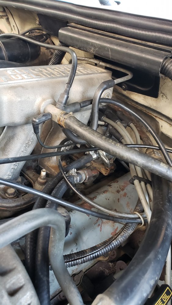

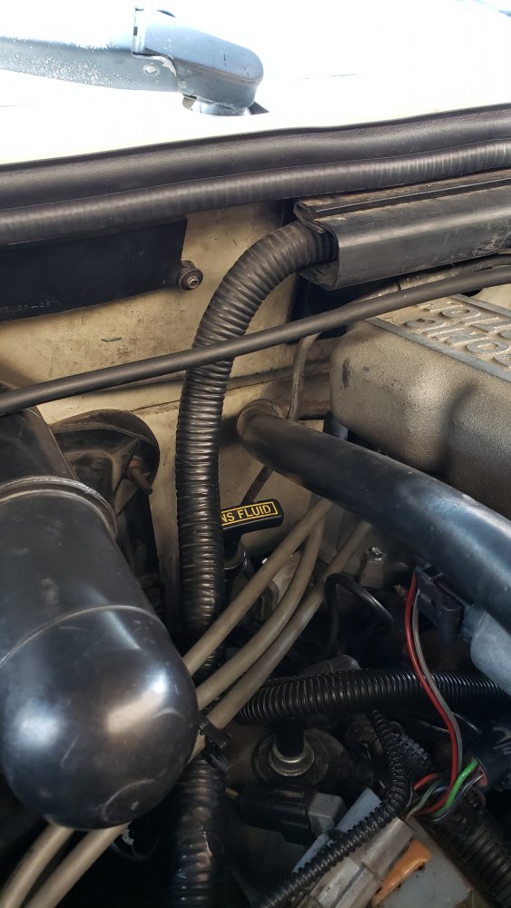

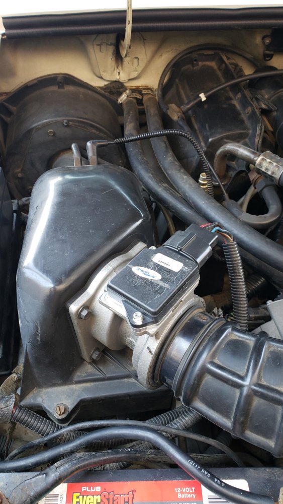

Sure, here goes, the MAF sensor (I previously replaced it), the location where normally speaking the MAP sensor would be on the firewall, and a pic of the other side of the engine for good measure:

They sure did change things around from year to year. I have a 1986 ranger with a 2.9 and it's MAP sensor is mounted on the pass side fender among st all that other junk over there.

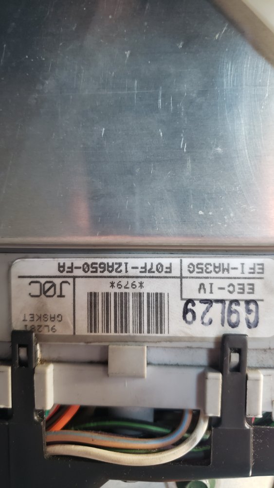

Can you also get a photo of the tags on your ecm? This was a nightmare when I tried to do the maf conversion. If I have the box and strategy codes, I can get the binaries.
Oh cool. I wasn't sure they had a MAF 2.9, but that looks like MAF to me
Yup. My '86 has it on the fender, but my '87 body does have the bracket on firewall
Sure thing. Actually, after posting the pic, I decided to get a used ECU with the same part no. off Ebay, something I had been meaning to do for a while. It was only $65 and has a 60 day return guarantee so, as soon as it arrives, I can make sure it works and have it on hand as a spare.
