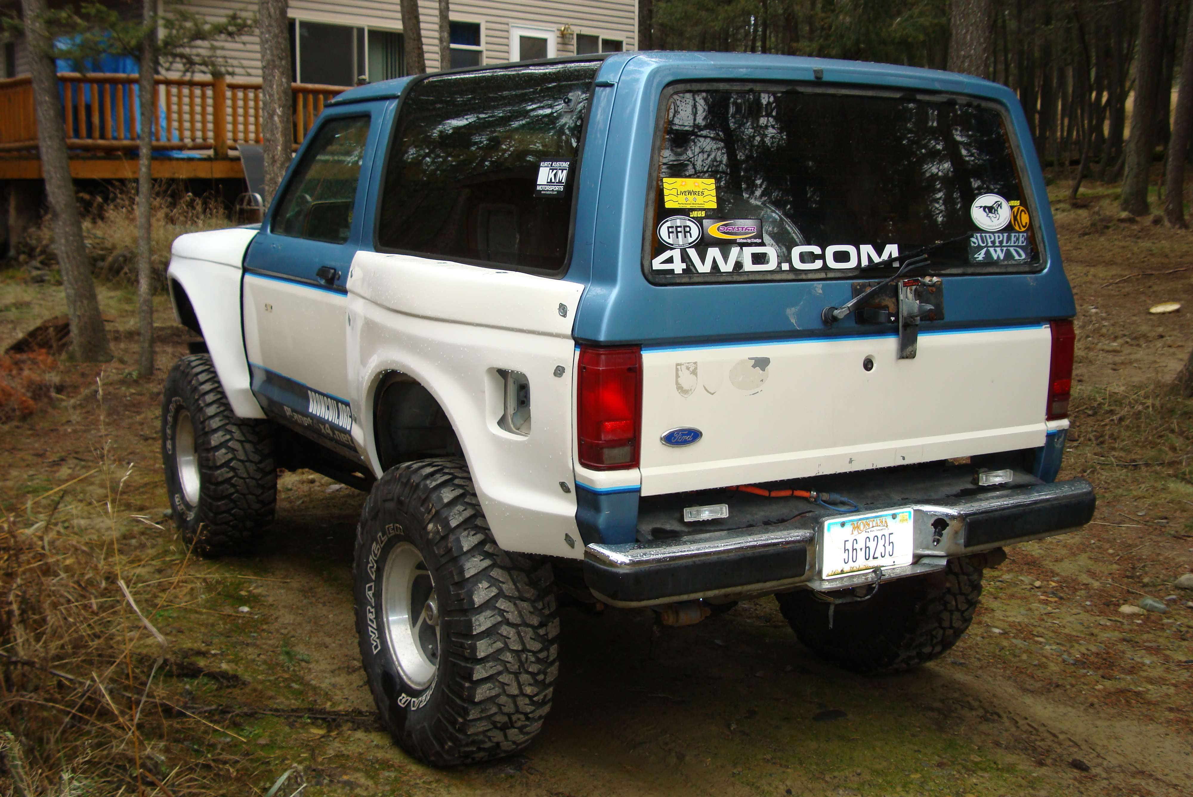

1989 B2 "TRAIL BUSTER" in the making

i am planning on slapping on my "PERRY"S FAB" 3" bulge fenders and quarters. they say that it will clear 33 with no lift. so i am thinking that with minimal lift it will clear 35's! I am also going to eventualy go with an SAS. but will just be a cherokee D35 i alrealy have it. i have a parts B2 that i am using for the mock up. Since this is my daily driver i dont want it to be tied up while i get everything figured out.
