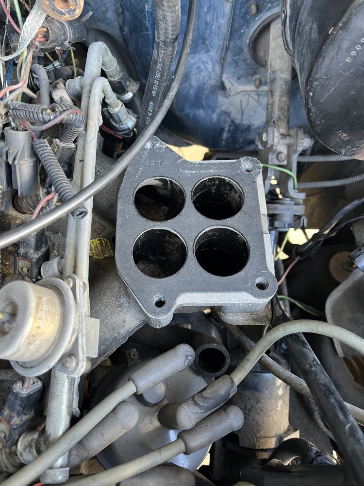

Took the intake off. Almost bare. Needs a good clean down.
Starting to get hot in AZ. Is 96 today.
Was in the garage this morning and pulled the exhaust, valve covers, and heads. As well as vacuum most the dust and dirt around the engine.
Lots of carbon buildup but the walls are smooth. Didn't ever turn it over yet since I got it just to be safe and glad I did.
I wasn't originally thinking about pulling the pistons and redoing everything but I may consider it. I have no idea how many miles are on this thing. Heads look good and golden brown so it's got that going for it.
May just say heck it and run it as well.

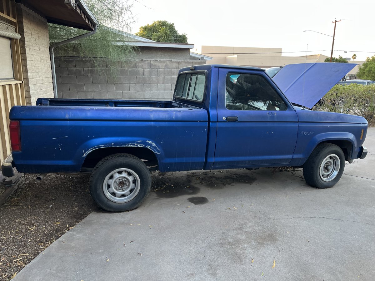

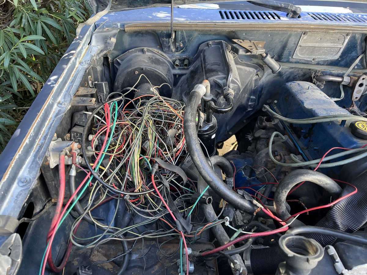

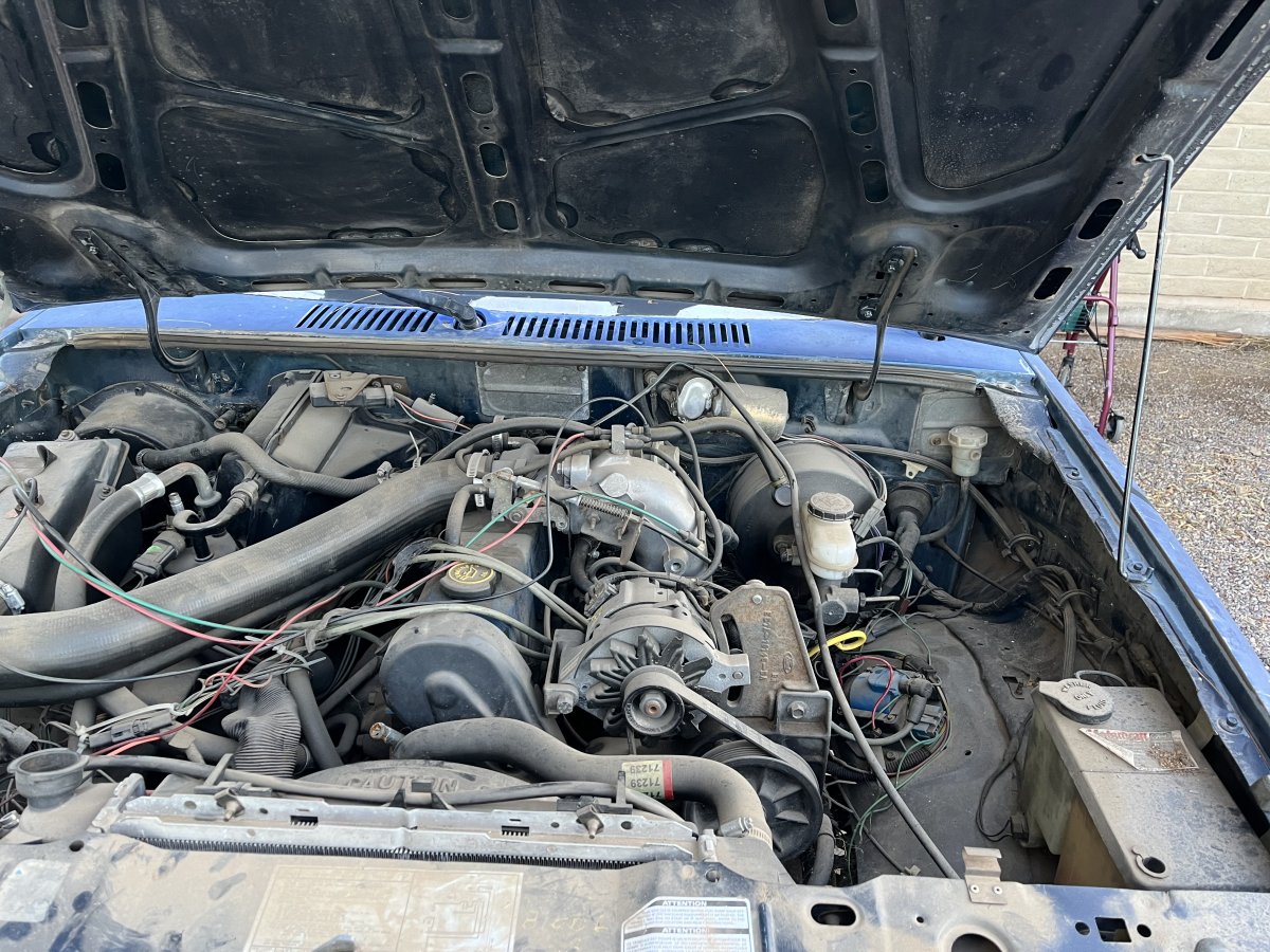

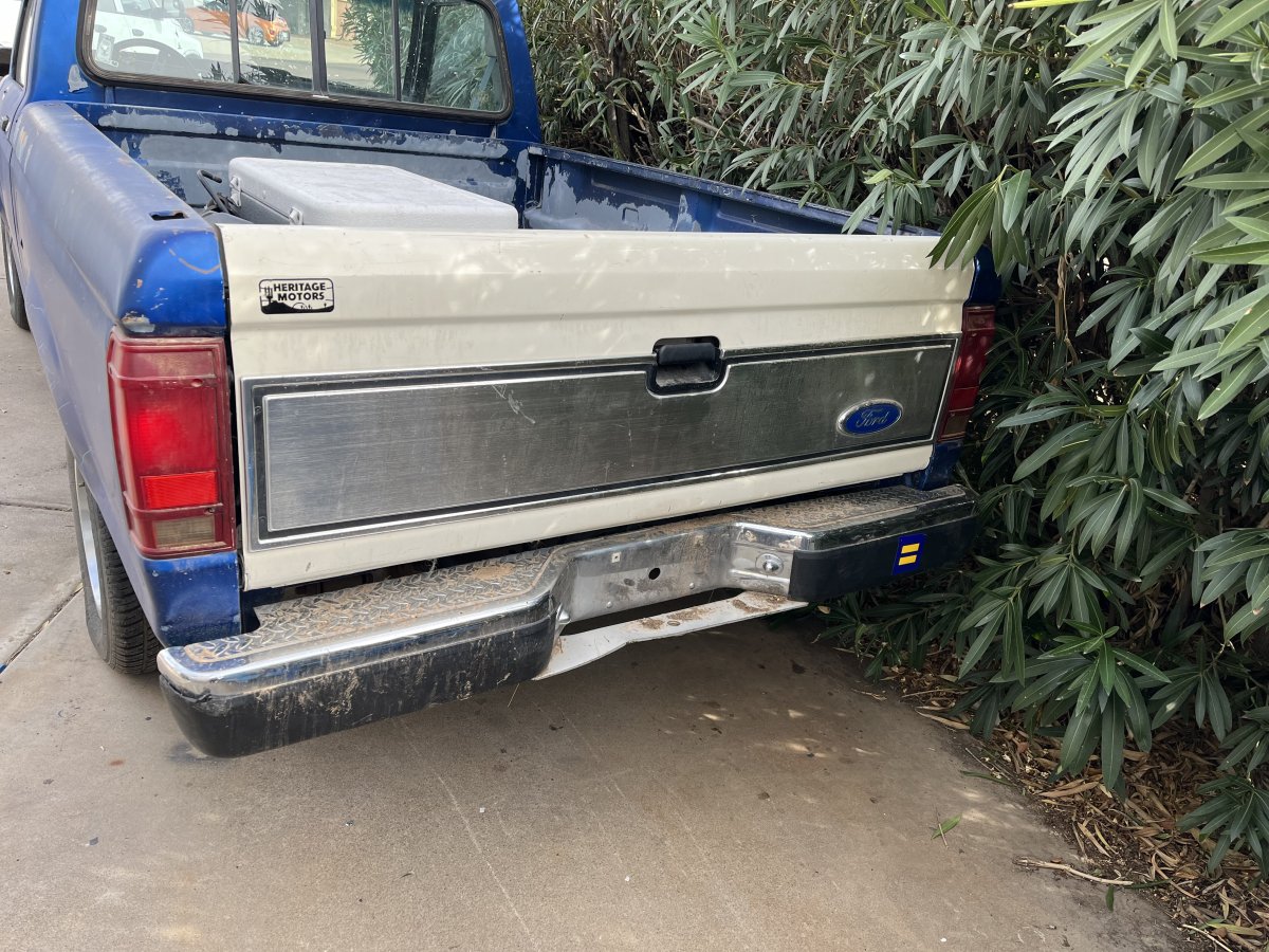

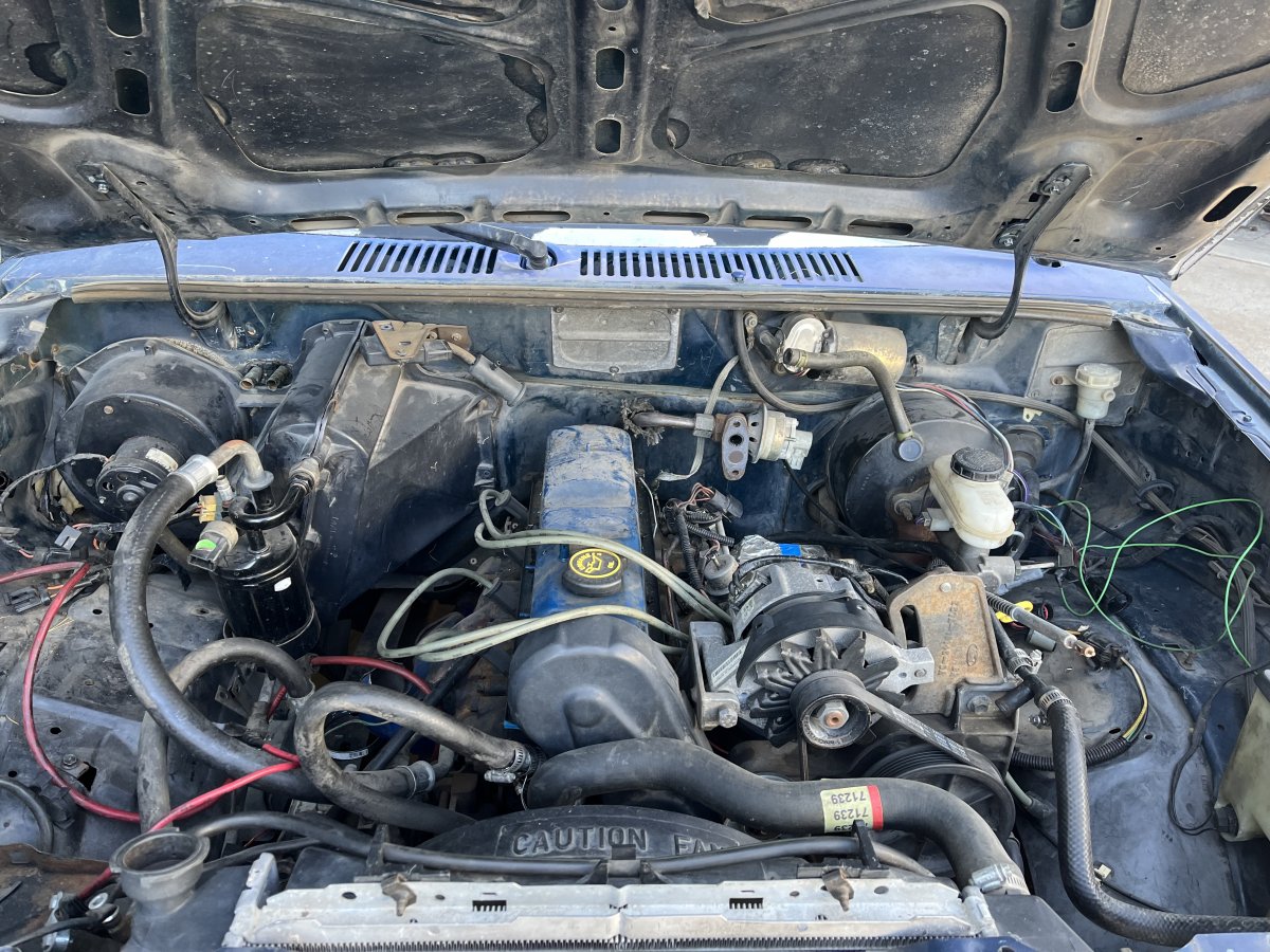

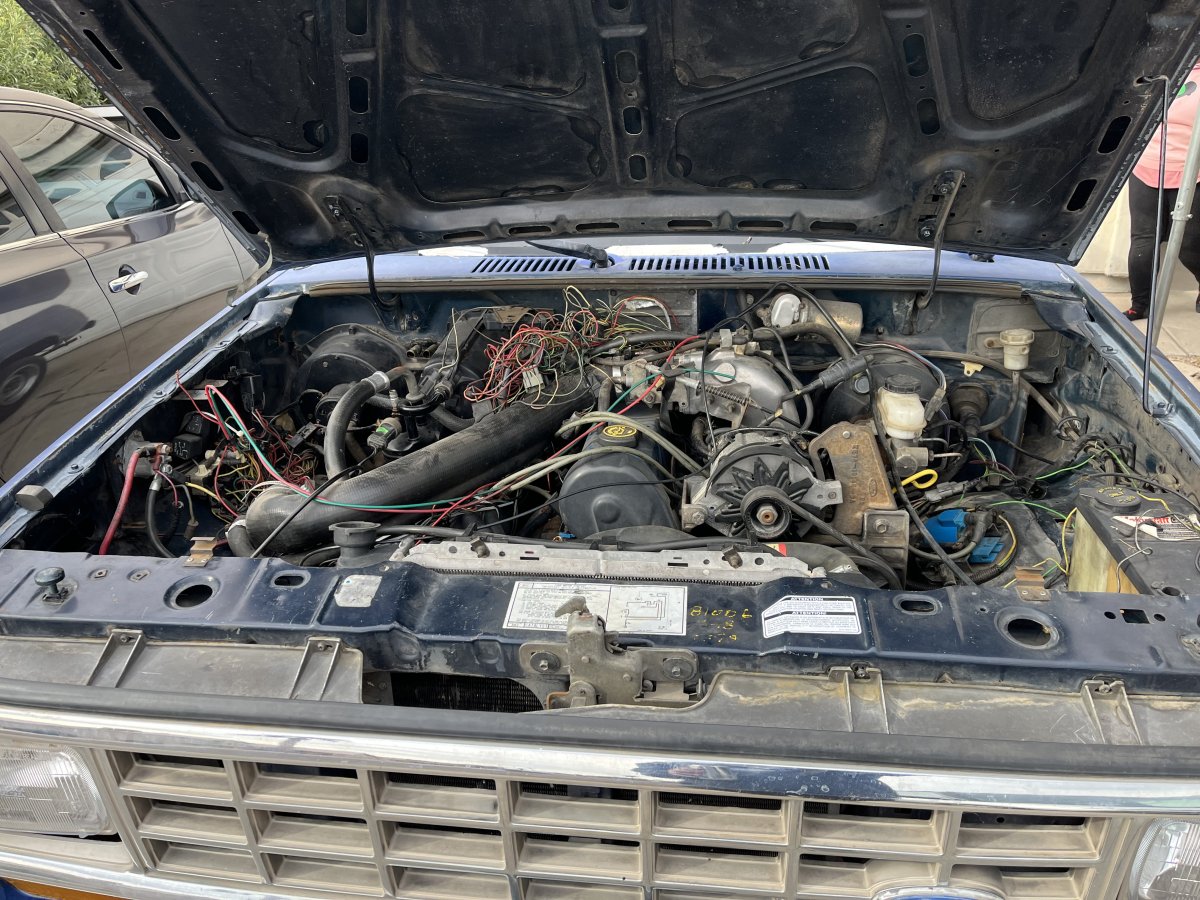

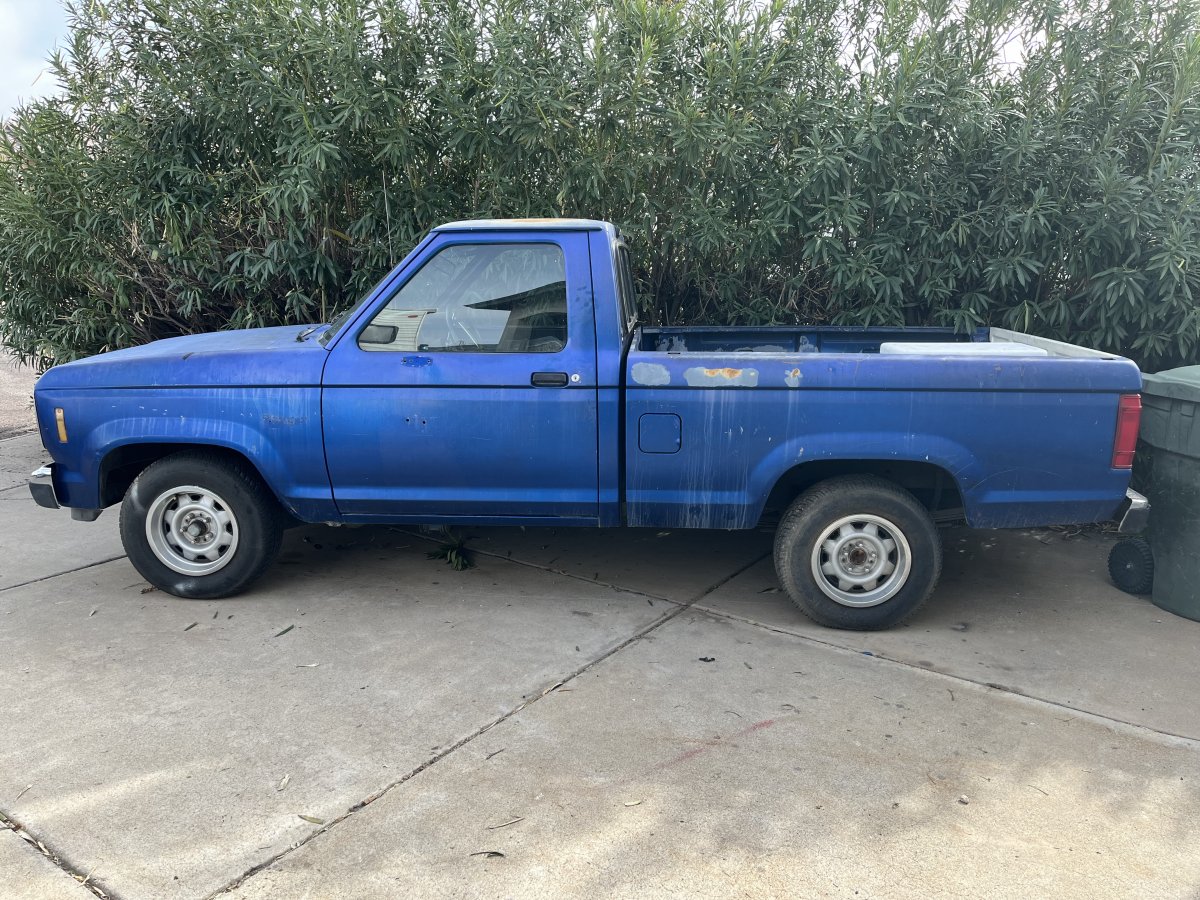

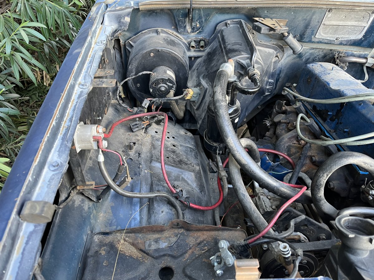

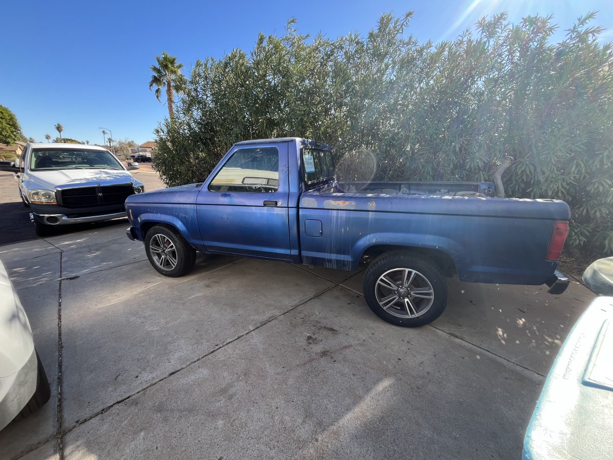

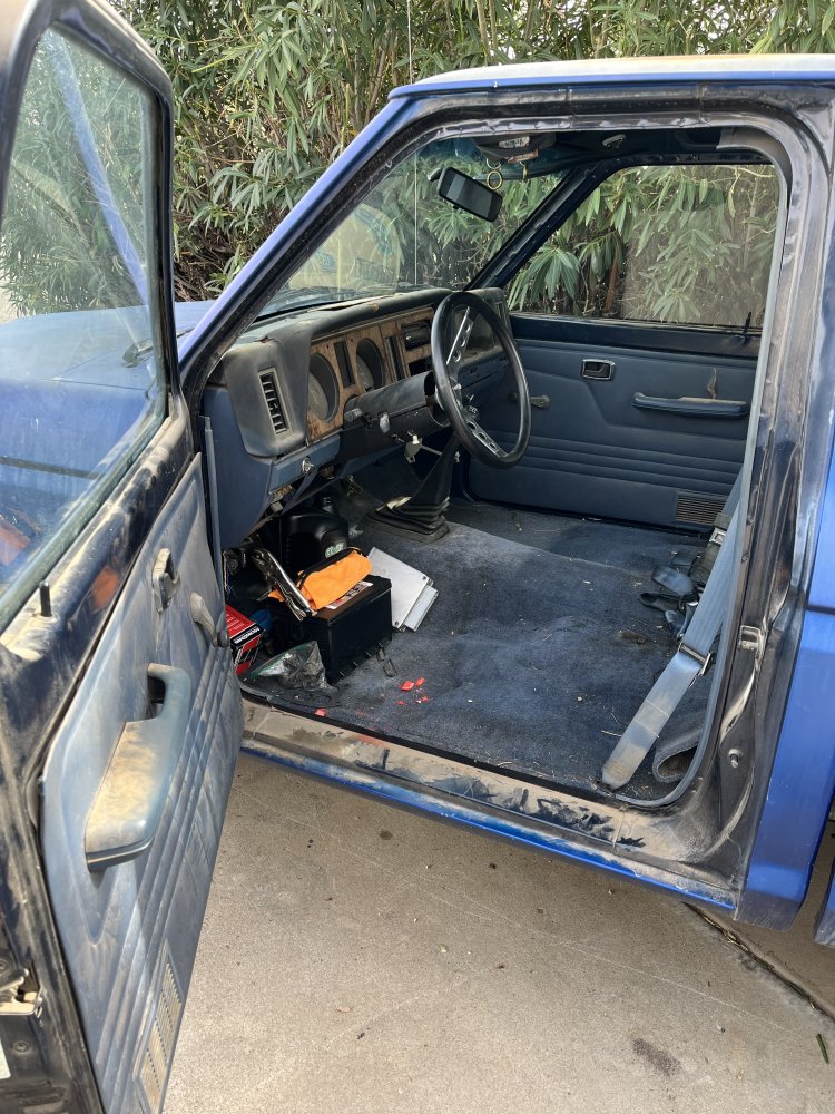

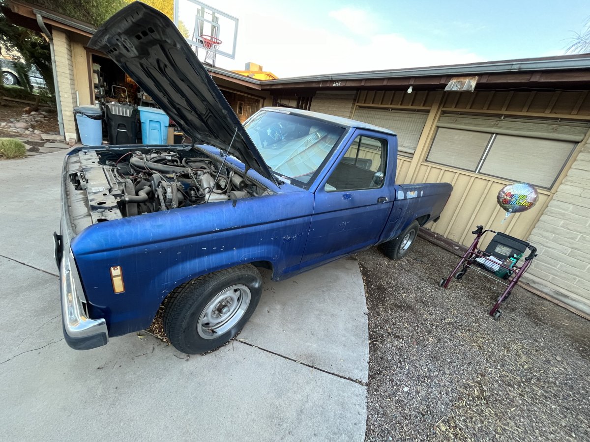

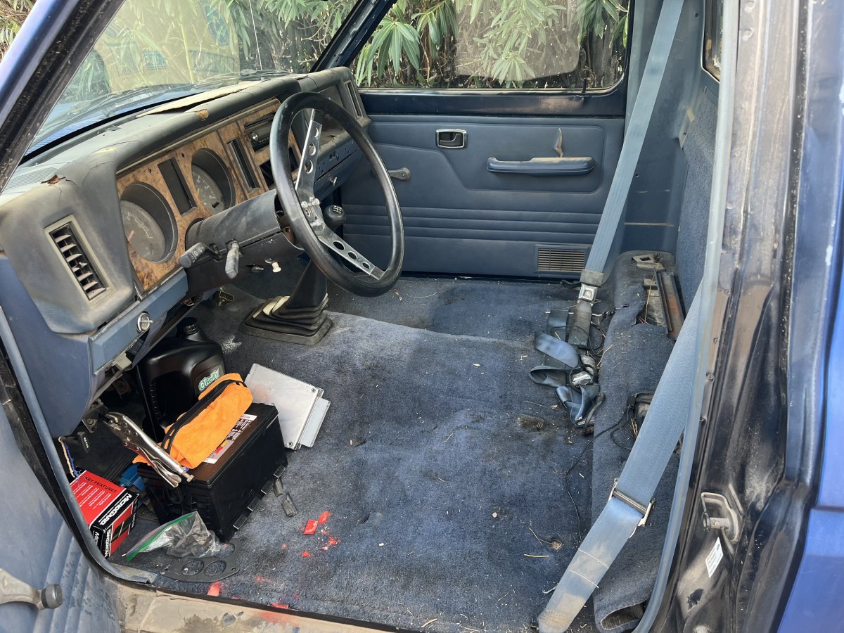

Hey all,

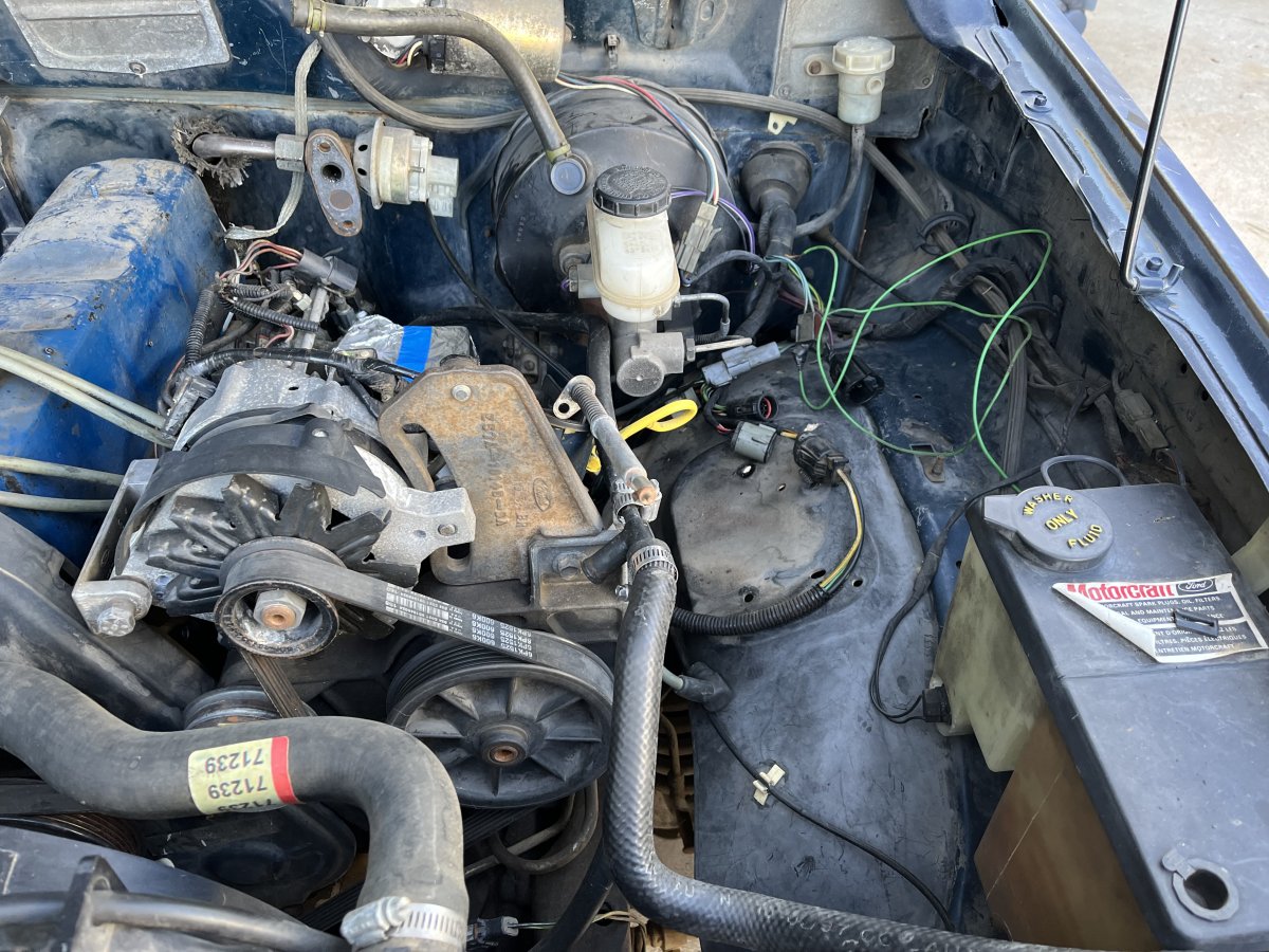

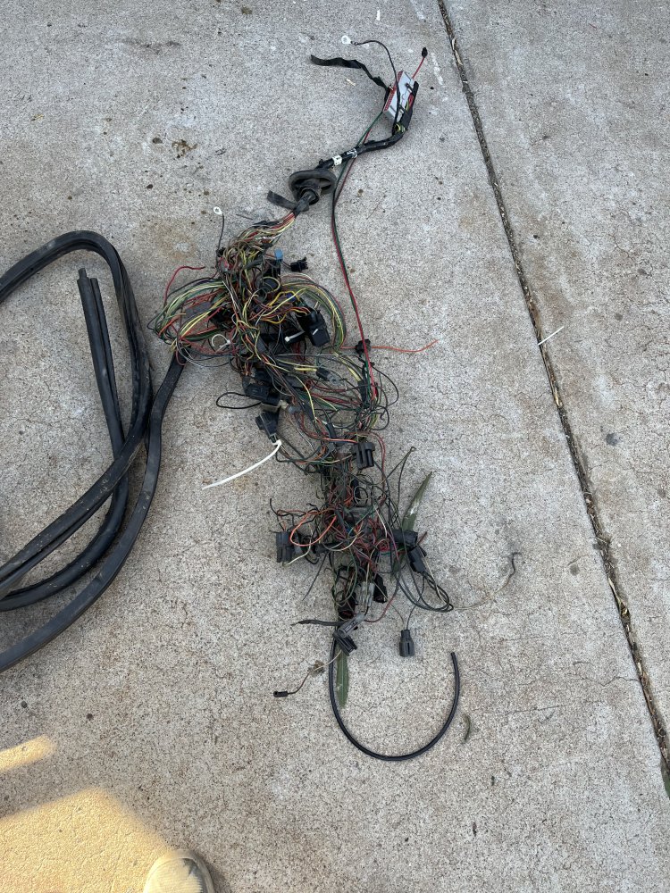

Recently got this XLT with a ruined wiring harness for a good deal. 1 owner vehicle in AZ so no rust other than surface.

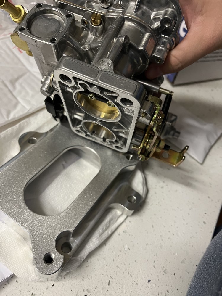

Currently in progress for carb swapping the 2.3.

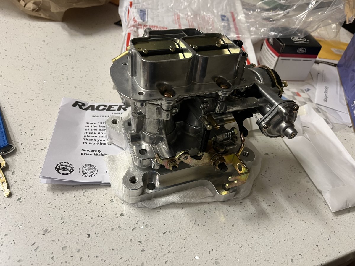

Parts list so far:
Weber 32/36
Racer Walsh adapter
Speedway motors distributor
Gm hei module
Pc-91 e coil
Fuel pressure regulator
Low pressure fuel sending unit (if needed)

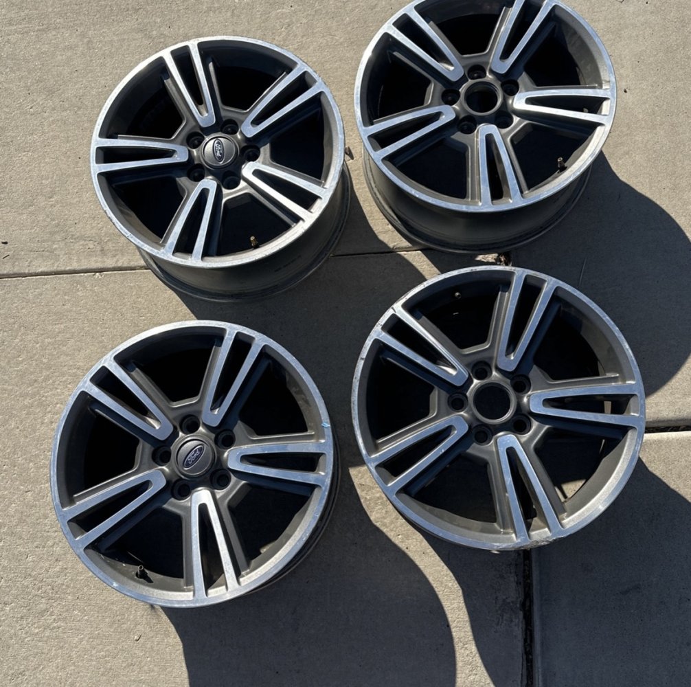

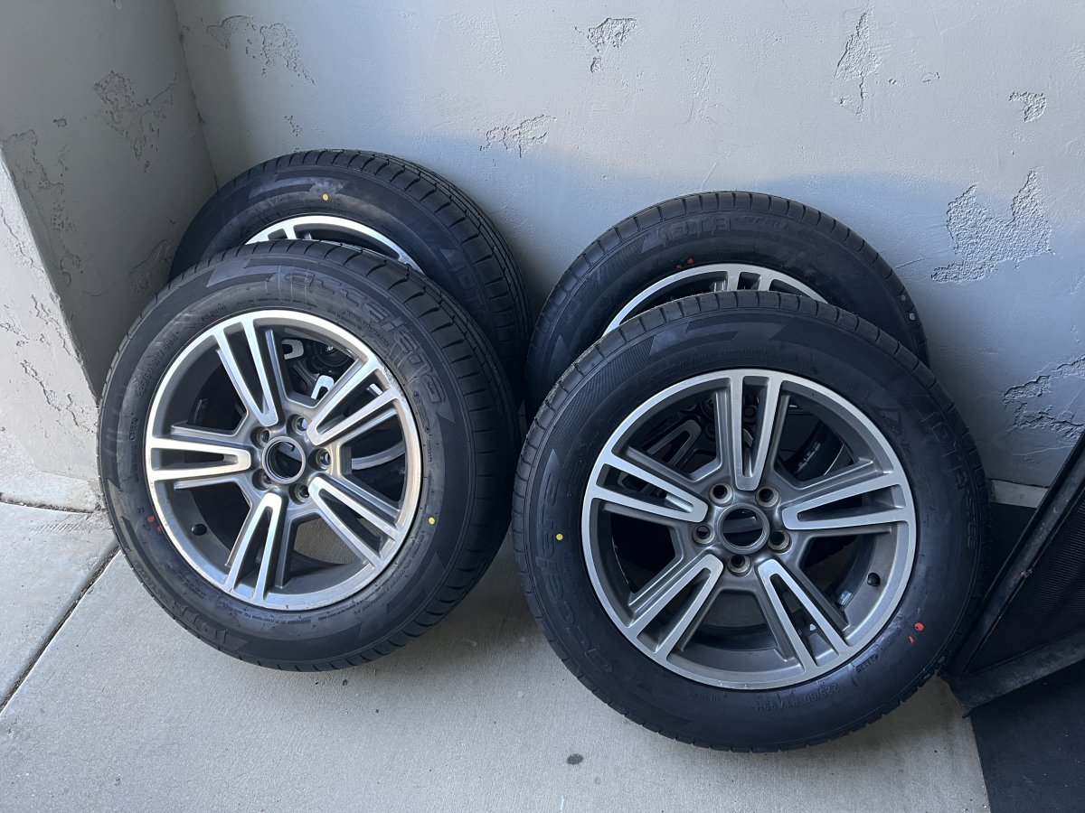

Spacers for rims
2011 ford mustang 17in rims
New spark plugs
New battery
Stuff for oil change
Misc parts

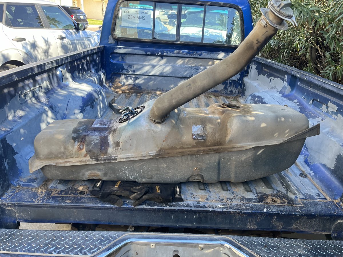

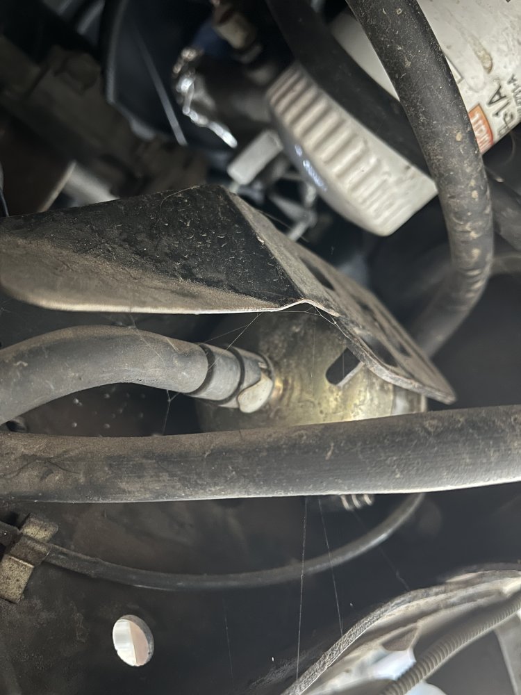

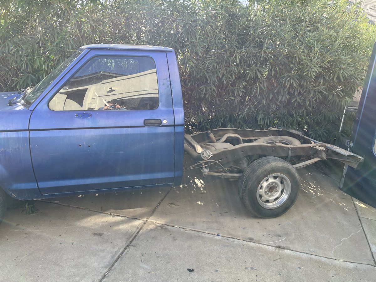

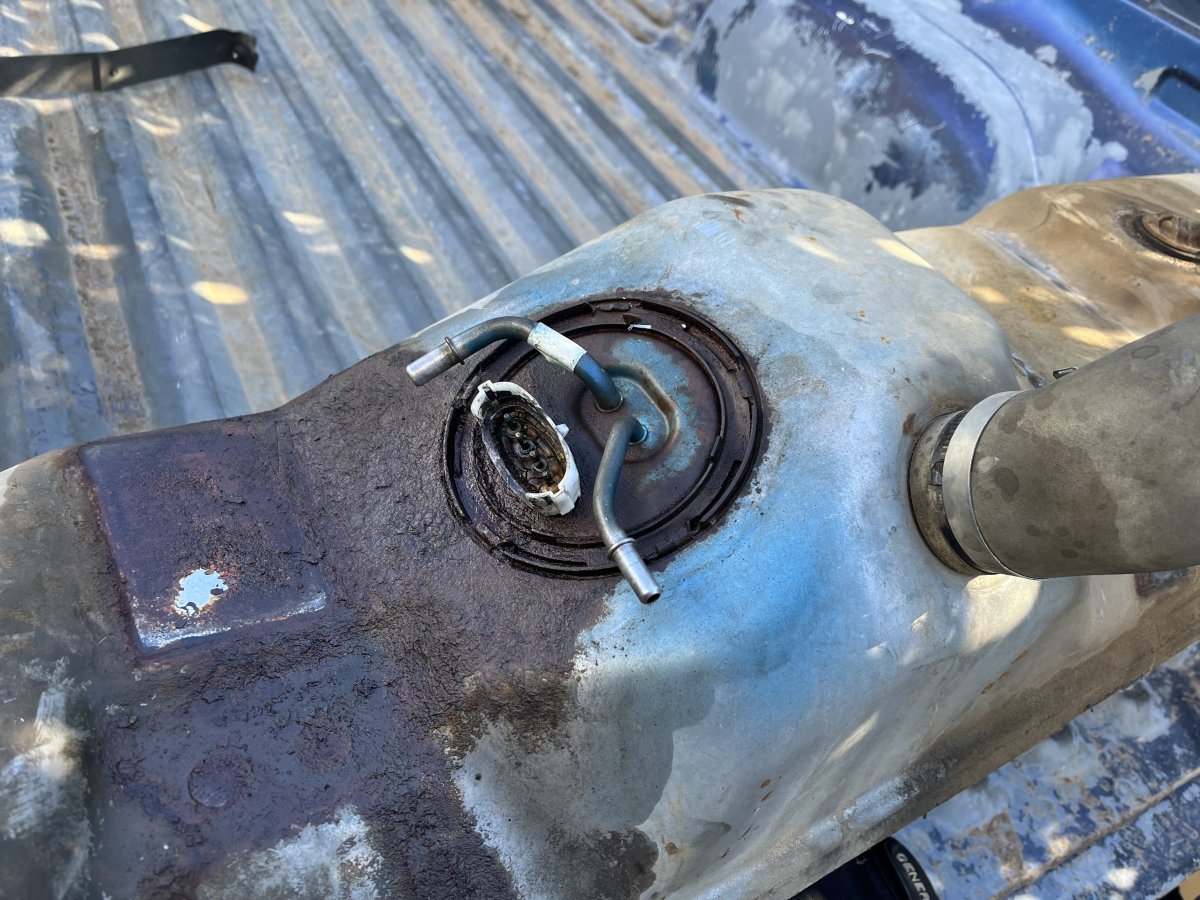

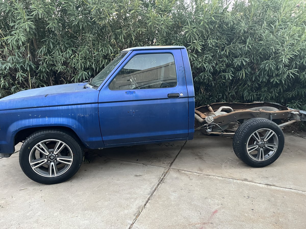

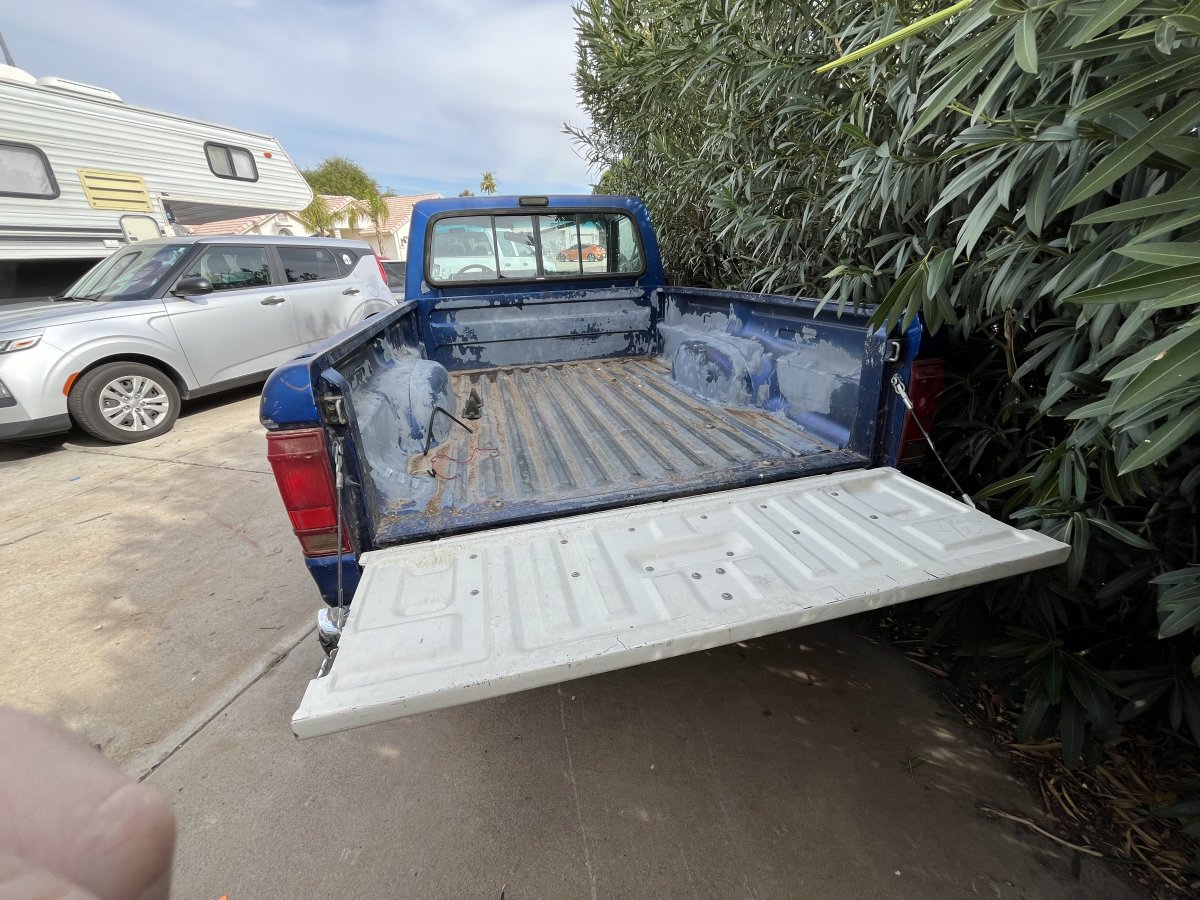

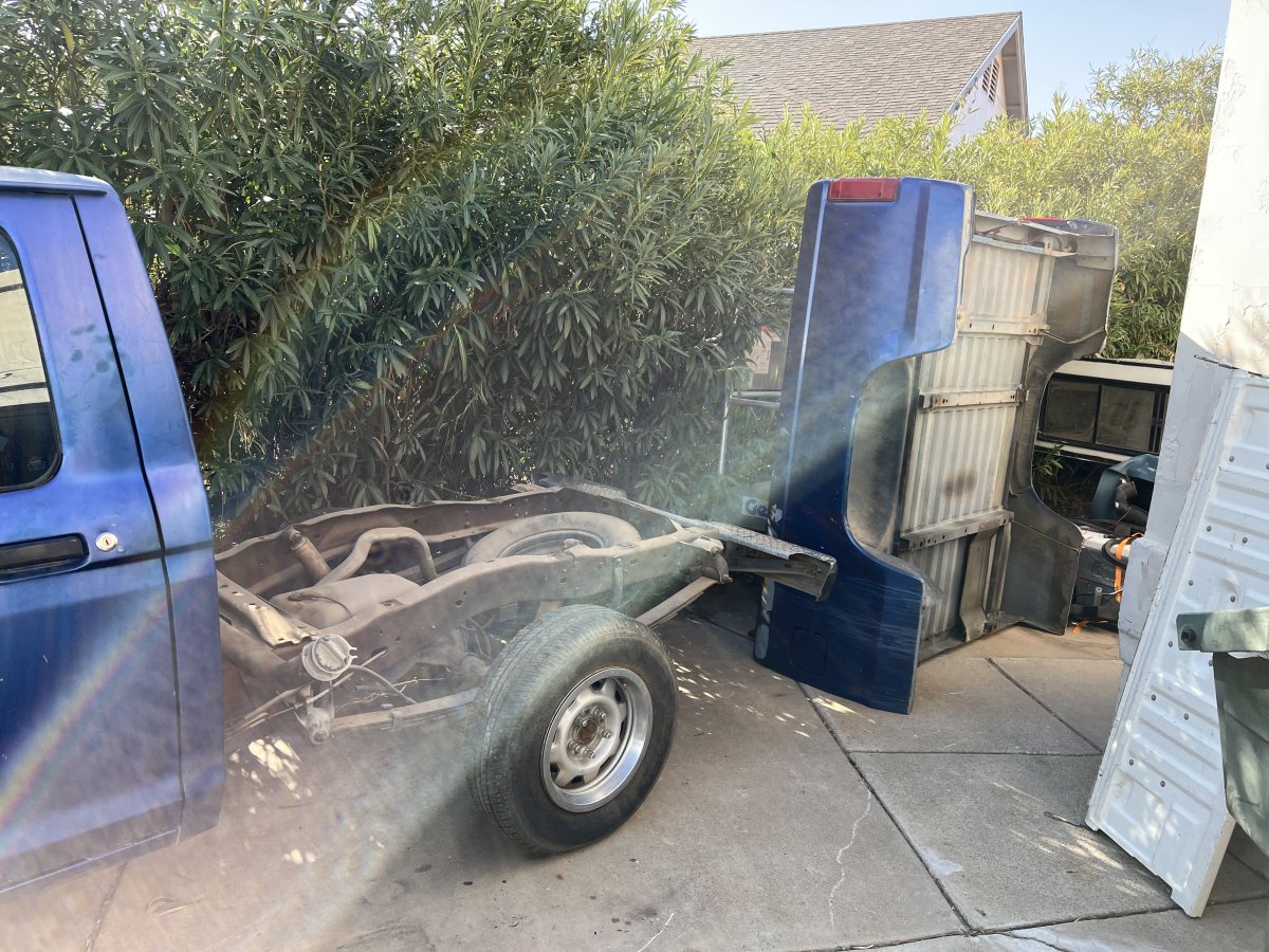

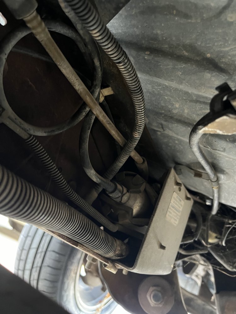

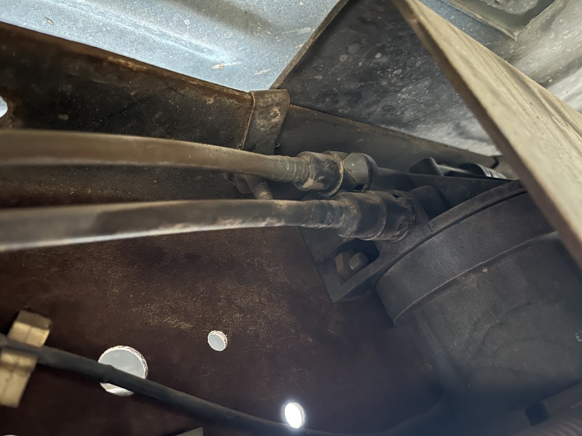

Today I took the bed off to get to the sending unit. It’s been sitting since 2019 so will also drain the gas.
Currently have it registered and insured under classic car insurance so in AZ I can skip emissions.

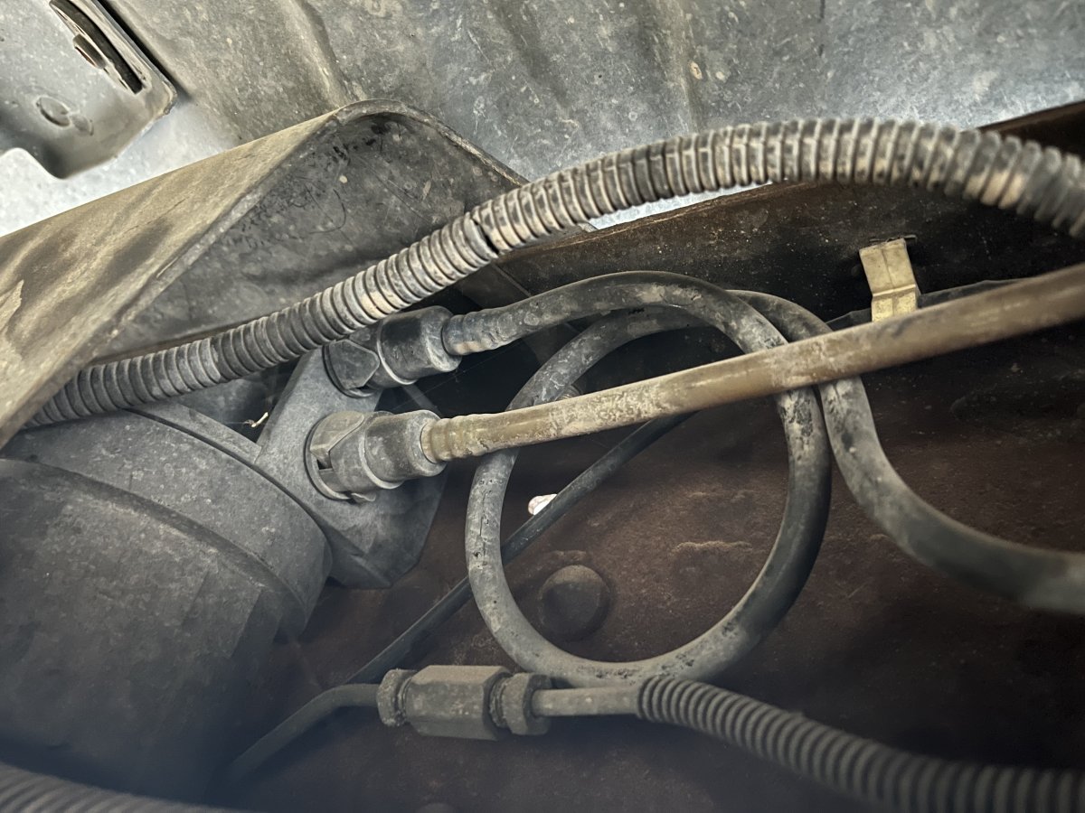

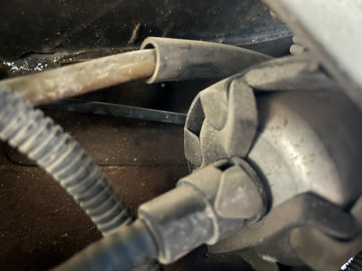

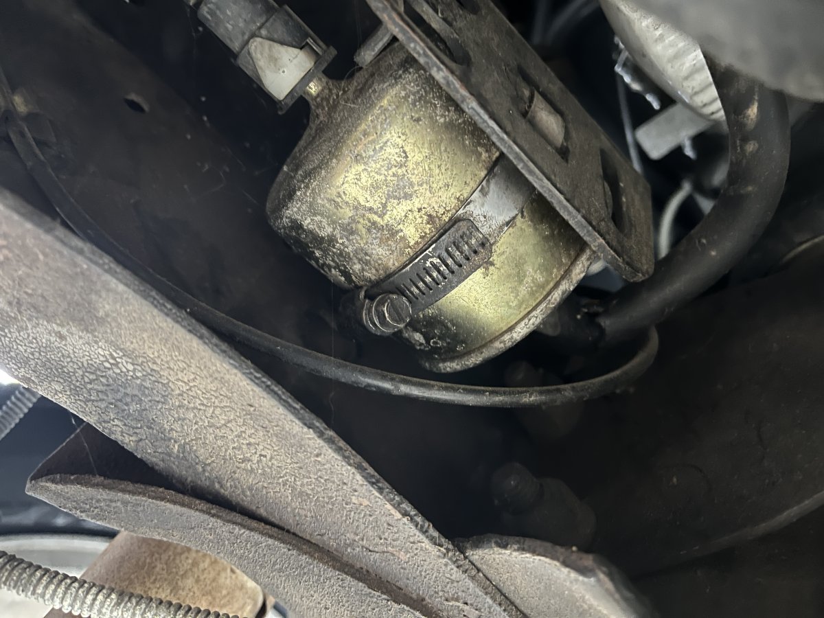

I know this might be a long shot, I got a ranger with same engine, only thing is it's missing something thats right next to the battery and it looks like a factory intake. I was wondering if you knew what it was because im completely lost. It looks like you have some sort of mesh tube with a hose clamp on it going somewhere I just need to know what its for

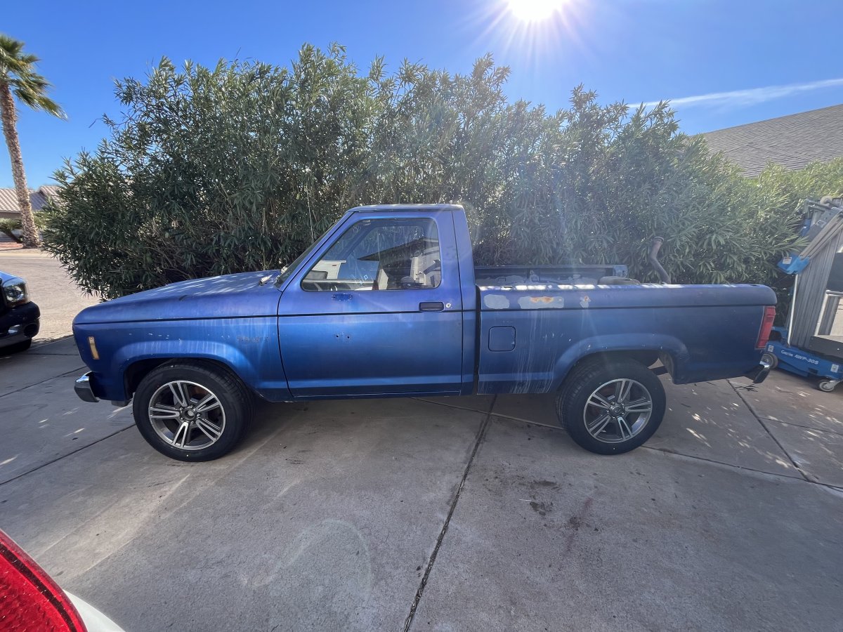

Wow I haven't been keeping up with this post for awhile now! I mostly post my stuff to my Facebook and Instagram but I've made a whole lot of progress.
The engines in and it runs and drives. I just need an exhaust made and some sensors for it but as it stands I did first fire up yesterday
Here's a video of how it is now
And I'll attach some progress pics over the last few months below going over getting the engine and trans together, getting them in the truck, swapping to manual steering box, and getting ready to get it running.
Went ahead and rebuilt the carb today and now it seems to be running like a completely different engine!
Before it wasnt running great and falling on its face but now it sounds like a proper v8.
Exhaust mostly done (good for now). Went with a y from the try ys to a single exit and a cherry bomb.
I consider it for now able to run and drive. Took around 9 months from pulling the head on the 4 cylinder to the v8 swap.

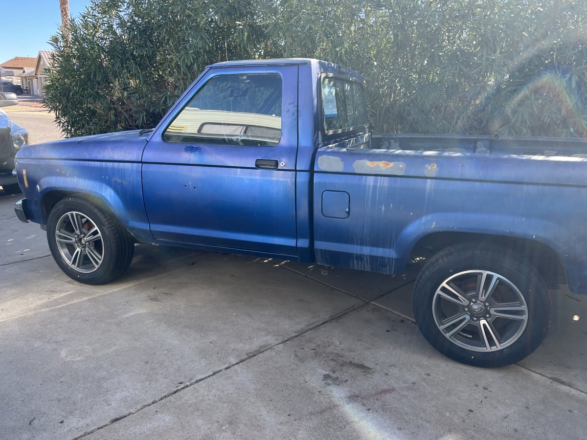

Did a 50 mile drive today to some light offroading and the range. Rode good no issues. Did highway and some hills without going above half temp even crawling along rocks.
2wd open dif 7.5 not great for anything deep or super rough but was still a lot of fun.
