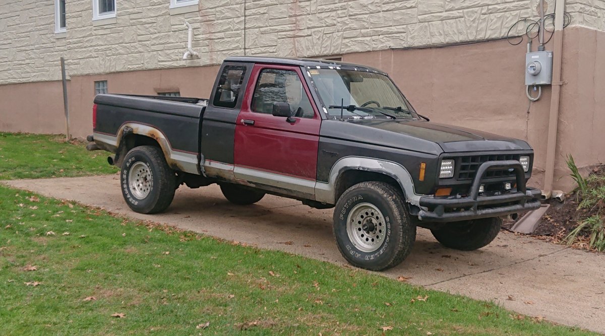

Been a while since I updated, so a brief word on ongoing work, and some other interesting things.
Had the cap off the other day to haul the scrap 4.0 and the D35 I'm swapping in for a front axle, so I snapped a photo.

Is it me or does your bed in this pic look like it is to far back/separated from the cab? Honestly its your truck have it how ever you like it but here in MA. we don't see many older rangers and being years since one of my step bro's had one, a 2.8 version, it could be my eyes being used to the 93+ models throwing me. Either way, cap no cap it has come a long way from the beginning of the build. Loving the rims since I had them on my first truck.
Oh, yeah, I only have 4/6 cab mounts. It only had 1/6 when I bought it, so sweet upgrades!
Seriously that things a ****ing mess. Frame is a little bendy as well. Not bent- yet, but the new drivers side rear cab mount bracket is 65% of that frame sections strength. Perfect candidate for a supercharger build.?

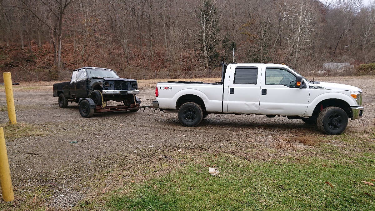

Forgot to post this as well:
Frame donor on its last ride
A shame I couldn't save this one; tree fell on it and demolished the roof.
But. Strong running 2.9 with world heads, rust-free frame, bed that's in better shape than mine, and cab support crossmembers I can use as a pattern to build new ones for mine. All in all, it's a win in my book for parts.

Come to think of it Petroleum Junkie I think I remember seeing your frame donor truck in the local Craigslist here in Pgh. Sad to see another old Ranger die but glad you got it and are able to use the parts off of it.
I see you're using a Ford Super Duty to tow it home with. Have you finally seen the light of the Blue Oval? ;)
Good eye with the parts truck, it's one in the same.
As far as the F350 is concerned, I've tried to trade it in twice now on a Dodge. Neither dealer would offer enough for it. (13500 for a F350 with 46k on it. Wtf.)
First chance I get I'm crushing the F350. Biggest piece of garbage I've ever driven. Gutless pig that gets 12mpg and the trans launches you out of your seat shifting 2 to 3. According to the dealer though, "There's nothing wrong with it" ?
