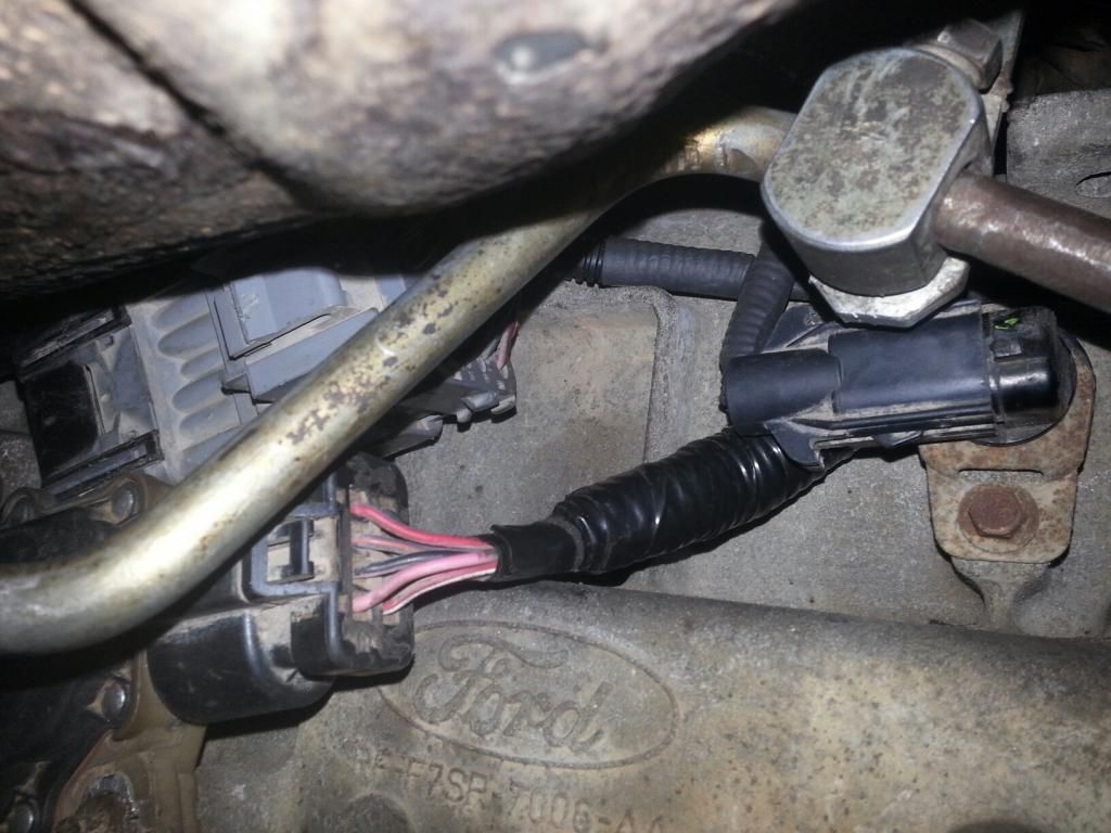

So I had a issue with the motor dies when you go in drive but not reverse.. Thant’s because I had a 96 motor harness and a 98 trans harness. I pit the 96 harness in, "all matching out of same vehicle, pcm and motor harness and trans harness", And it runs! I was able to drive it around, But the trans "hunted" for h
gears, I think it is starting out in 2nd gear, even if you manually put it in first, feels like 2nd. Put it in drive and moves along, feels like O/D is working, then it tries to down shift... Now, on the 96 trans harness there was a 2 wire plug extra,, I don’t know what that went to off the 96 Explorer?? Would that be a vss sensor at the trans spedo gear? Could this be the problem?
Or am I missing something off the C115 main plug, with 42 pins?? I did hook up the TC lock out up correctly, the pcm needs to see ground all the time until you touch the brake pedal. But I have not done the O/D lock out yet??

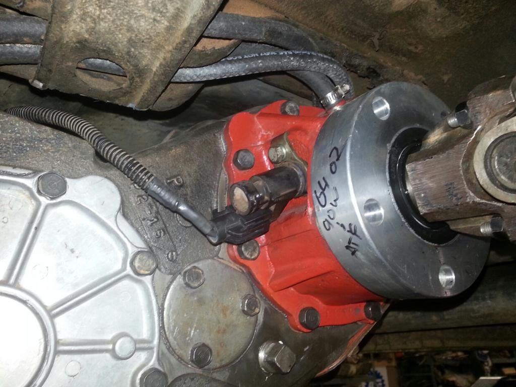

The 2 extra wires are the vss on the tailhoising. The ecu needs this to determine shift points, tc lockup, and engine load at different speeds...
SVT
Interesting! That makes total since! Ill head to lunch in a few,,, sneak down to the junk yard where I got the 96 harness and get the VSS and try that!! Ill keep you updated!

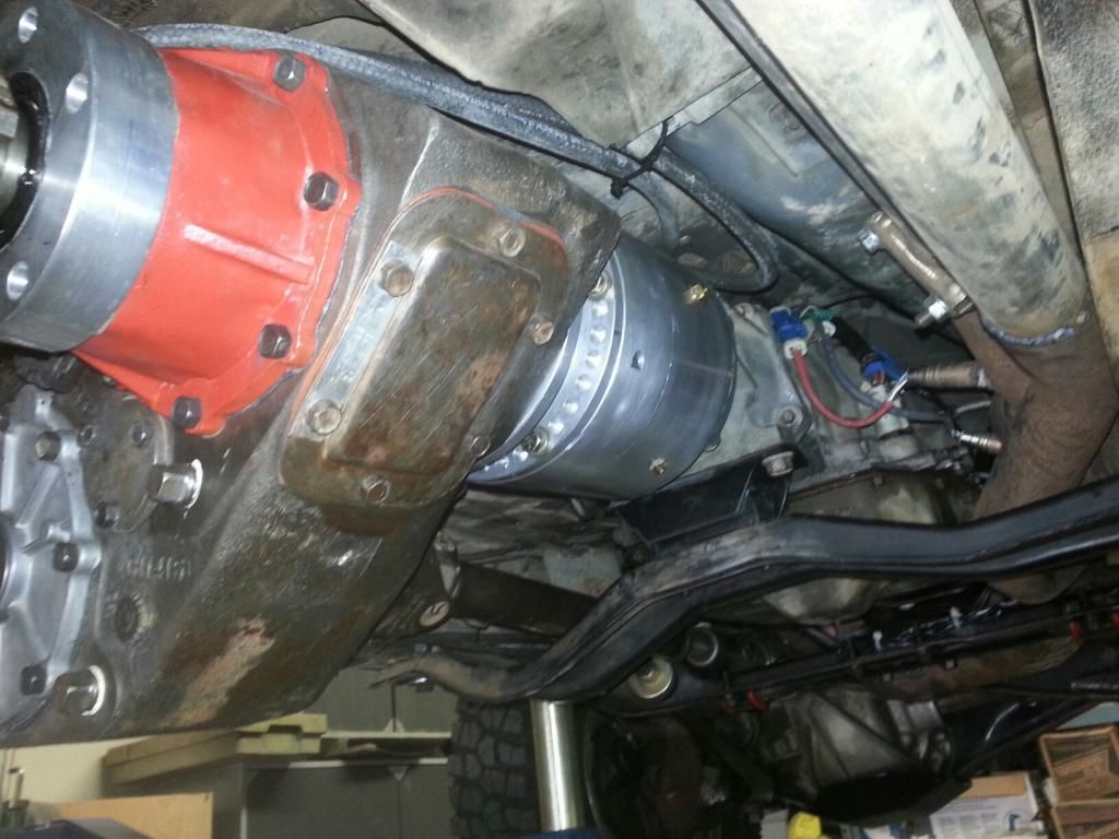

As for the Ranger, I have the VSS in, just need to extend the wires.. First thing tomorrow!!

Ok guys,,, Update… I did hook up the VSS in the rear of my np205. Verified pulse.. Took the truck for a drive,, same issue with shifting as before! I found on the Explorer forum that the pins in plug # C111 need to be swapped to match the 98 trans..
So to clarify that I am using in the Ranger,, 1998 motor and trans with a under drive and a NP 205 transfer case. Now,, with all the issues I have had,, I did get a 1996 motor and trans harness with the matching PCM and VSS sensor. Also the trans range selector switch.. So a 96 trans harness is different at plug # C111. So I swapped the pins around from the 96 harness to match the 98 C111. With the 2 power wires not used… Still have a shifting problem.
