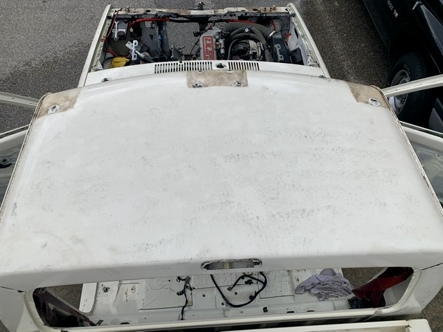

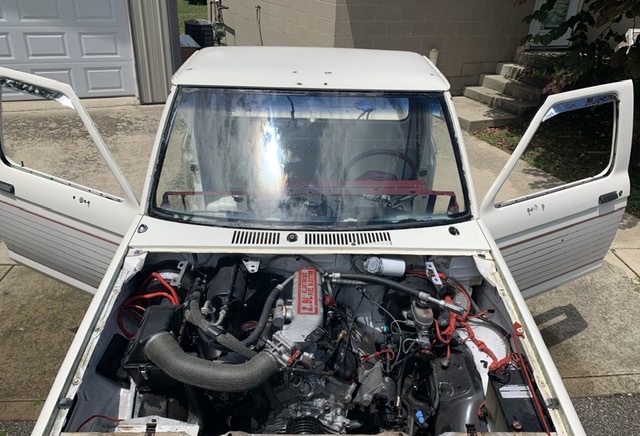

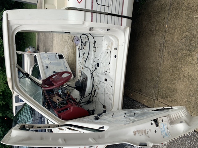

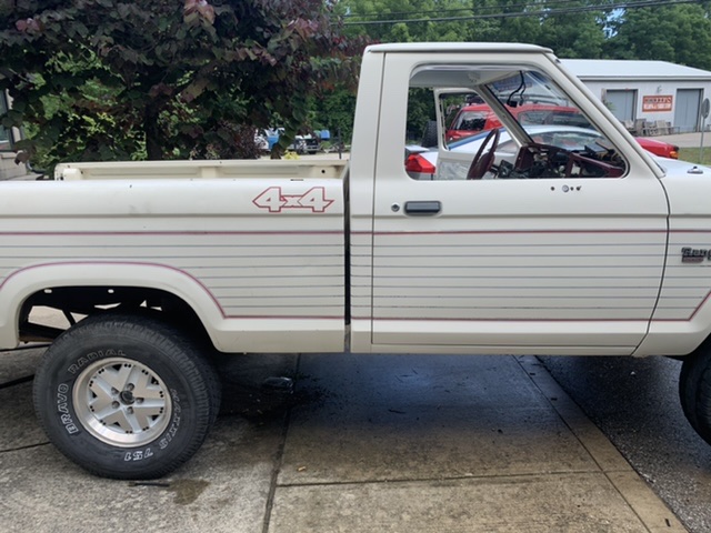

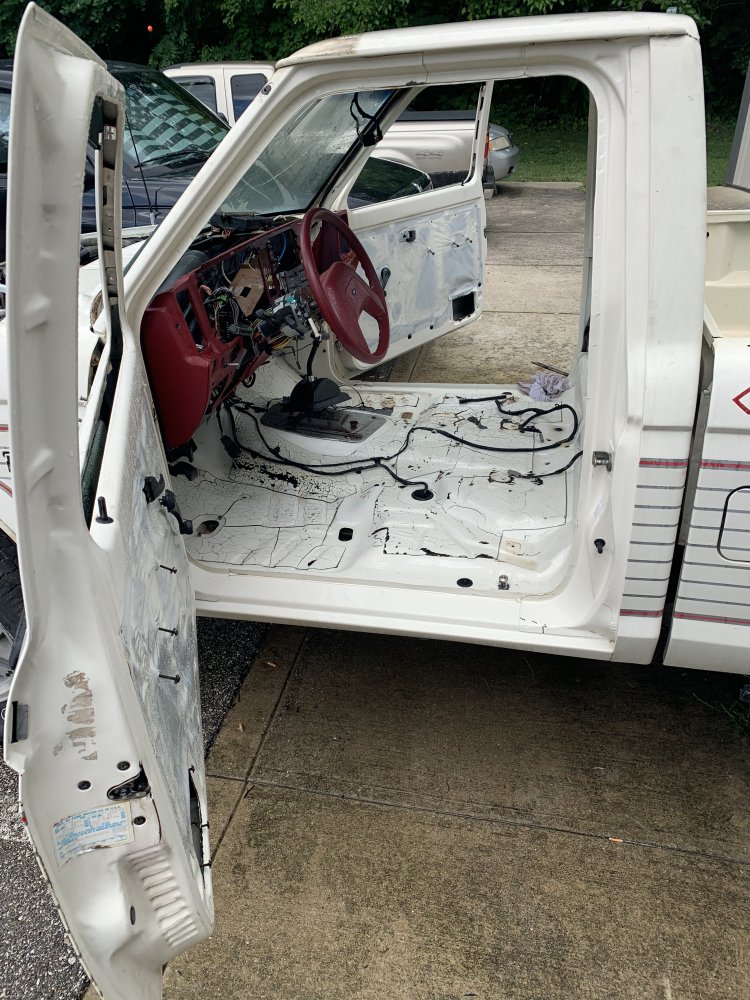

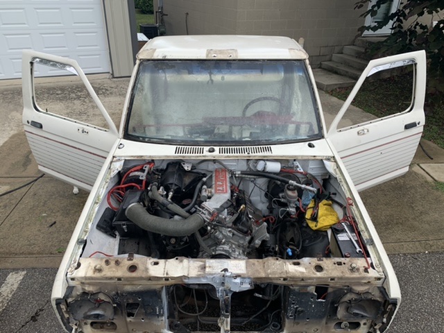

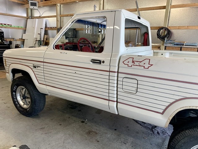

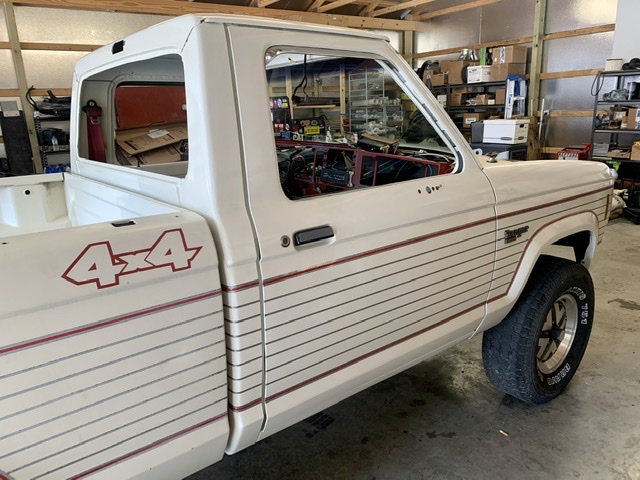

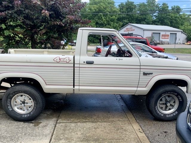

She (The Outlaw) got a simple green scrub bath today, interior and exterior of cab and fenders.
After a thorough drying I gave her a penetrol finish to to the exterior cab and fenders. I plan to remove the bed to access the fuel tank then clean and penetrol it as well as rust treat the frame in the near future.
Tomorrow will be cab seam sealing with white POR15 on the small existing trouble seam spots and any potential issue seams.

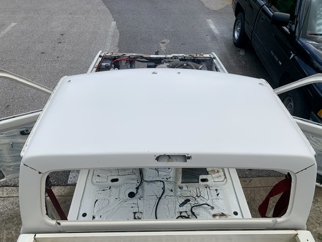

Ugh I hate the holes from the moon visor thing. At least you still have it and it's in good shape so you don't have to patch them. I hate when people drill or cut holes in the roof of anything, sunroofs especially.

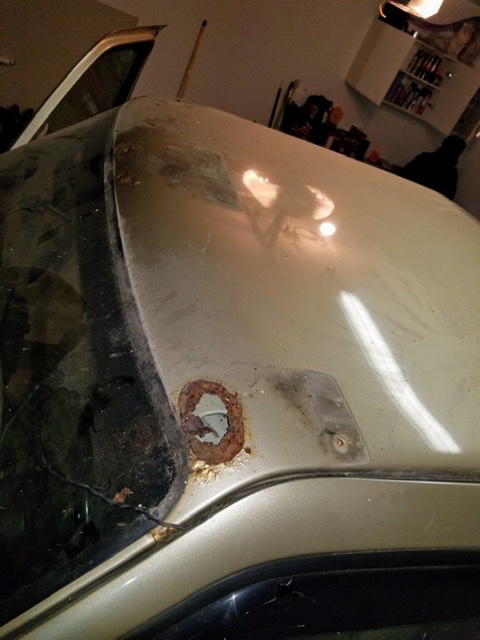

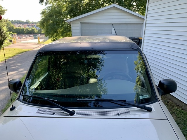

Totally agree, take a look at what the previous owner’s dog crap visor thing did to my 99. I ended up cutting as much of the cancer out as possible, plugged it with a huge body drain plug, then sprayed a portion of the roof with bed liner. Truck is my daily beater so doesn’t bother me.

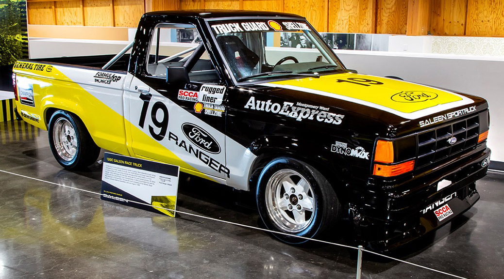

Got this response today from Kenny Brown Performance. I left names out...
Unfortunately, Kenny did not build this Ranger. He built two Ranger race trucks for the Saleen race team and they were both 4-cyclinder. Interesting truck thou! Cheers!
@Jim Oaks You guys might find this interesting. Im looking for more information on those saleen race team rangers rn, I'm sure they are already on this site but I didnt get that far yet lol.
