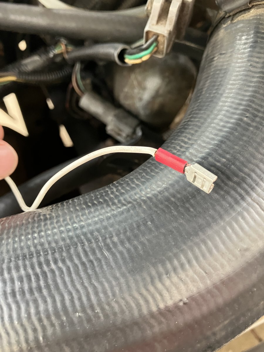

So i got the alternator, installed it, but I have a leftover white wire from my truck and I dont know what to do with it. It is in my original picture up top. Any ideas?
Mine doesn’t have a white wire. Does the truck run and the alternator charge?
No when I try and hook the battery up it starts sparking like crazy.
Assuming that you’re saying the battery terminals are sparking, remove the alternator wiring connector and make sure the white wire isn’t touching anything.
Try hooking up the battery again. If no sparking you may have gotten a bad alternator, parts are frequently bad right out of the box.
My first WAI alternator had a locked up rotor, I had to return it for a replacement.
IDK if applies here or not, but when I swapped the Explorer 130amp alternator onto my truck, I had a single wire connector that didn't go anywhere anymore. 10 years and counting...
^I thought I remembered that from another previous thread. I was going to tell him to tape it off if everything else worked.
