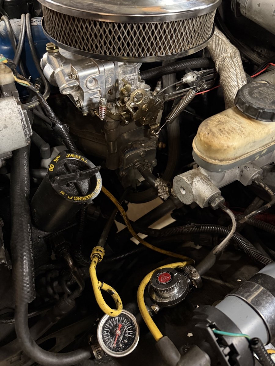

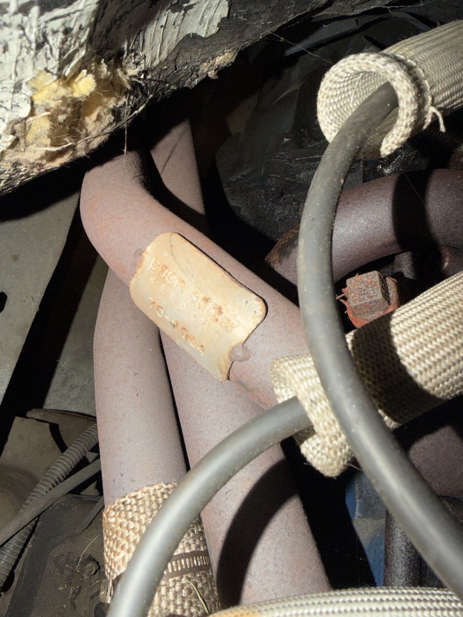

Just wanted to give an update. I ended up buying this truck. VIN matches for a 2.3, sticker under hood matches for 2.3 and it is definitely carbureted. I haven't seen anything yet to indicate it was swapped from EFI to carb.
Truck supposedly had a blown head gasket when he bought it, he put a new one in and it blew again so he sold it. Engine has pace setter headers, holley carb and the video of it running before the head gasket blew again sounded like it also might have a cam.

Is that a wire nut in the far back right corner of the engine bay? Also what is the gauge thing in the hose? 1st guess fuel pressure gauge and (adjustable?) regulator.
Since 86 is supposed to be the 1st year of fuel injection, I could see some early models still having a carb. I would've thought that would run afoul of EPA regulation even then though.
The wire nut is a hot wire. I'm not sure what it's for and neither was the guy I bought it from. And yes, gauge is for fuel pressure. In the 3rd picture you can see it has a manual fuel pressure regulator right before the gauge as well.
Definitely some non-factory things going on there.
I think carb was an option for a bit after fuel injection came in, especially in Canada, nothing is set in stone... heck the 2.0L was offered through '89 in Canada although I haven't seen any of those come through the site that I've paid attention to at least...
And on the headgasket keeping blowing, I would get the head surfaced, it's likely warped, unless it's cracked between the valves like they like to do... depends on if it's losing compression or just losing coolant...
