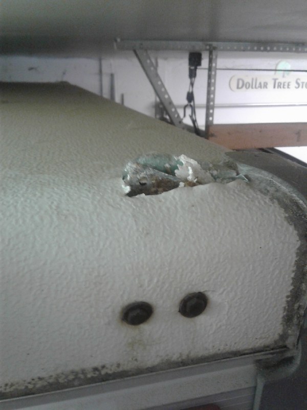

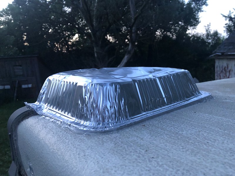

This is what I have going on (roof is up so you don't see as much of the bracket as you do when it is down)
This was my temporary solution to keep it dry until I got it inside. The whole roof needs resealed too, I goobered here and there with clear silicone where it was really bad, I didn't clean anything so it would be easier to remove when I actually resealed it.
